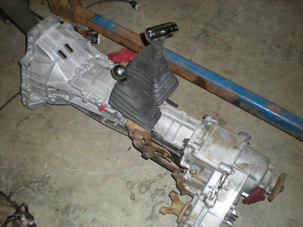

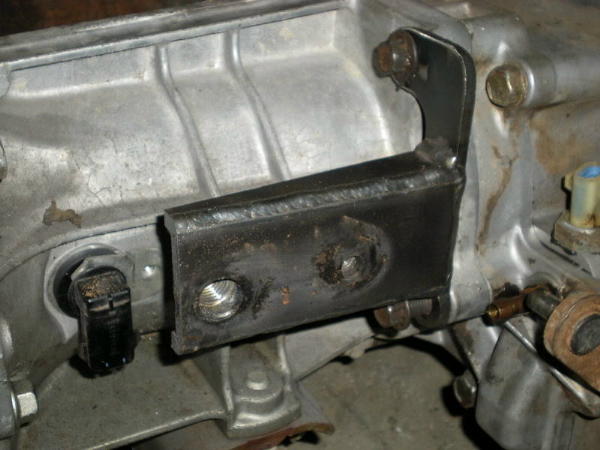

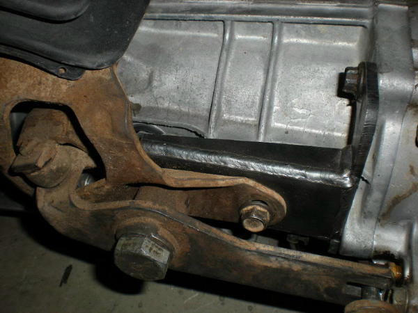

There is a work around for that:
As seen in this article:
http://www.therangerstation.com/Magazine/January2011/M5OD-R1HD_swap.shtml
That's a clever setup. I hadn't seen that before.
Same.
I remember Nathan's tranny swap, not the lever setup. Selective reading, I guess.
