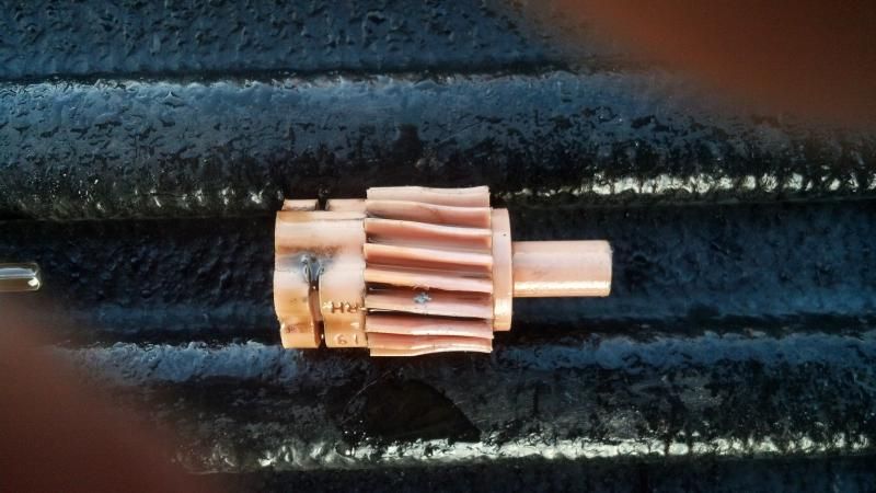

3 where would be a good place to get parts? (also needs 19 tooth pink gear on cable)

is this what it looks like?

could not get the 6 tooth gear had to get the seven

new worm gear is a 7 tooth and speedo drive is yellow 18 tooth ...how ever now speedo reads between 7 and 10 mph fast.. im thinking a 20 or 21 tooth speedo drive would put it right. what do you think?
tire height is 28.9"/9.3/15 (235/75/15) diff is 3.73
