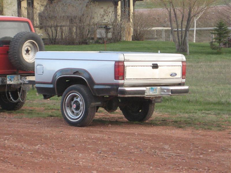

Used what was left of the 89 Ranger to make a off road trailer for the B2. Still need to paint to match the Bronco.

Howz the tongue connected? Looks higher than mine. I used the frame rails--notching them at the flanges and bending them in and welding up the notches.

Right ahead of the cabmounts I cut the frame off then used 3" x 3" box tubing for the tongue. I welded the tubing to the cross brace that runs between the front spring hangers and then notched the cross brace that runs between the rear cab mounts and welded it in. I braced it up with angle iron running back to the frame v'ed to the tongue. I wanted it to sit level hooked up to my bronco with lift and tow hitch that is built into the bumper.
