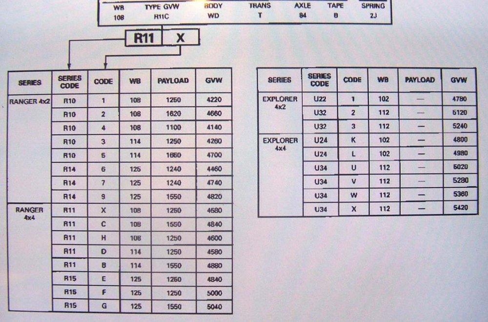

The weight rating varies due to tow package etc, my 4X/W tow package is Rated 1550/5040

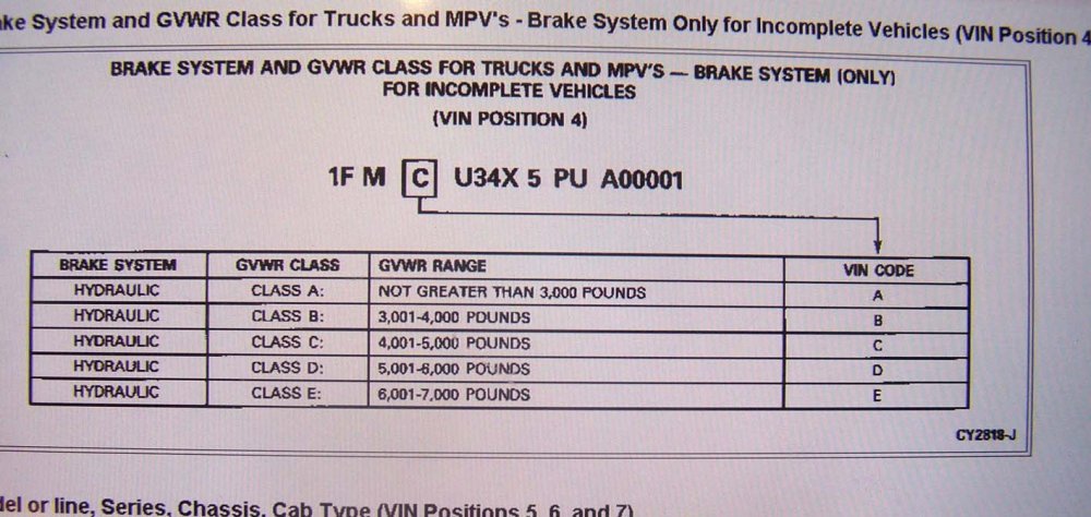

Here's some number codes for 93-94
The first is a number within the VIN
The second one uses a number from your door tag
