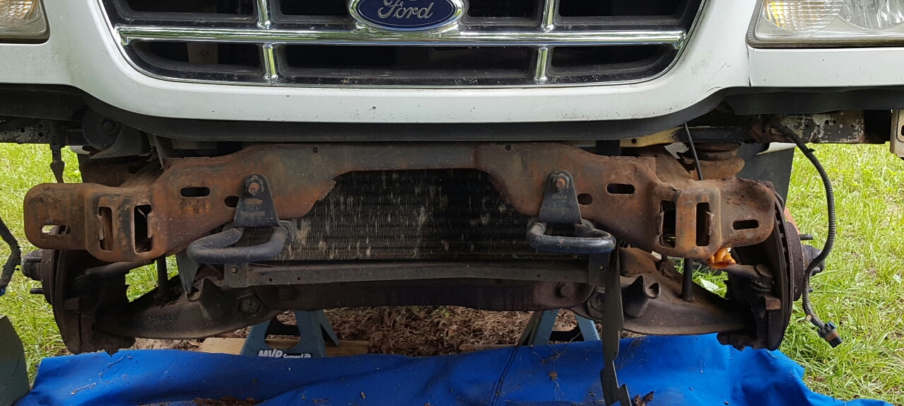

My '01 2wd Edge came with tow hooks on the front. There is a crossmember that connects the front frame rails and the hooks are bolted to that. I will try to post a pic.
Black hooks on the crossmember

the coil sprung 4x2 trucks lack that crossmember.
