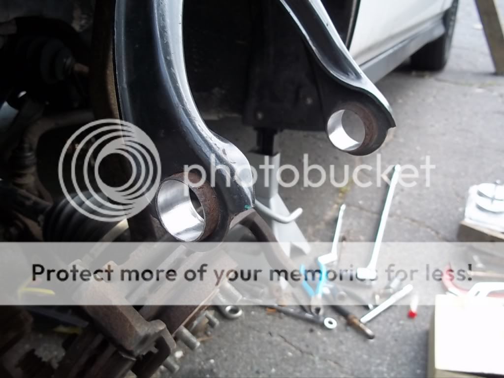

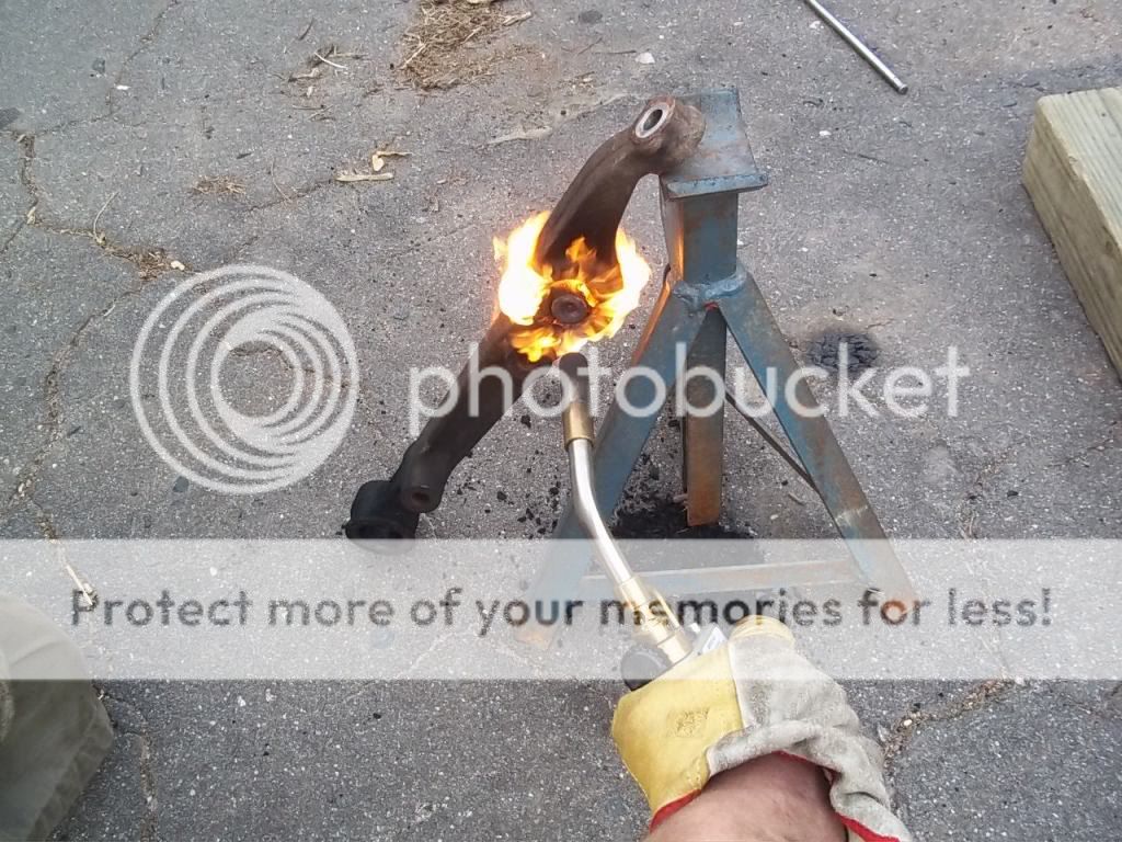

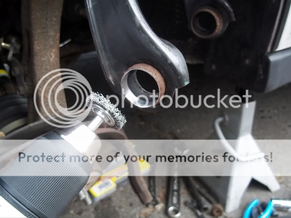

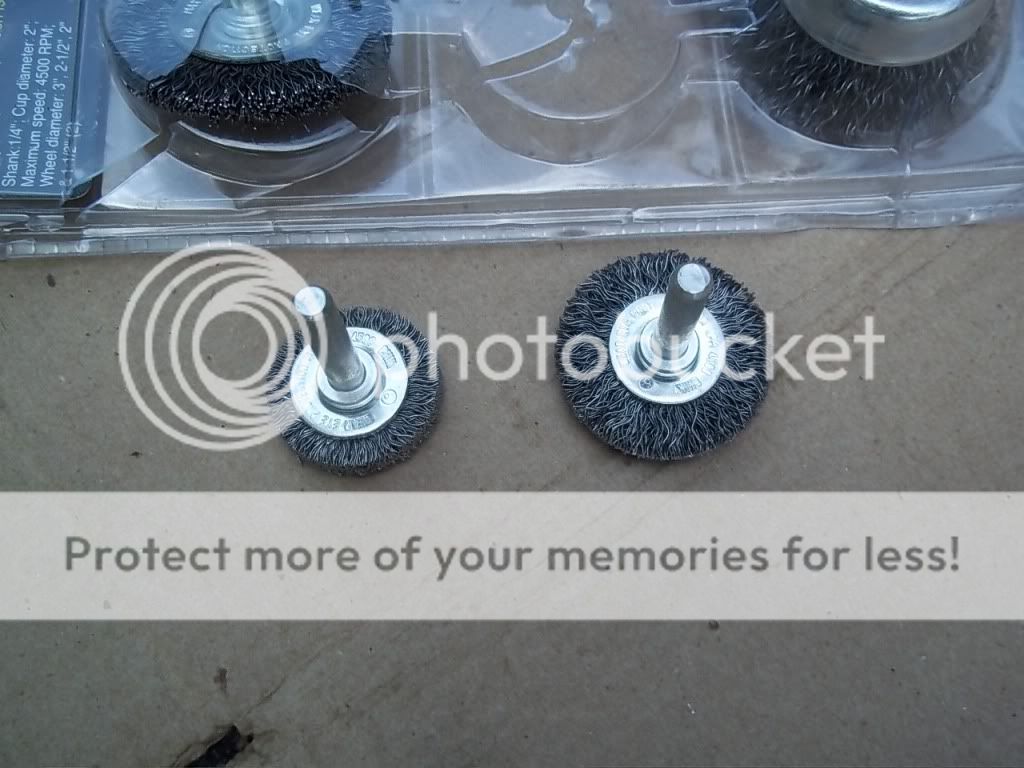

Radius arm bushings are removed and installed easily by hand. Beam pivot bushings must be burned, pressed, or cut out, depending on tools available and how patient you are. I usually burn out old rubber bushings and use a drill motor with a wire brush to finish cleaning the rubber out. The wire brush has to be almost exactly the right size to go through and get all the old rubber. I use calipers to measure the id of the steel and use a bench grinder to reduce the size of the wire brush to about .02 to .03 inch bigger than the hole it must pass through. If you don't have a bench grinder the sidewalk works, just takes a little longer. I don't have any pictures from my truck, but here are a couple from a Civic I worked on (same concept I guess).
Original and reduced size wire brush:
Bushing partly done:
Ready for new bushings:
And of course:
