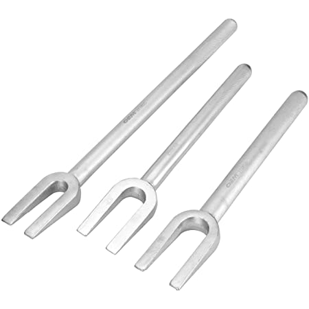

Yea, you should have a good pickle fork some big pry bars, and a big hammer handy...
Didn't XLT models have coils and Edge models plus 2001+ have torsion bars? Something like that....?
You must have selected something wrong on Rockauto because I just looked up a 99 3.0 Ranger and it lists ball joints and control arms for coil spring models. I seent it myself!
Dang it!!! Lol. I probably did. I'm new at all this
Pickle fork?
For separating the ball joints from the spindle/knuckle.
