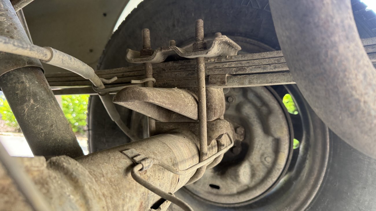

The back is easy - you take off the U-bolts, remove the lift block and reinstall (shorter) U-bolts. iirc, that block is about 3". When I did this, I put on 2wd rear shocks to avoid bottoming out the shocks.

Beyond removing the lift block in the rear, you have all the standard options open like shackle flip, axle flip and frame notch. My green 2000 I did an Explorer 8.8” as spring under axle with beefed up spring packs and an extended shackle. I still may have to make some sort of adjustment because it’s still about frame notch territory. I had to cut the spring perches off, clock the axle for the pinion angle and weld them back on. Also had to take about an inch and a half out of my driveshaft.
