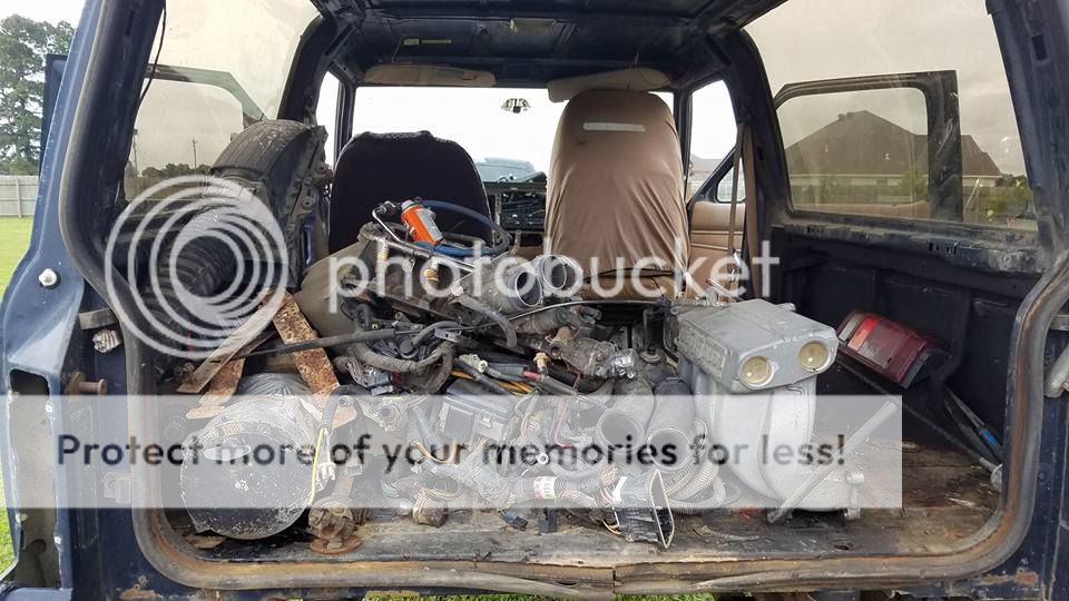

still stripping the f150 for parts to sell/keep. almost time for the rest to go to the scrapper.

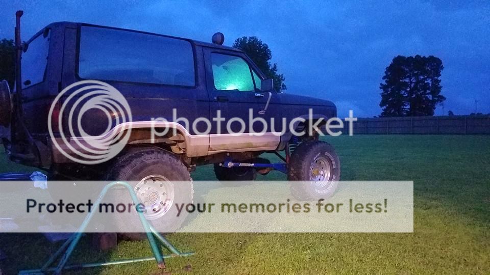

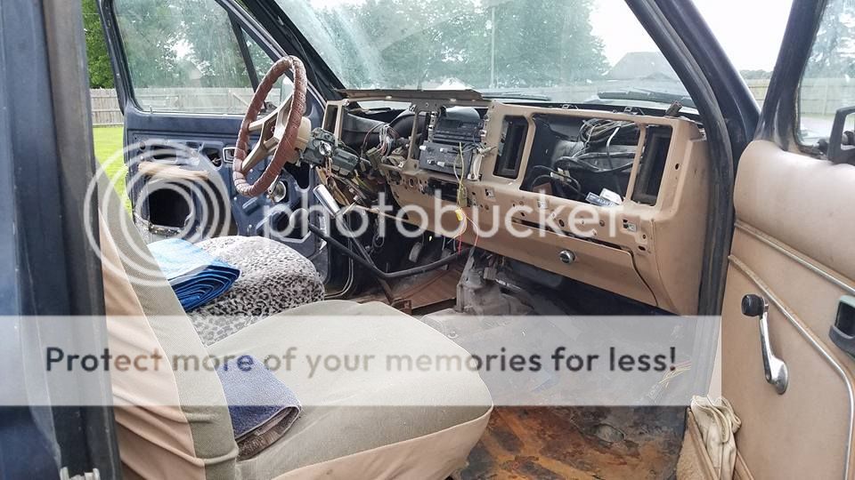

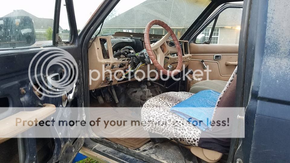

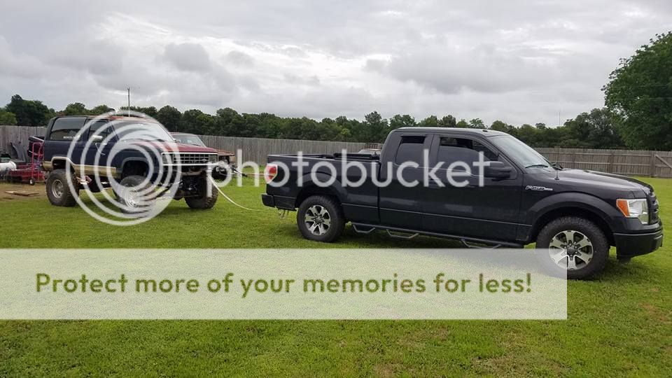

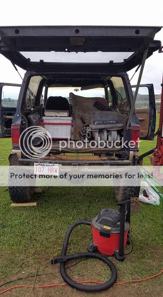

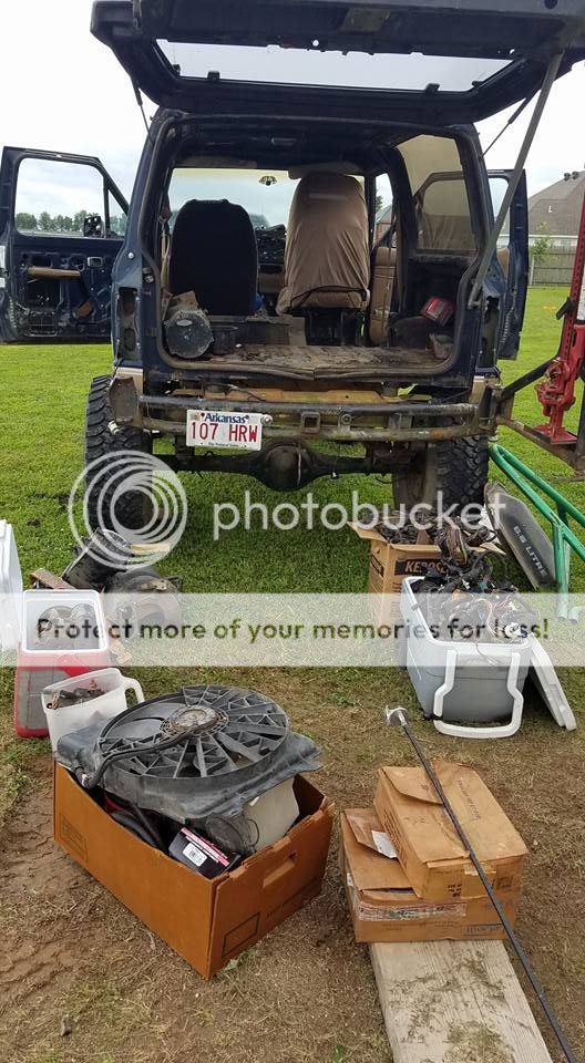

Dug the Bronco out of the weeds yesterday. Haven't worked on it in a few years, decided to at least clean it up a little. lots of time with the shop vac. forgot i don't have a functional transmission mount yet, so i had to get creative with some chain before i could pull it out.
