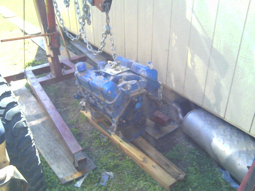

On the bronco i took the exhaust manifolds back of and bolted up my block off kit. going to bolt on the chains for the engine hoist soon.

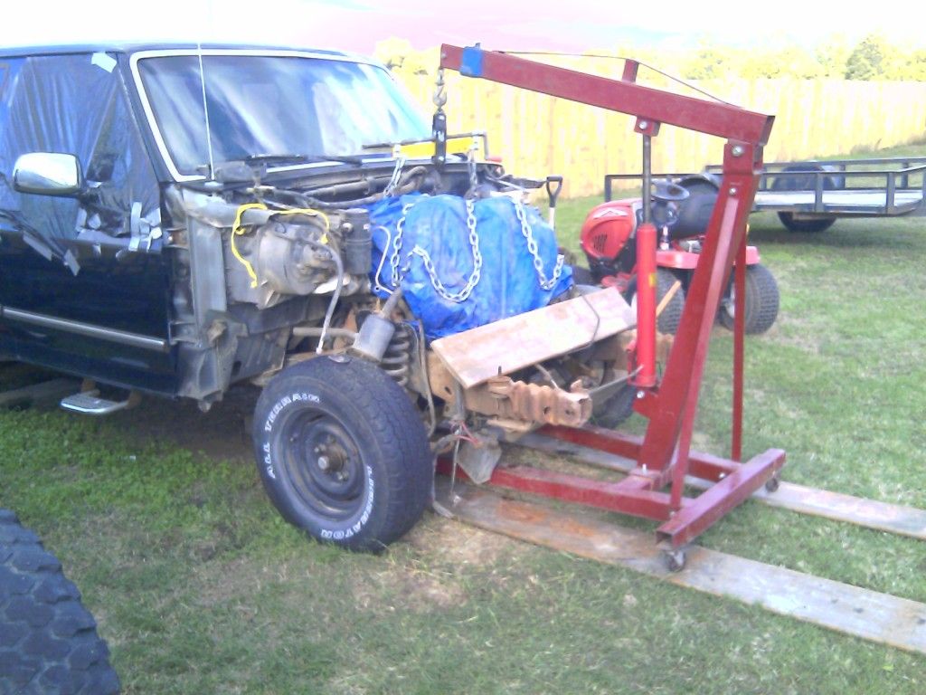

On the F150 I removed the radiator, shroud, and fan. also disconnected the power steering, trans, and a/c hoses, and cruise and throttle cables.

I am also thinking about chaining an engine hoist to the back of my trailer, and using that to pull the motors. should be interesting.

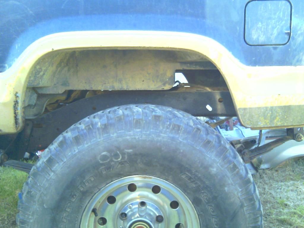

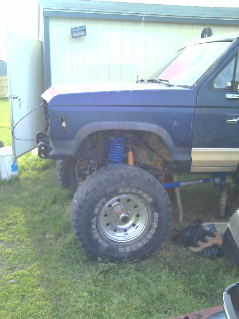

i'll have to do a little cutting to accommodate the wheelbase stretch, but that was expected

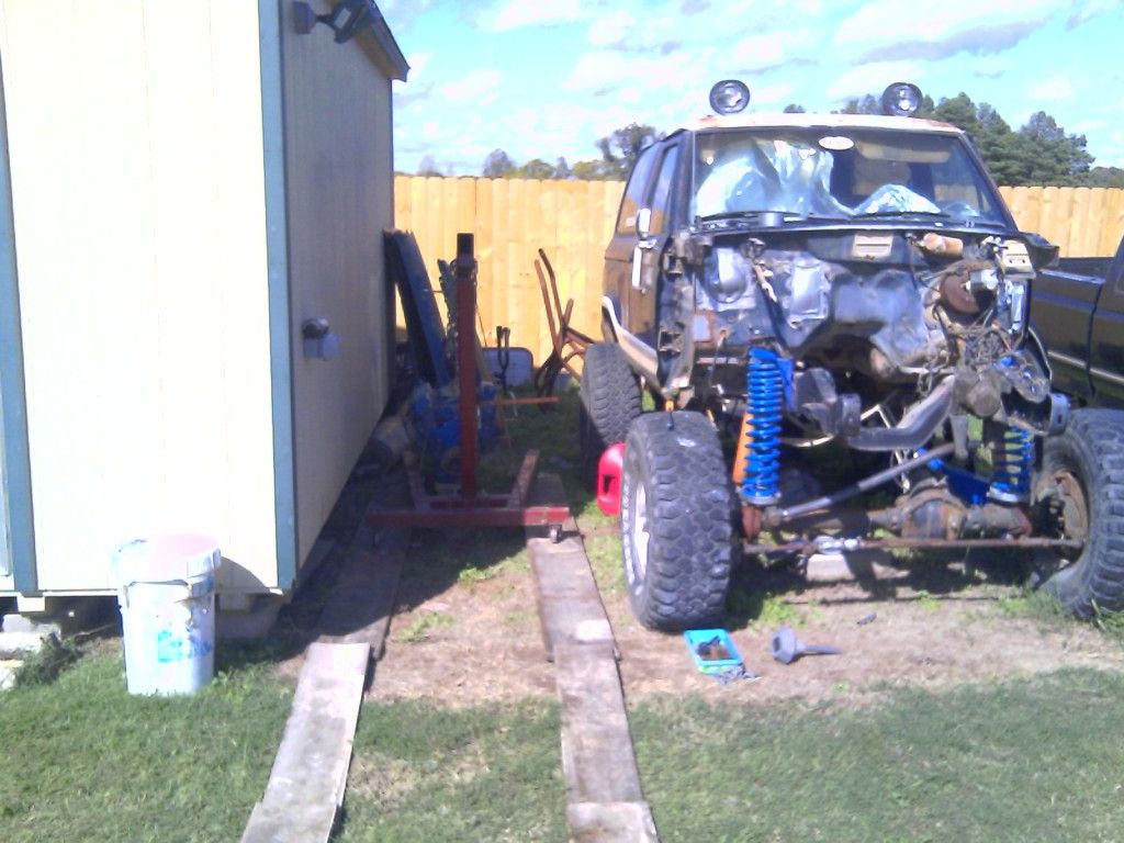

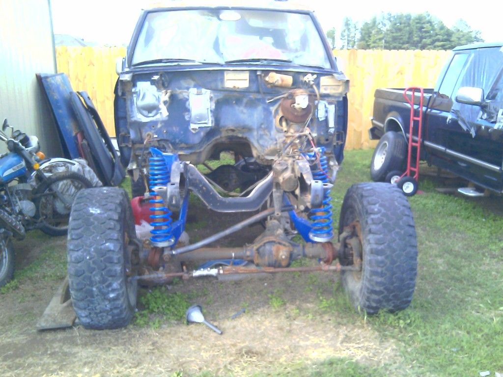

Did a little work last sunday

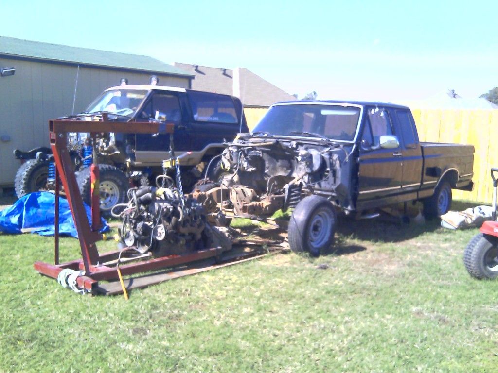

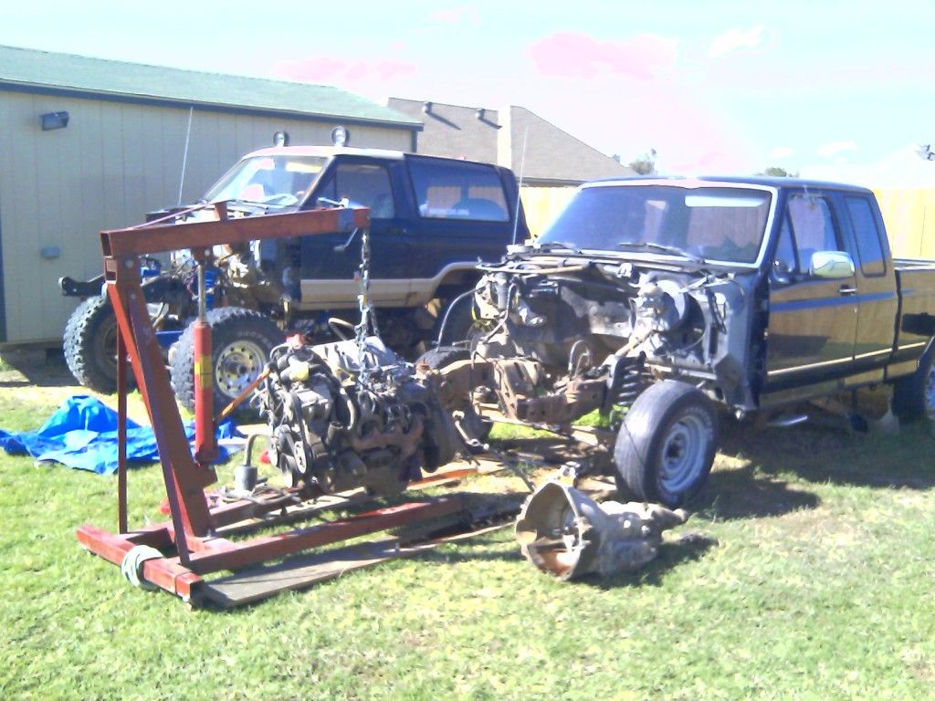

About to pull the motor from the F150

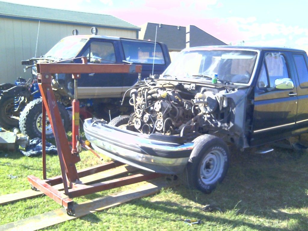

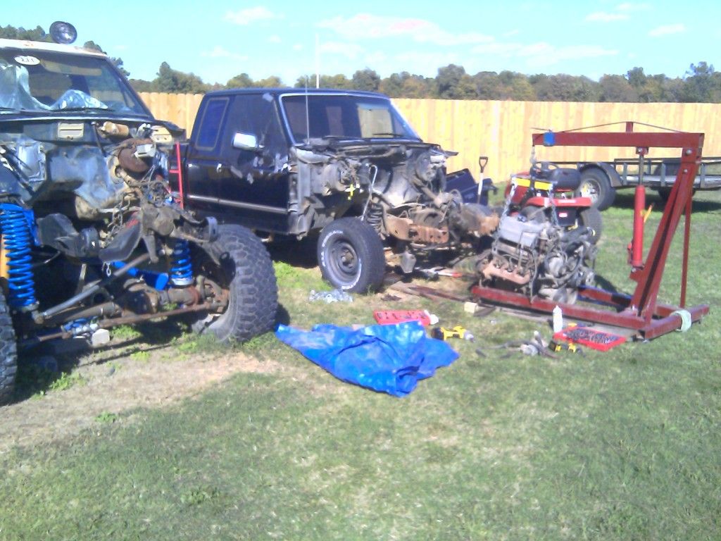

A little update, the F150 motor is in. Had to switch over to the old exhaust manifolds, but the oil pan clears.
Transmission is not in. Turns out the old style pressure plate does not line up with the 94 f150 flywheel. Need to do some research to see what i need to do next.
