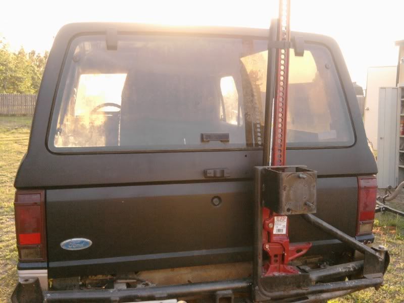

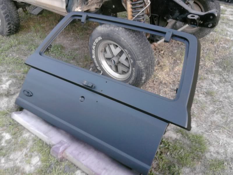

Been spending most of my wrench time on the parts rig and the brown BII, time to work on the ‘84 a little more. Took the rear hatch off of the gray parts rig (it has opening rear glass). Took the glass and weatherstripping out of it, gave it a light sand, and sprayed it with some satin black rattle can. I figure the whole rig will be rattle canned this color until I can get a decent paint job for it (nice paint comes last).
Old rear hatch
“New” rear hatch
The weather stripping for the window is dry and dirty, but crack-free. I’m going to scrub it in dish soap to get the funk off, then treat it with some Carmex (yeah, the lip balm). The brown BII also donated its (almost new) hatch struts, and it gets an older set instead.

didn't tinker very much today, but i did bolt the 'new" hatch on. still need to clean the funk off the window, but that's for another day

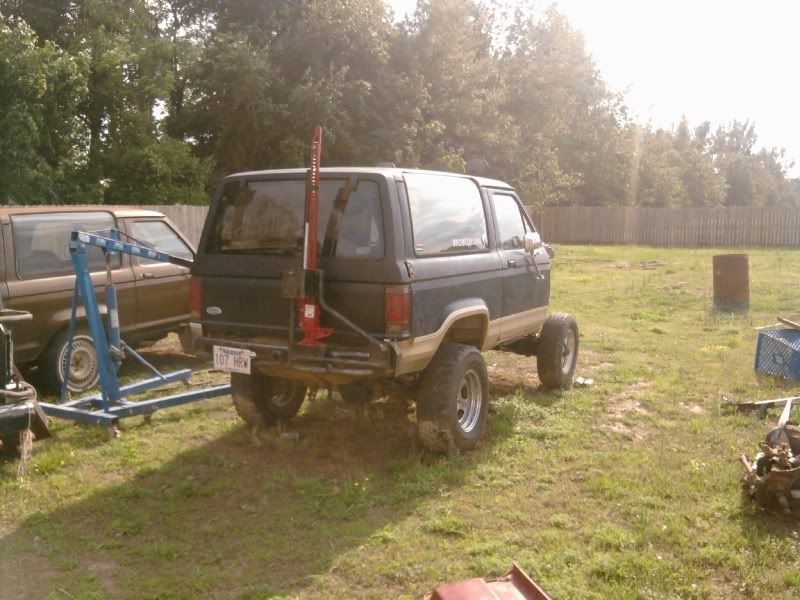

Got the Body lift installed today
Before:
After:
Hopefully that will help with clearances for the V8 swap.
