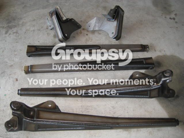

Here are a few things he has ordered. :D

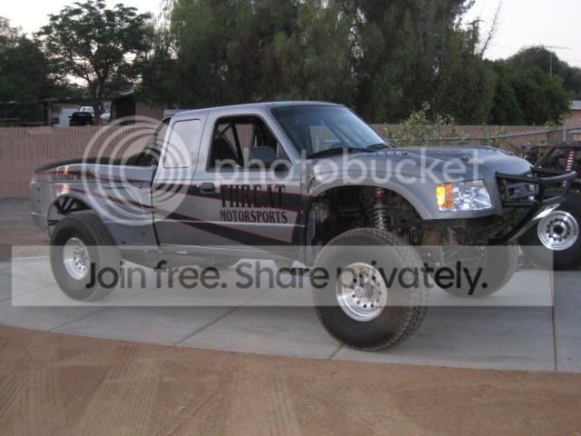

Here is what they look like on a truck.
