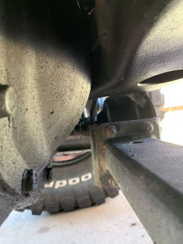

I am planning to tap mine when I drop it. I can't believe they didn't put a drain plug in or place it so you can get the cover off (finally got a pic below).
