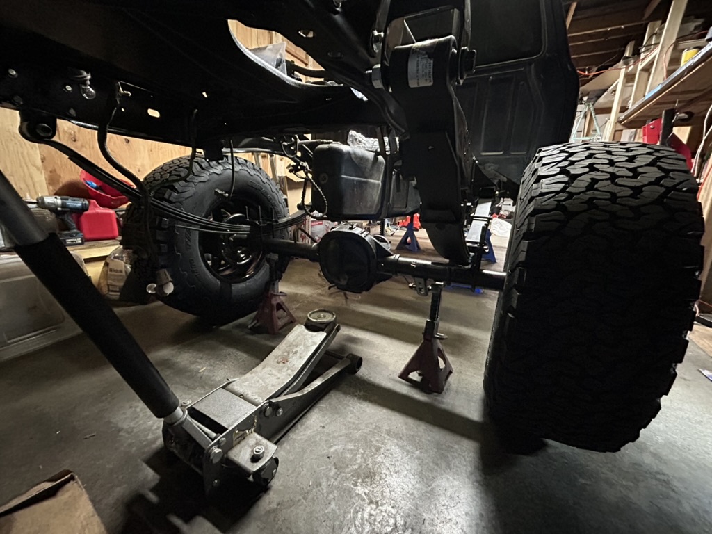

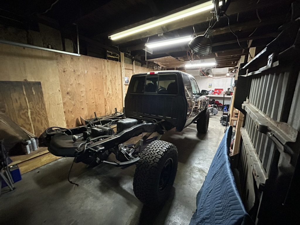

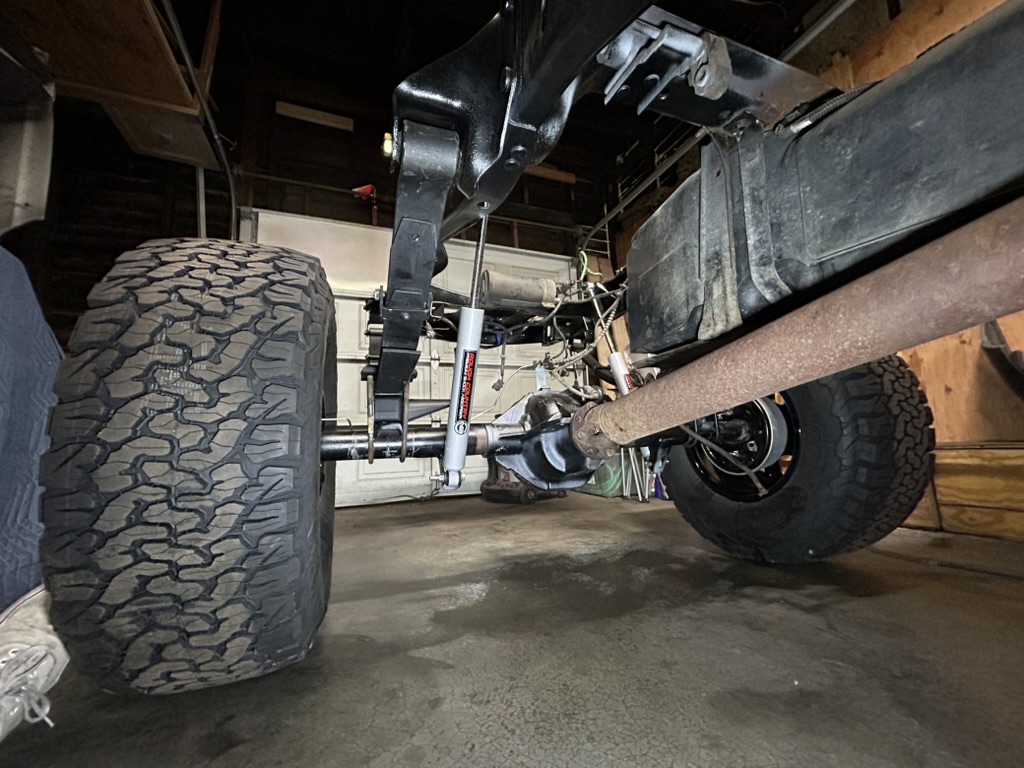

I'm wiped from all the work I've been putting on this thing but I am learning so many new skills. I got the rear tires on today and it was such a morale booster to see the back end sit under its own weight again.
The one thing I keep telling everyone who asks me about it is, I'm gonna get it all back together - but it might explode when I go to start it :icon_rofl: we shall see!!!

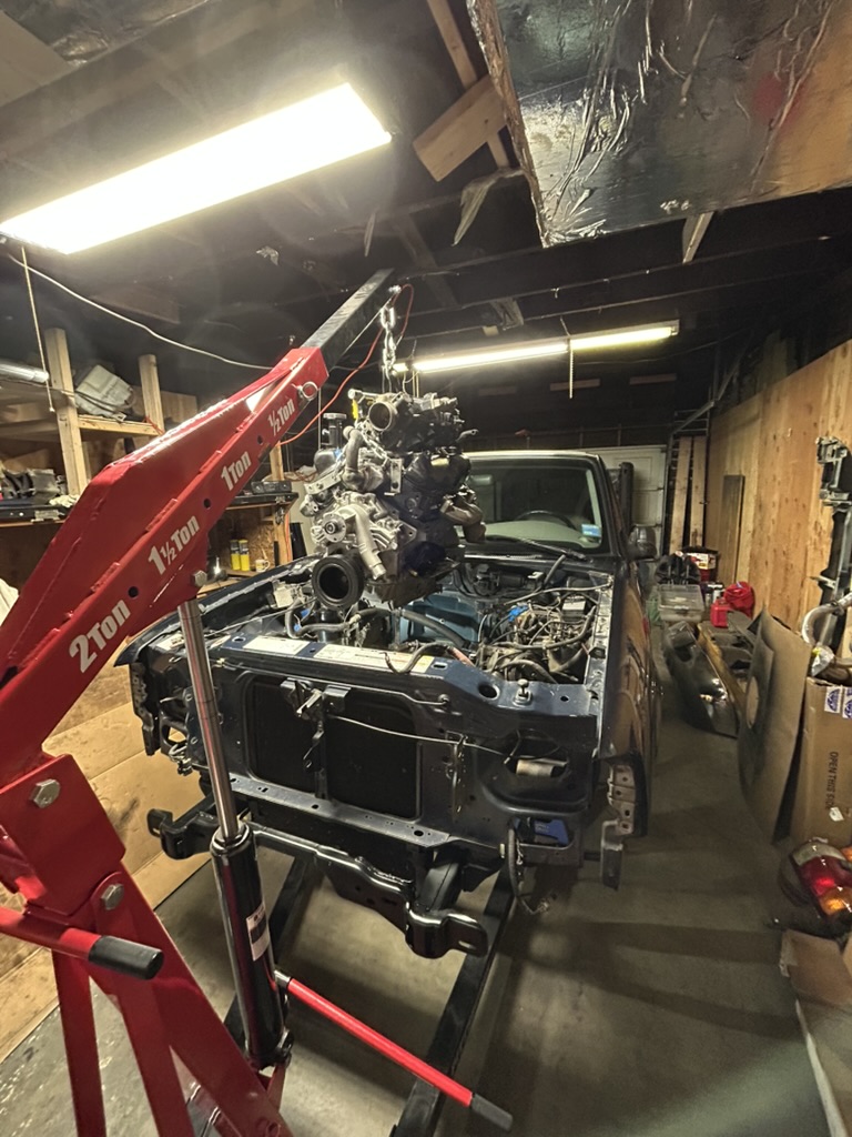

Now it's just so many details. I realized that I am an idiot (but I also checked the factory service manual multiple times and saw nothing) because I didn't install the dipstick tube and dipstick. I went to try and get it in but it's at an awkward angle. Got underneath the truck and realized that my oil pan is covering the hole in the block anyways. I'm kind of pissed because I think with how crowded it is with brake lines, the exhaust manifold, steering column, wires etc. I might as well pull the motor, get it back on a stand, and flip it to be able to move the oil pan around to clearance the dipstick tube. Pretty annoying but hey, first time engine building things I guess. Just trying to remind myself to have patience and go slow and don't get pissed the f*** off, haha.
Anyways! That's all for now. Thanks for following along. I'm having fun keeping this log.
How does the oil pan cover the dipstick hole? That's a new one..
Am I looking in the wrong area? I'm not seeing anything about it in the factory manual for engine assembly... I'll flip through more pages and do some more research online. Cursing myself that I didn't take a few more detailed photos of the motor before I pulled it all apart...
Update - did some more googling and read that it hides behind the motor mount plate. Pulled the motor and put the tube in... kind of frustrating that I needed to pull the engine again after getting it in, but it wasn't that hard to pull back out (I left the wiring harness on and just disconnected it from the firewall) and I'm glad I did anyways because I also forgot to put the engine backing plate on.
Thought at first that wouldn't be such a big deal, but then thought about it and realized that if that 1/16th or whatever of material wasn't there, it could mess up spacing with the starter, clutch, etc. so figure it's best to put it on.
That plate makes sure that the starter is in the correct position to engage the flexplate or flywheel. Without it I think you would have a terrible time starting the vehicle.

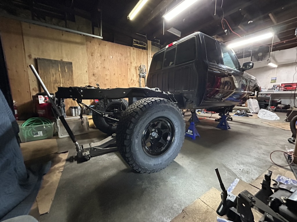

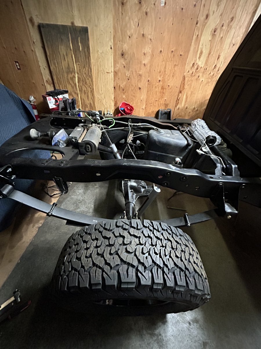

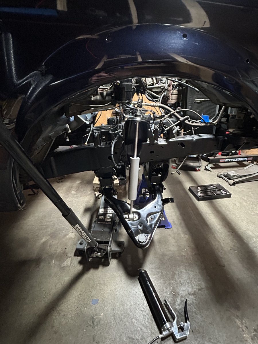

Rear end under its own weight!

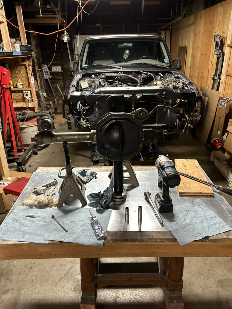

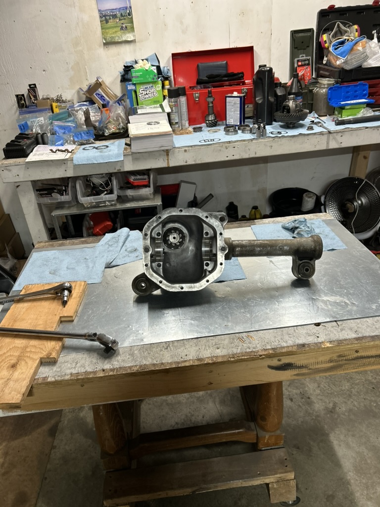

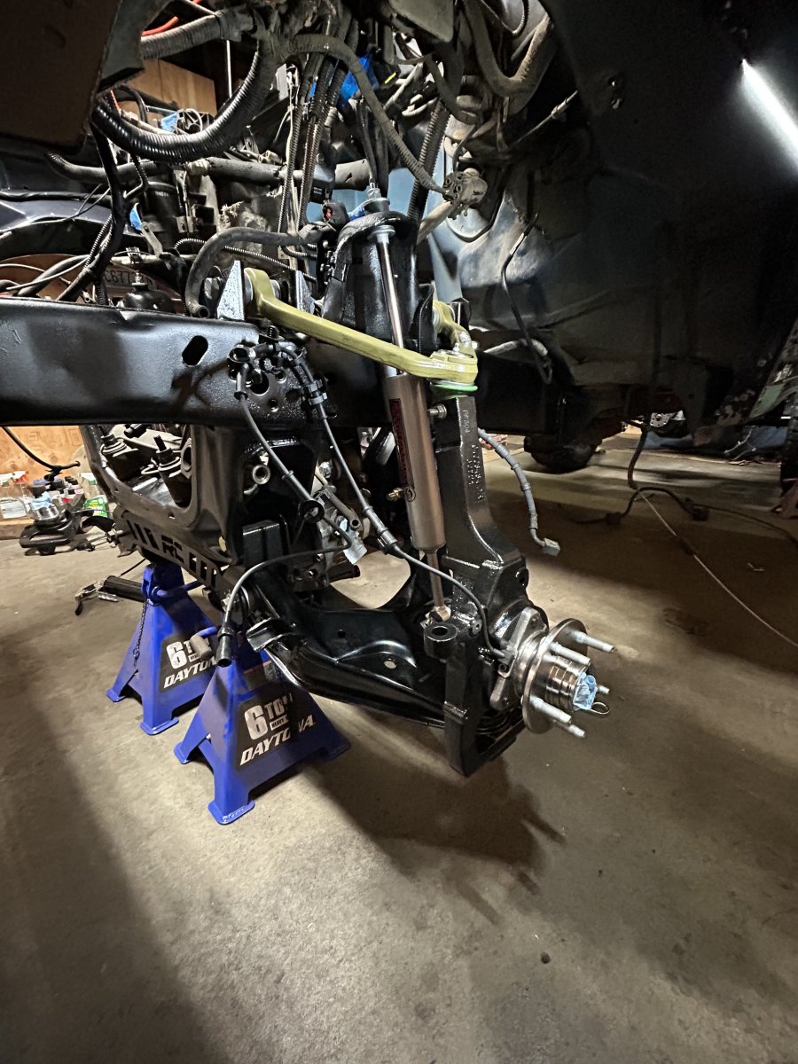

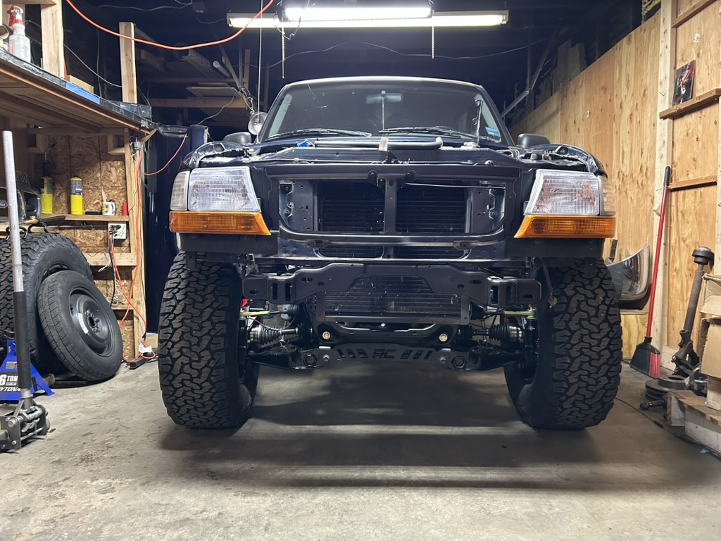

Front end getting close! Steering rack and front differential in.

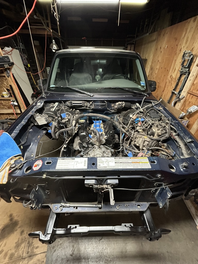

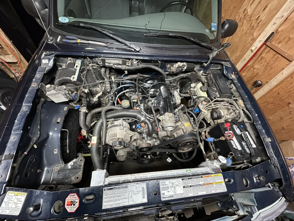

- Engine almost all the way buttoned up. Electrical, water plumbing, vacuum lines all coming along

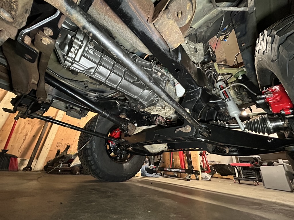

- Drivetrain completely in this weekend. Getting the transmission mounted again took the longest. Had to shake it a ton, but it seated. Got the t-case and drive shafts back on and started to realize: holy shit, I'm going to finish this truck!
Now it's all just details - getting last pieces hooked back up, tying up loose ends, etc.

IT LIVES!!! Fired up last week. I don't have any of the O2 sensors connected lol and I don't think I got the vacuum lines reconnected exactly right (if anyone has any photos they can share of their OHV 4.0's vacuum connections, I'd appreciate it. I think I'm too dumb to understand the diagrams offered here on TRS and I'm not sure I'm getting it right... anyways...) but I got them good enough.
Primed the oil system, saw that I was building some pressure, put some gas in the tank, fluid in the trans, etc., and said f*** it and went for it.
It actually fired up pretty easily. Idles just below 1K RPM. Let it run for a few minutes and checked for leaks and so far so good!
I'm so happy! Still lots of work to do, but I have a running truck!!! My wife says her goal is for us to take it camping the 4th of July weekend... so... gotta keep cranking til then.

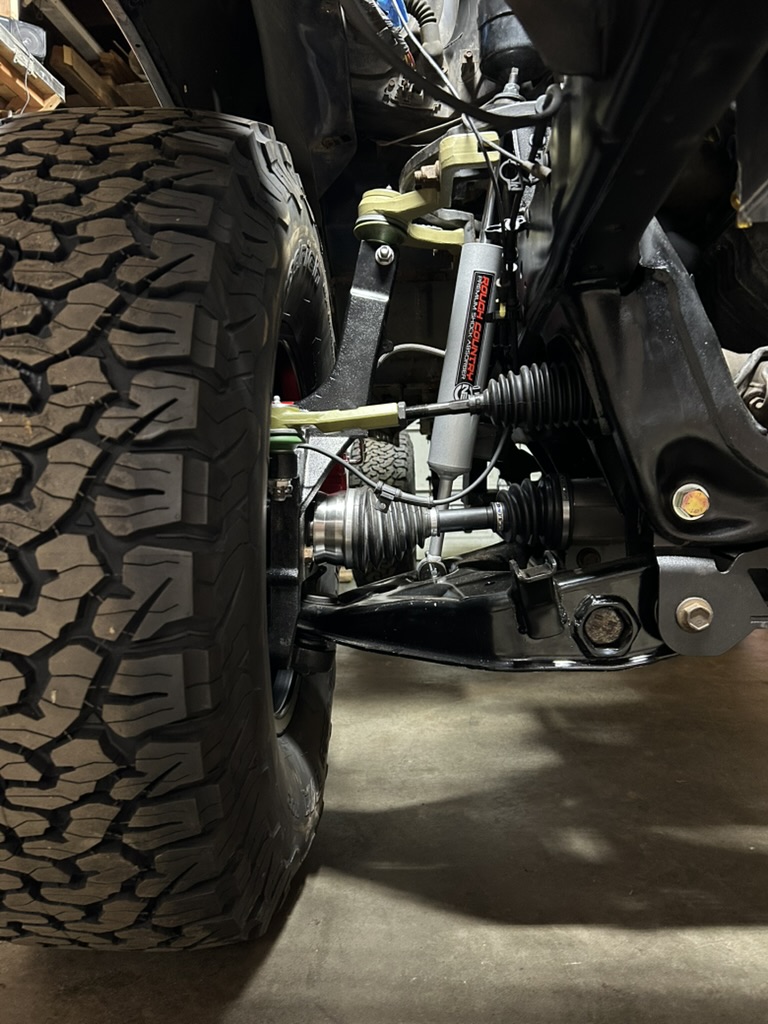

It's running and rolling!
tmr416's '99 XLT 4.0L 4x4 Build
I'm going to take the factory lift blocks out of the rear so that the rake isn't as intense. But overall, I am so happy with the way this thing looks.
