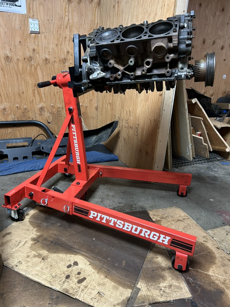

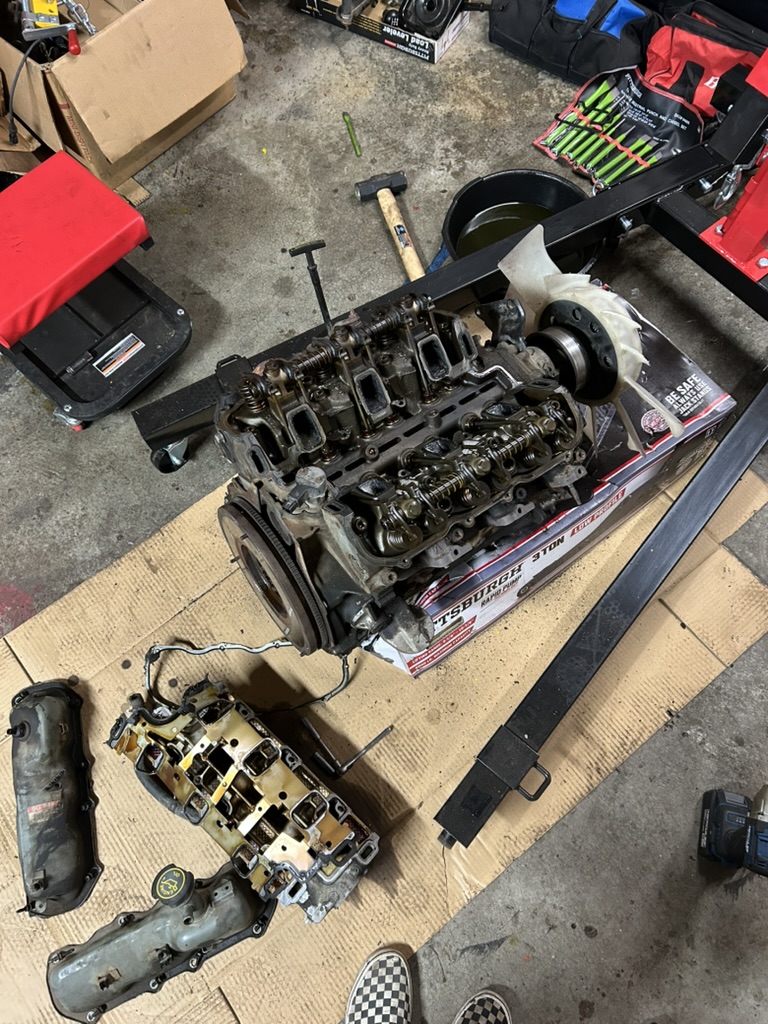

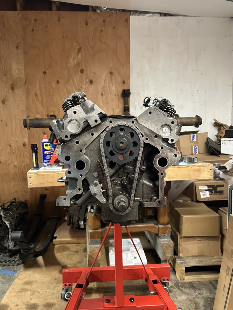

Continued with engine teardown this weekend. Got it stripped down to a short block now: everything off, heads, oil pan etc. etc.
tmr416's '99 XLT 4.0L 4x4 Build

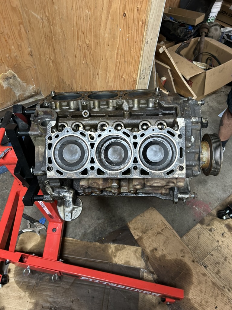

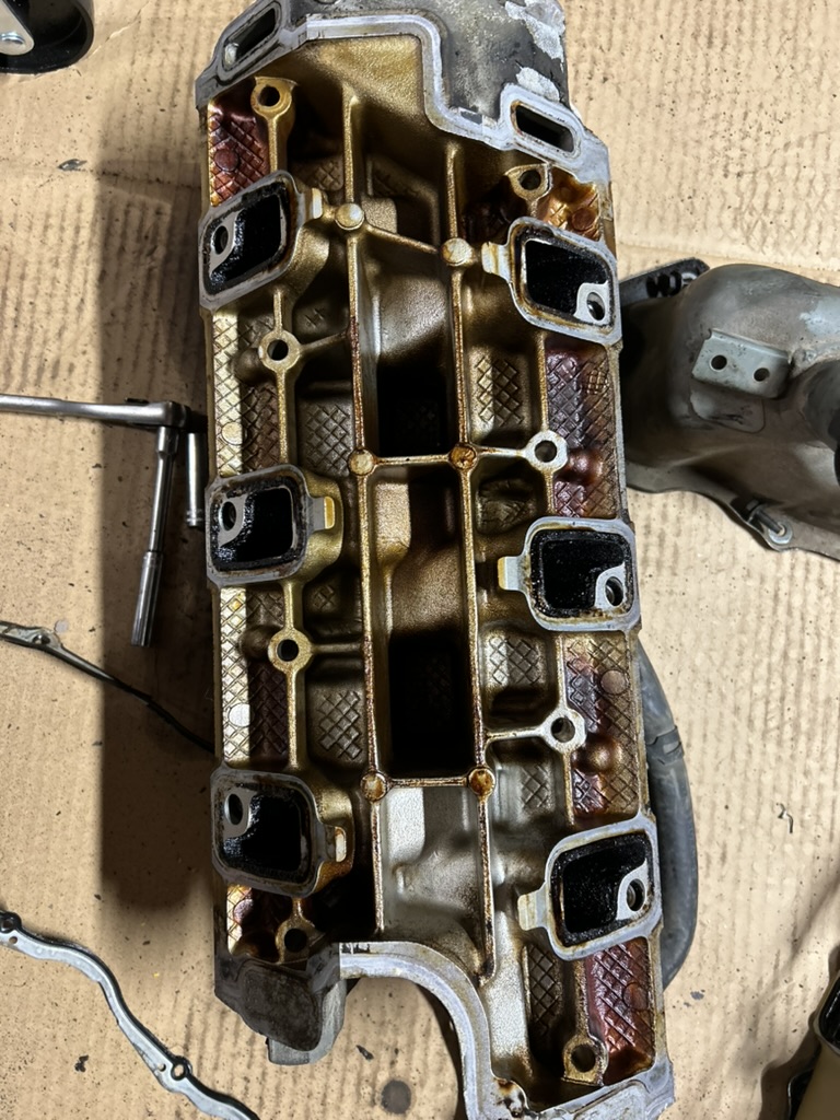

The motor looks... okay? It's really dirty. Inside's got some varnishing cus it was running lean. Still way too dirty to tell about cracks etc. but by and large, it all looks fine. Just looks like a 245,000 motor!
Gonna call the machine shop this week and see about getting it in there for rebuild.
Next up is dropping the rear axle. Then, it's feeling like we're taking steps toward cleaning this truck up, prepping for painting the frame and undercarriage and starting to collect parts to rebuild it! :headbang:

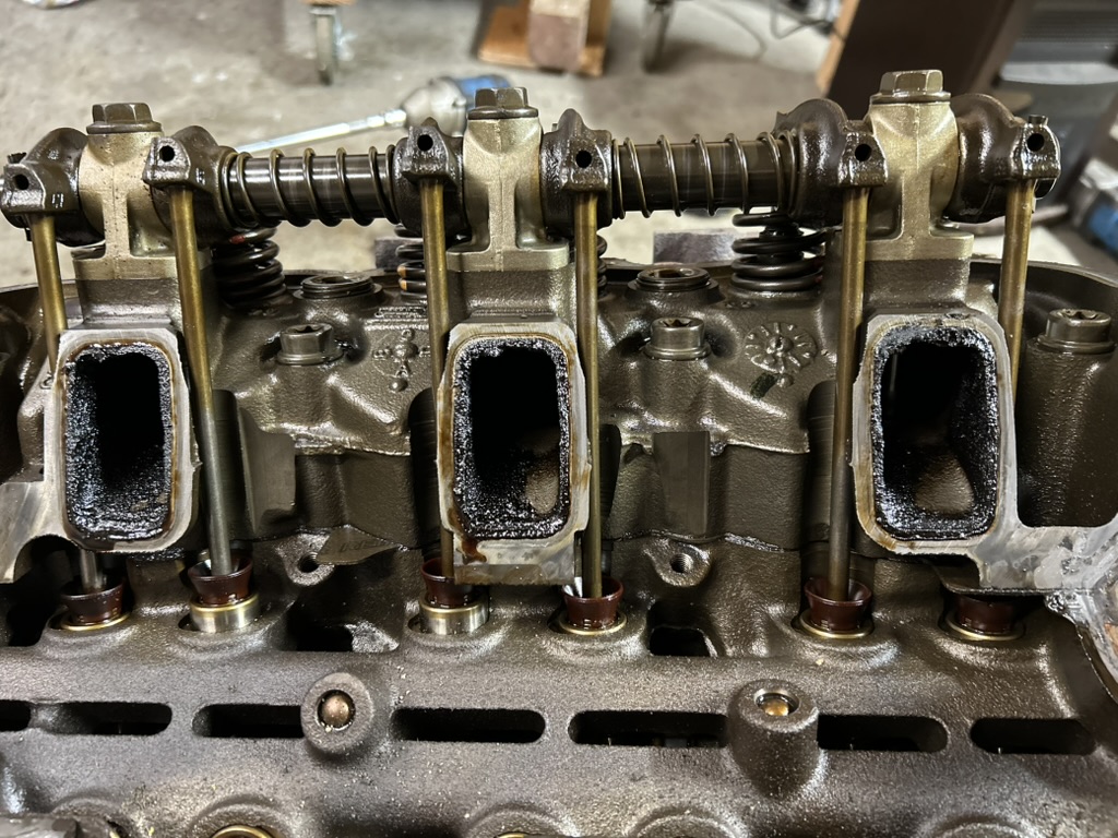

That actually looks pretty clean except for intake/exhaust ports. Crappy air filter and PCV valve with frequent oil changes?
Your guess is better than mine, lol. But thanks, yeah, I'm pleased with how it looks inside. No sludge. Just that buildup on the ports. Inside the oil pan and crank case looked good too.
I think I'll want to buy some better heads anyways just to protect from cracking in the future, especially if I'd be paying anyways to have these current ones rebuilt? Got any recommendations?
Plus, I' still not even sure the heads aren't cracked... no obvious cracking but they're still so dirty it's hard to see.
I'll take some more photos but the cross-hatching in the cylinders was still clear as day. So that seemed like a good sign to me.
I wasn't aware there are better heads for the 4.0. I thought was just the 2.9? I know the brand for 2.9 was world products. Apparently they were discontinued in 2011...
Doesn't get any better than that.

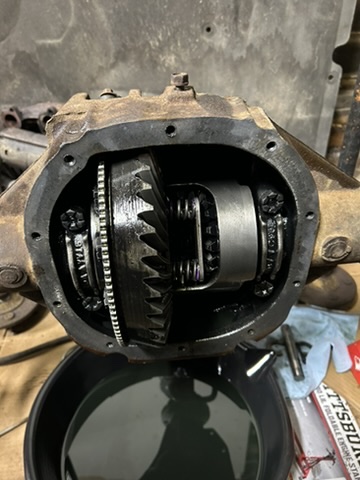

Today, I removed the rear axle, hauled it outside, washed it down then got it inside and removed the cover. Gears looked good and I also realized I think I have a limited slip. Will take some photos of it, but it jogged my memory that the guy I bought it from in 2018 told me that he'd put new gears in the diff, but he must have also said he put the L/S in, too. I guess I forgot.

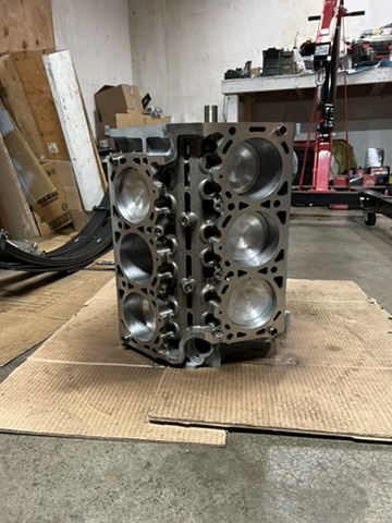

I have my appointment scheduled for the 19th to drop my short block and heads for cleaning, inspection and rebuild. I think I'm going to order the Clearwater Cylinder Heads.

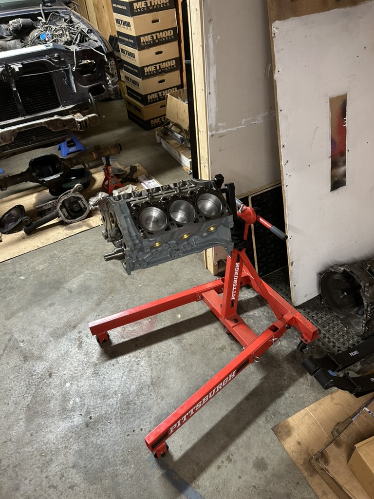

The short block is ready to go to the machine shop!

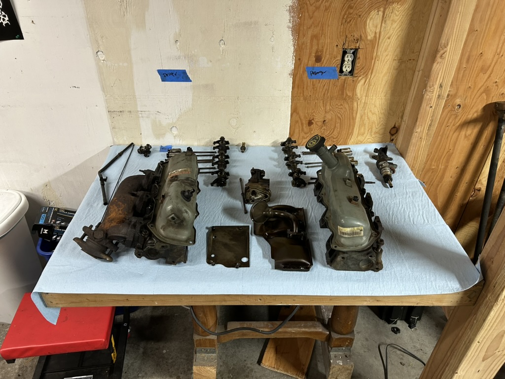

I've spent a bunch of time cleaning and organizing parts. Sold my old 33x10.5R15 KO2's to someone. Cleared a work table and got my top end all laid out and organized. Rearranged things in my shop so that it wasn't just corners full of piles of parts.

Limited slip

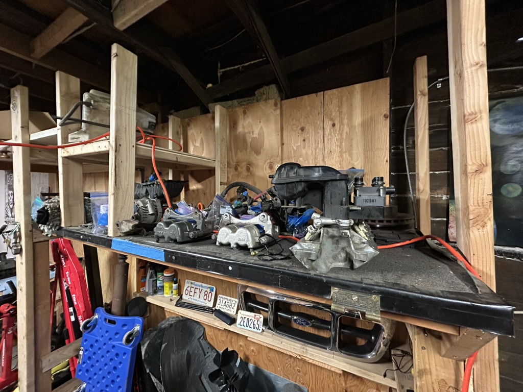

Parts parts parts

Top end table and axles

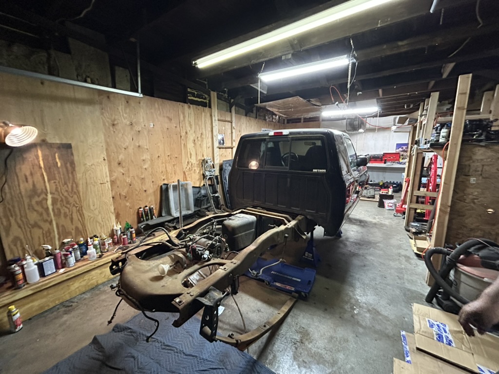

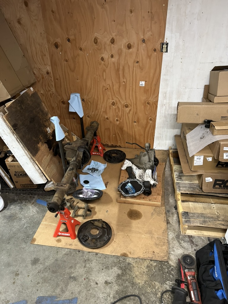

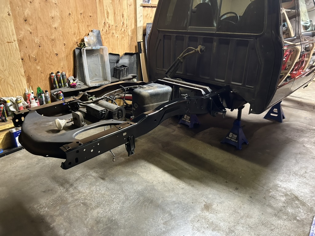

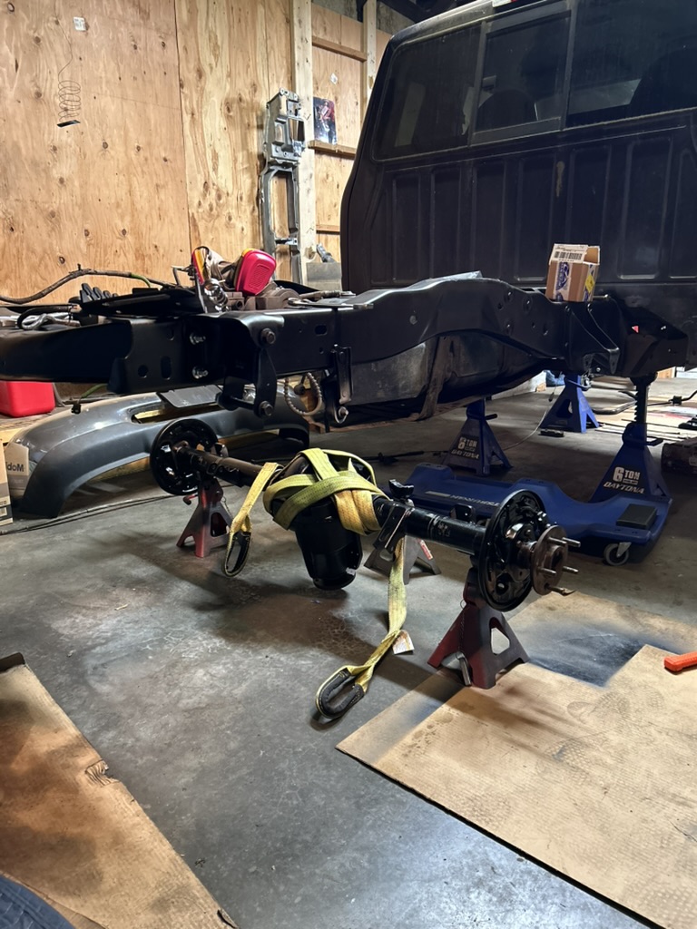

Finally got the rear end tore down, minus dropping the gas tank. Took the bed off and took a wire wheel to the frame and got it primed and painted.
Motor's still at the machine shop. Got the transmission and t case separated. Gears look okay inside the transmission. No obvious damage. So I'm not sure what the issue was. Unless it was a clutch issue. Think I'll take the trans to a shop to have it looked at.
Ordering parts. Goal is to get this thing to be a roller after the frame's all painted up. My hope is that seeing it start to take that shape will be a huge motivating factor.

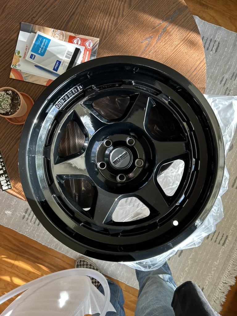

Oh, and my wheels came! I am an On X Offroad member so I get discounts with certain companies like Method so I got 5 wheels for the price of 4. They were pricey but they're the bead grips. I live in Washington and plan to do a bunch of snow wheeling and I'll be able to run super low pressures like 5 PSI and feel more confident I won't slip a bead.

Before prep and paint
After

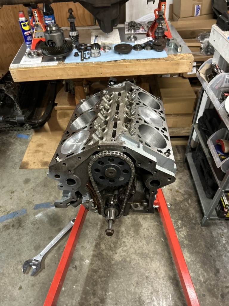

Short block came back from the machine shop. I ordered all the parts I need to reassemble the long block.

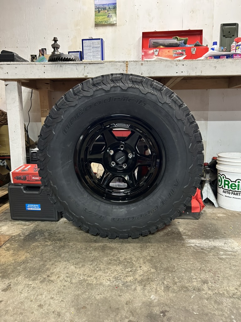

Ordered my tires. Ended up going 315/70R17 BFG KO2's cus they were significantly cheaper than new 35x12.5R17's

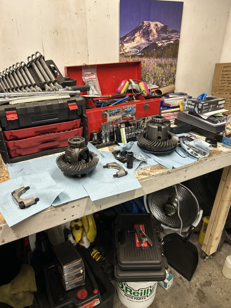

Ordered rings and pinions for both diffs and bought all the tools I need to do the regear job. Taking my time with it and trying to be meticulous since it's my first time doing gears. I've got everything disassembled, measured, etc. and ready to go for this weekend putting new races in and starting to set pinion depth etc. and get the diffs back together
Once I do that, I figure I'll reassemble the chassis to be a roller again, start working on reassembling the long block, and go from there

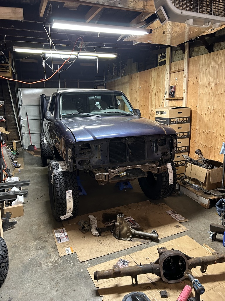

Making progress slowly but surely!
Working on reassembling my axles with new gears and putting the engine back together
Axles getting Yukon 4.56's
Ordered som BFG KO2 LT315/70R17's and got 'em mounted up to my wheels
Things coming together... just one step at a time...

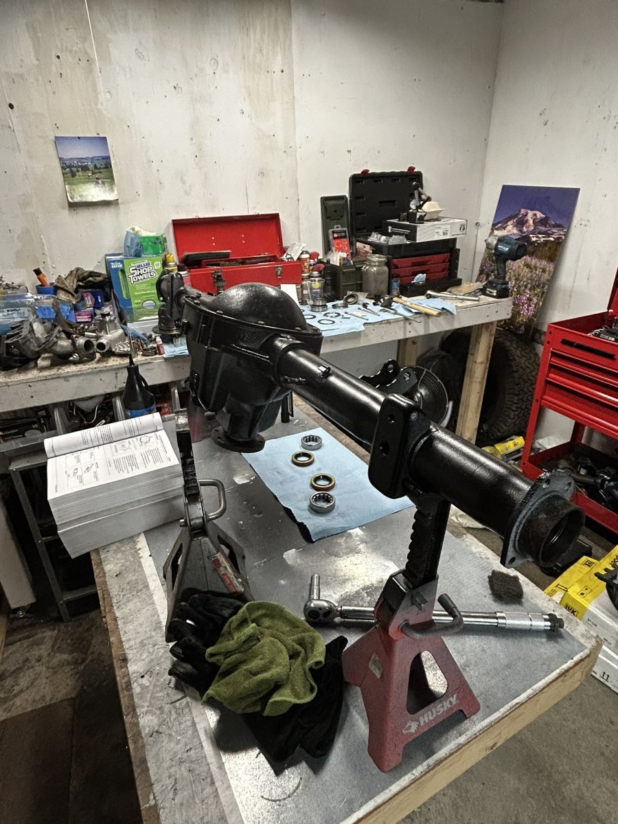

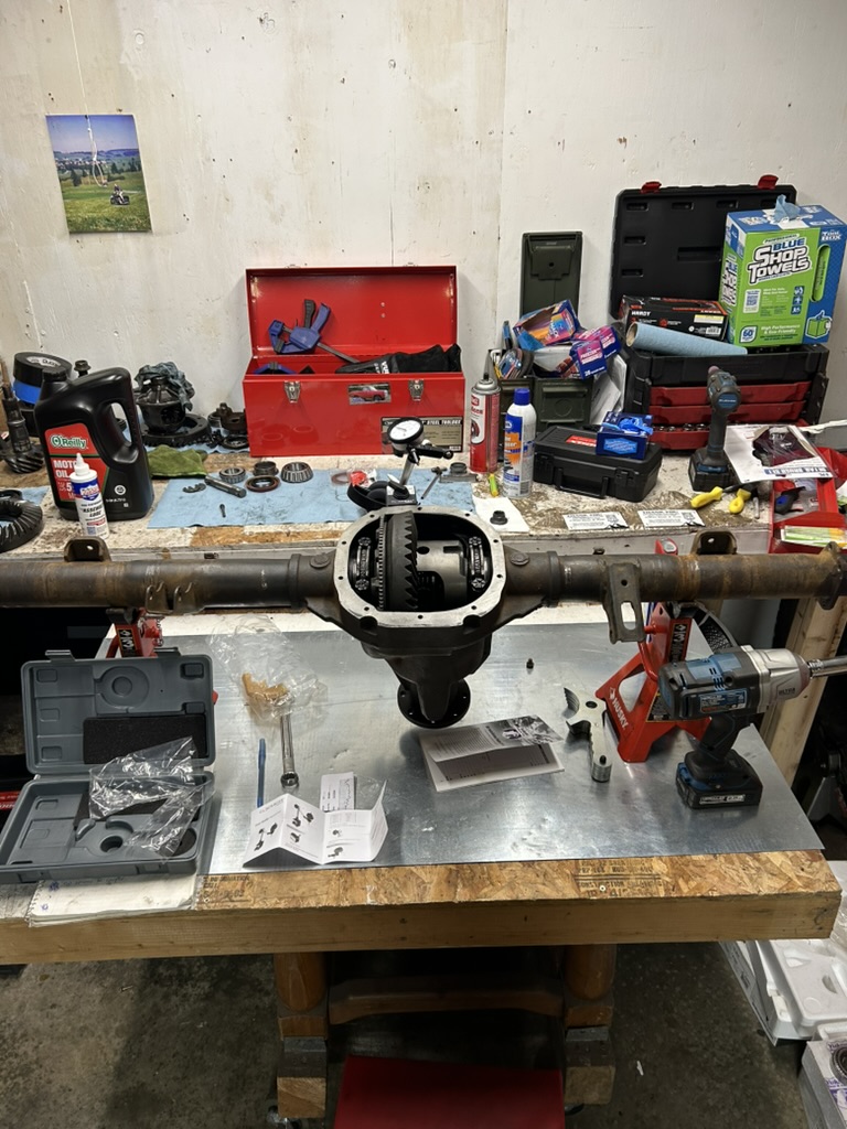

Alright, need some help. Doing the rear diff and pinion depth good, backlash good, pattern was good so I felt good to go for final assembly.
Pressed the pinion bearing on and then got ready to install the pinion. Problem is, the pinion is a slight press fit through the OUTER pinion bearing. I can't push it far enough into the axle housing, through the bearing, in order to get the pinion nut started.
Anyone got any tips? Any and all videos I watch about installing new diff gears just glosses over this step as if the pinion just goes in smoothly.
Brass punch? Or wooden block on the interior face of the pinion gear?

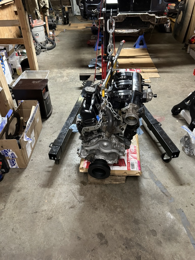

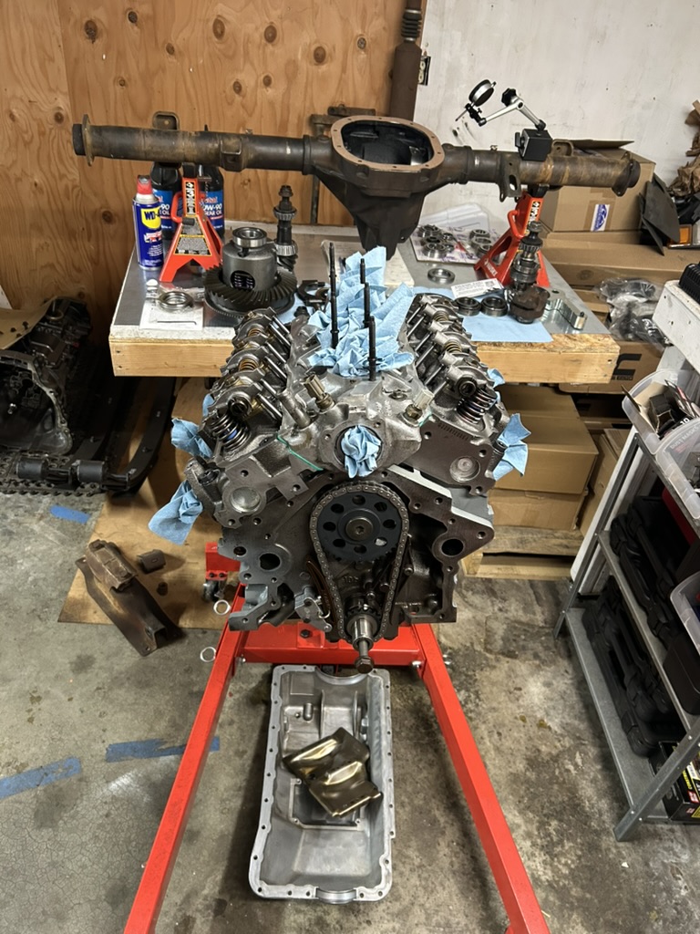

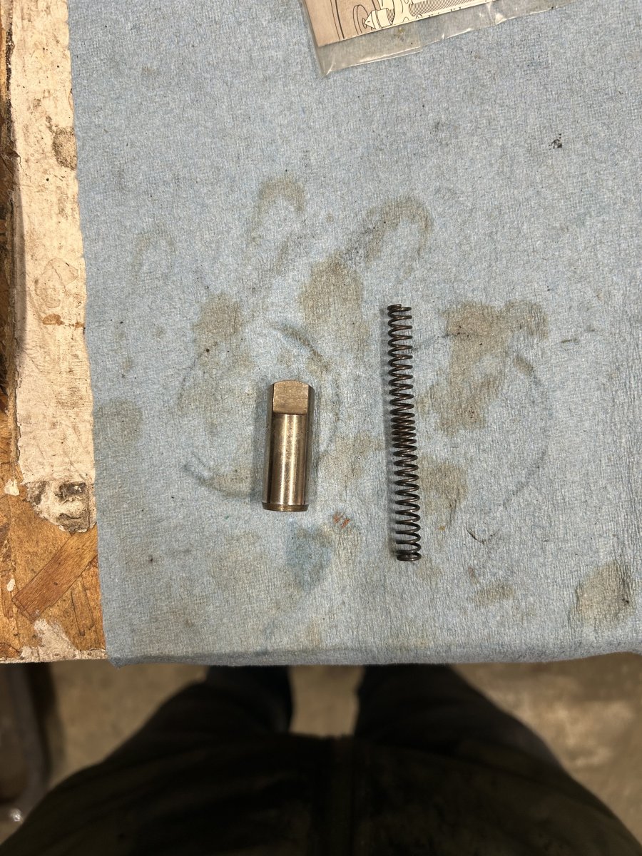

Hey everyone -- motor's almost all the way put back together. The only two things left in the parts box that came back with the short block after the machine shop stripped the last bits of it to clean and rebuild are these:
anyone got any idea? I've rebuilt the motor according to the factory manual and have it done all the way to upper intake and harmonic balancer -- pretty much ready to drop back in. I've double checked my work and can't think of what these might belong to that I missed? If anyone's got a guess I'd love the help!
I don't remember anything that looked like that in my engine. Somebody must've dropped something else in the tote.
Got the rear diff and axle rebuilt. Felt good about this gear pattern and didn't want to get too lost in the sauce going back and forth, back and forth with shims. Pinion depth was OK, preload OK, backlash checked out, got the pinion installed with new crush sleeve, dropped the carrier in and checked that pattern one more time and felt good sooo... I'm just going to send it!
Ready to get it lined up beneath the frame, suspension installed and brakes put on!
Also almost ready to put the flywheel & clutch on the motor and dropped back in to get accessories, vacuum lines, fuel and electrical all back on
Next up:
- Front diff
- Suspension
- New brake lines plumbed
- Get it rolling!!!
