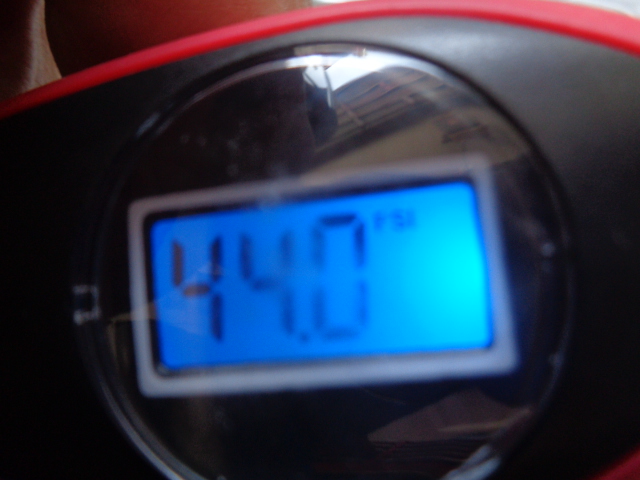

Another tire rotation today, with Oil/Filter change--9000 mile total--Tire rotation as per book, verified pressure at 44 PSI, with tread measurements across face of tires, measured in three places--New tread measurement was 15/32--current, after 9k of use, is over 14/32.
Wear is across entire tire face, even, and indicates correct pressure, for vehicle weight/tire construction.

Is this with LT tires? I know tires equipped from stock with LT tires is 38 psi.
BFG's-Original size, 8 ply rating--I wish I had gone with the 265/70R 17's, as the 1 1/2 inch taller tires, look really good in comparison to the fender openings--Just wasn't sure if they would fit/not rub--Will go with this size next. BFGoodrich All-Terrain T/A KO2
8 ply, I think that is load C. So LT tires. How is the ride with that pressure and how has the grip been on wet roads?
EDIT: I looked it up. 8 ply = load D.
Correct--I ran 10 ply's (load E), on the FX4 04 level two, so I may have spoiled my ability to rate "ride comfort"-The 04 was a "hard as a board", but when I parted with it at over 180,000 miles, it was still a sad day. Ride comfort on this new one, is soft/very comfortable, with great suspension response/shock control. Not much rain in our area, (haven't driven out more than 150 miles), but there are quite a few reviews on Tire Rack, with some mileages in excess of 70 thousand.
