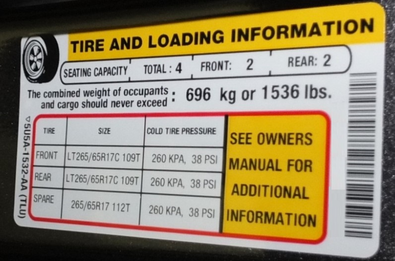

My 2019 Ranger came with LT (Light Truck) tires... LT 265-65R17C specifically. Door placard states 38 psi.

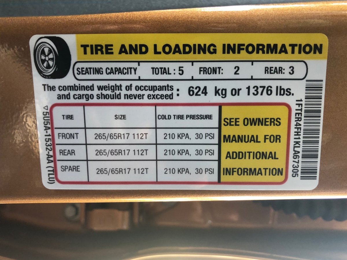

The same size tire, that's not a LT, is specified at 30 psi
