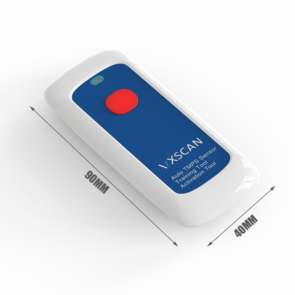

This is the tool that I use:

We do it on every tire rotation at work… so every PM service.
We use the TPMS training tool, not the “let air out” procedure.
