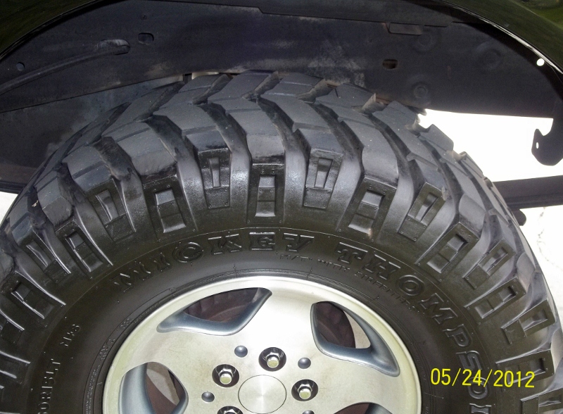

What is the best tire pressure for sand ?
Front, rear, 2X4, 4X4, and tire type/size should require a different psi, right?
33X12.5 Mickey Thompson Baja Claws on 15X7 rims 2 wheel drive slow to maybe 40mph is what Im runnin'-
5psi rear, 15-20psi front?
In your opinion whats gonna get me up some sand hills, my trucks 2 wheel drive and has an open diff at the moment unfortunately.
Would low pressure in the front slow me down? Should I just run 3 pounds all the way around and see what happens? Thanks and Cheers.

3 PSI and no beadlock. On rims that aren't beadlocks I wouldn't run much past 10-15 PSI per tire.
The guys that drag race on the beach here run directionals backwards. Hopefully that makes sense. They don't dig at all.
Sent from my DROID RAZR using Tapatalk 2
^^^ Makes sense to me.....the treads are pulling the sand into the tire path instead of pushing it apart/out.
