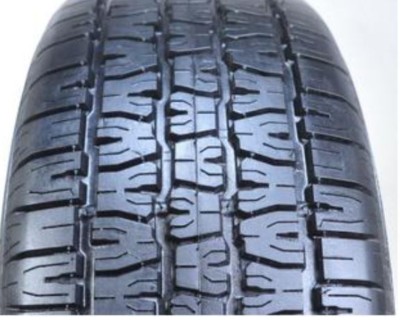

What they call symmetric, isn't. The grooves at the edges slant the same direction and the little tail that comes off them are in opposite directions. It will not be a mirror image. They are wrong. What they have is that it would be symmetric if they flipped half of it upside down. It would then also be directional.
You note that the directional tires are in fact symmetric, meaning, mirror images if you split it down the middle. A symmetric tire is by definition directional unless it is also longitudinally symmetric.
It's not that hard to design. Take what is your proposed tire face, and draw some angles and diamonds on it, slanting lines, whatever - you can easily do it, and have a non-directional but symmetric tire and one side of your truck will mirror the other and it doesn't matter how you mount it or its direction of rotation or which side it's on.

It's really not complicated. What you do is draw 1/4 of your tread pattern - make it as wacky or complicated as you want then mirror it to the other side, and mirror that lengthwise. Voila, symmetric non-directional pattern. I made a simple one just to show it's possible, but you could make it fancy.
You wouldn't be able to hear yourself think with that tread pattern, and it would suck in the rain.
Well you can make it different. I'll note also, that if you make a pattern like I said, you can take the two halves and rotate them relative to each other and it still works, because it's a repeating pattern. The two halves don't have to line up, which gives you yet more options.
