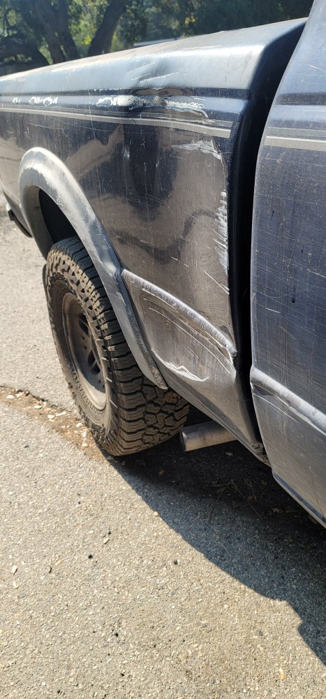

My dent
That's actually not too bad. The only trouble spot may be near the bottom where there looks like a little crease.
Go with the jack and 2x4, but make sure to spread the force as much as possible to push on that dent. Take your time, you will be amazed how forgiving steel can be with patience.
