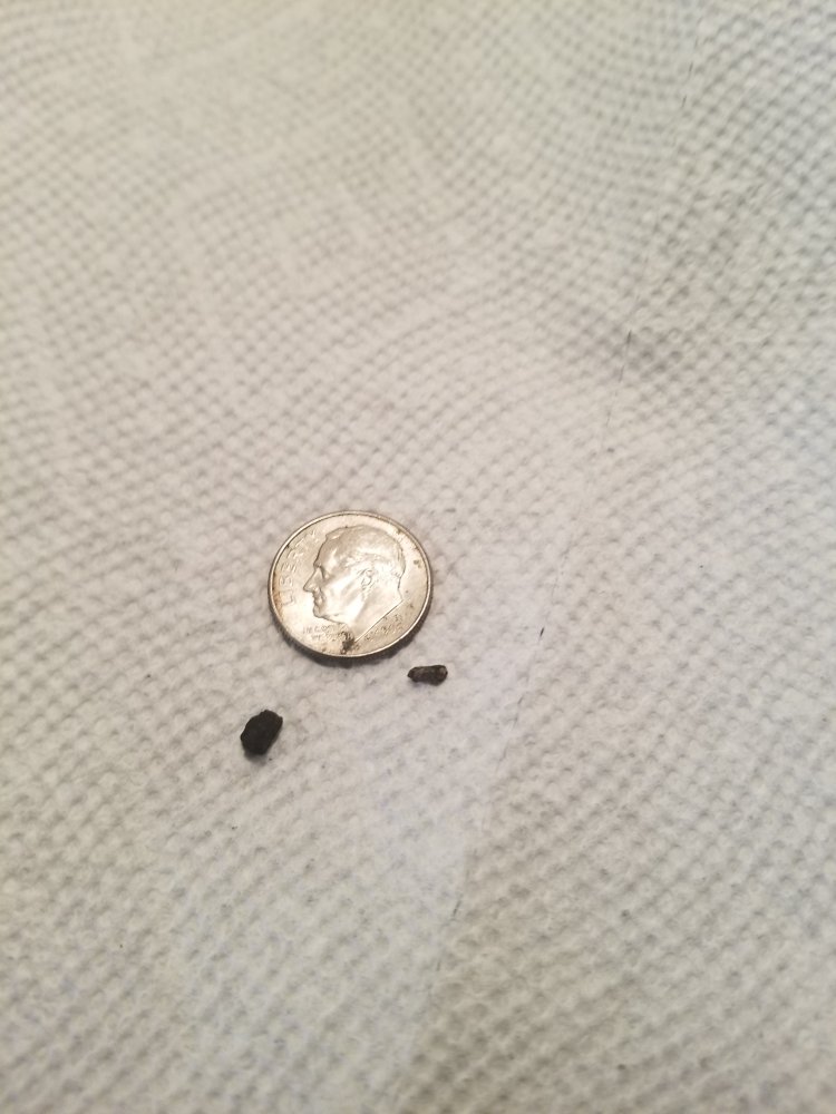

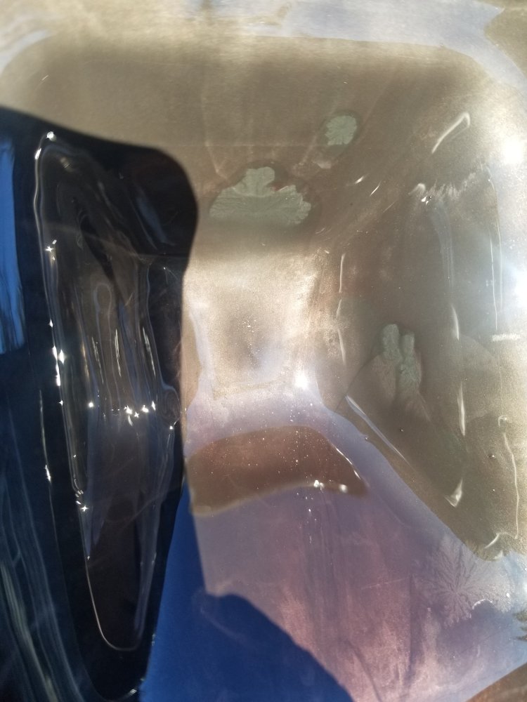

Ok folks, pulled pan and filter. Inside pan was indeed a few small chunks. Ugh. See picture with dime for reference. A couple little chunks that size or smaller, and then powdered metal in very bottom of pan that looks like metallic paint. Kind of like you see when changing old diff fluid. Pic of that too, you can see if zoomed up on. Also some gritty type business when dumping out filter on paper towel. Like fine ground pepper. That's it, dumped pan through fine mesh paint strainer. Guess this means my trans is toast. Bummer, drove home so well. If you had an 84 with bad c5, what would you do? I'm thinking pull it, take to shop for rebuild, pick it up and reinstall here (cheaper that towing and having them r/r). Or try to find used or rebuilt unit? Tricky with a hundred different versions, bell housings. Etc.

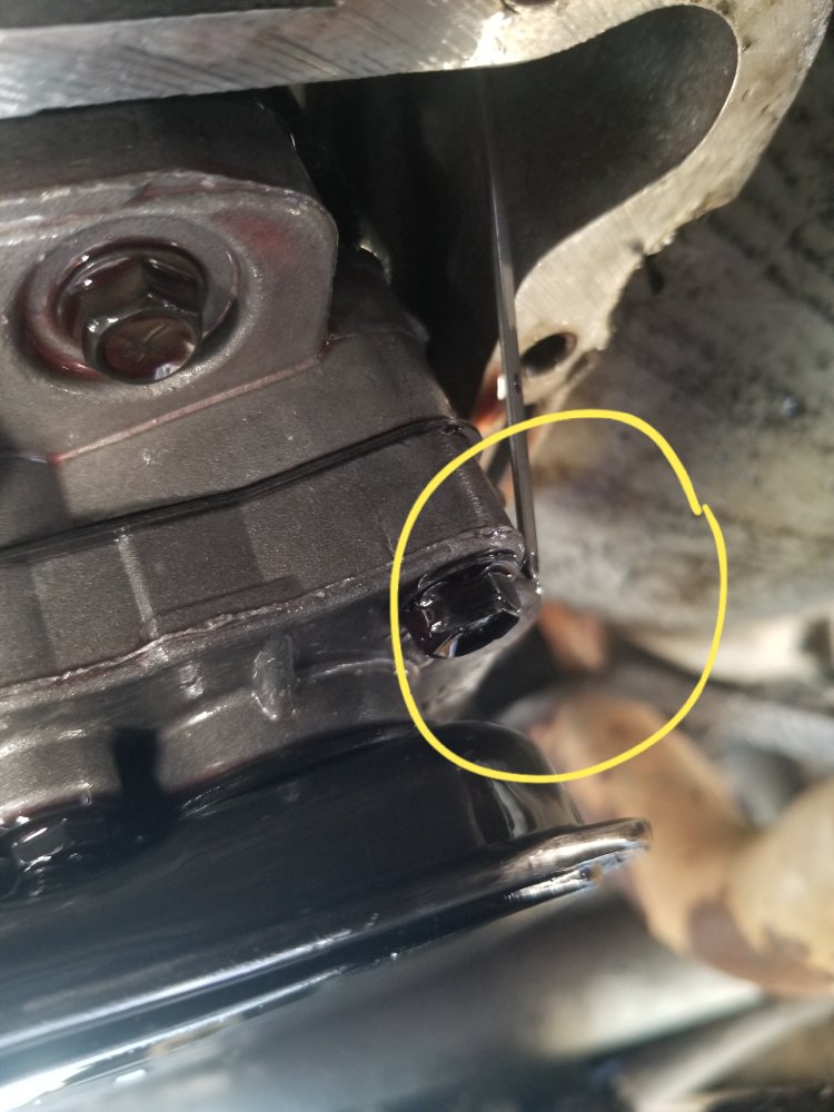

A used one is going to be at least 35 years old, I wouldn't go that way. If you pull it yourself, make sure to thoroughly blow out the cooling lines and cooler. Did you verify the fluid level before pulling the pan?
If you get it rebuilt, I'd find a reputable independent shop and avoid chains like AAmco.
*"If it were me"* I'd explore local shops, preferably an independent shop, in hope of finding an experienced rebuilder that knows this transmission well.
In my opinion, there's a lot of advantage in keeping the vehicle with the original drivetrain, if it's feasible to get a trustworthy rebuild on the transmission. I think you'd have a better shot at this with a C5, as opposed say to an A4LD, if you can find a good rebuilder.
Yes, verified fluid level, which smells like fresh fluid with no burn smell, foul odor, etc. Like cracking open fresh jug and taking a whiff. My dip stick I'm assuming is model correct, but hard to track down number with so many configs. Viewing from below, tip of stick goes to bottom of valve body almost exactly. See pic. Does that sound correct length for dip? Hard to check proper level as can't drive to bring to full temp. Have to go off of lower/cold Mark's. But as soon as I started to loosen pan bolts, fluid began running out as I would have suspected.
