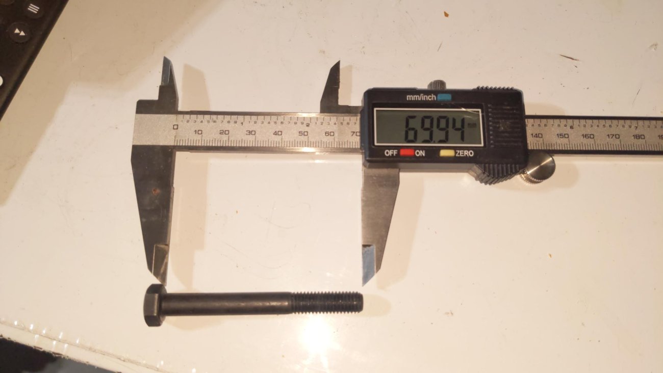

The bolts I sourced locally here (the only ones that go into the water jacket) were 13mm, 1.25mm pitch, 70mm long, grade 10.9 metric (I think the originals were grade 8 but I doubt that makes any difference at all here).
There are the smaller water pump bolts (8mm?) that will undoubtedly be fine and at least one super oddball bolt that's like an 8mm with a 17mm head- all those that weren't exposed to coolant are highly likely to be fine.
In my case, I very carefully sourced a half dozen of the 13mm bolts, then used none of them because the ones that came out cleaned up just fine.
