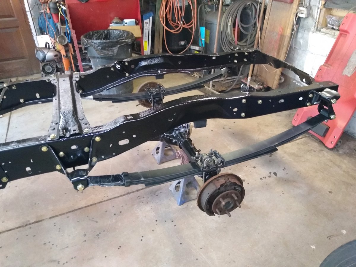

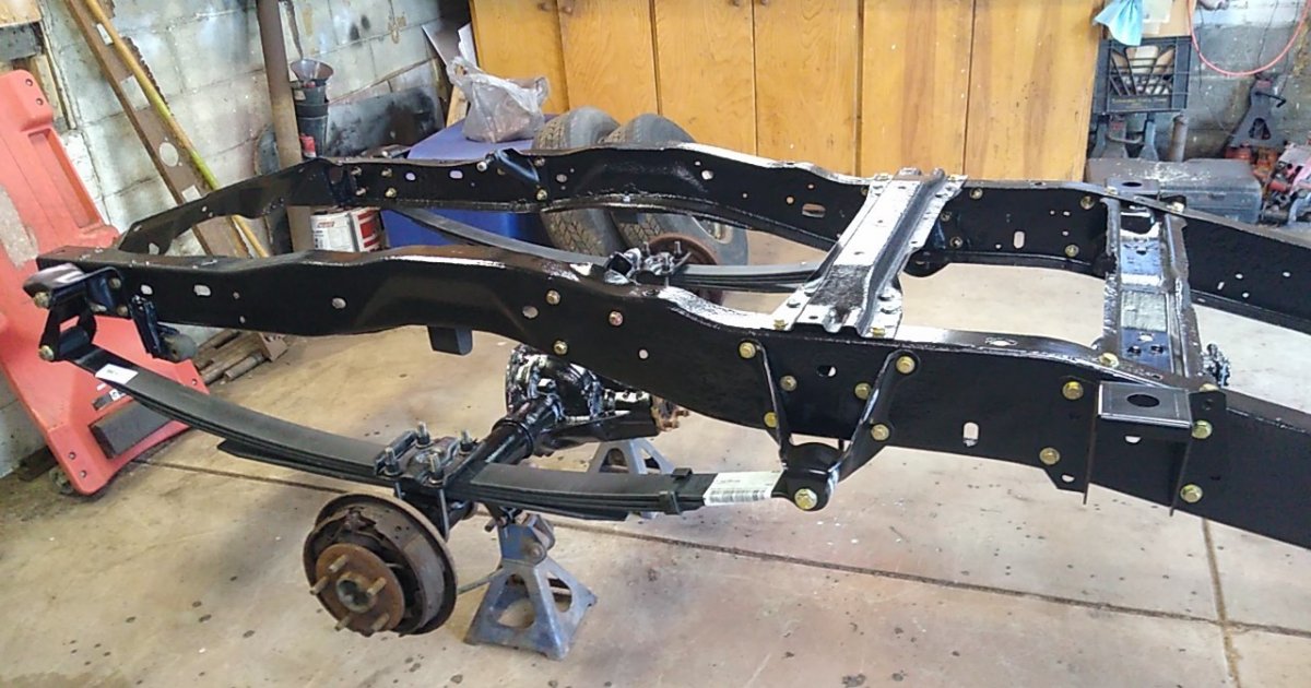

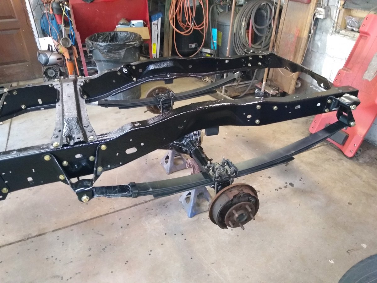

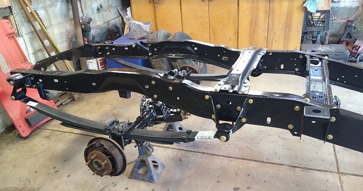

I got the rear end and new rear suspension in today. With it hanging back in the frame it will be a lot easier to take the backing plates off for sandblasting. I have to get new nuts for the front springs. I ordered a set from LMC but they are too small. Once I get those I can finish the front suspension.

View attachment 58417 View attachment 58418
Always looks better with axles and springs.
