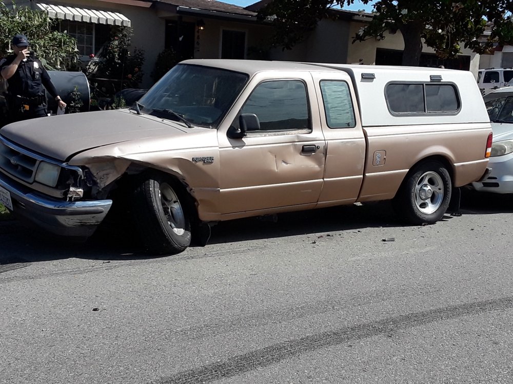

Hey Folks I have a two wheel drive 96 extend cab Ranger (had a 97 till some SOB stole it) that got hit on the drivers side, it took out/bent the axle, radius arm and spindle with out tweaking the frame thank god. my question for you is will the 96 Mazda parts fit the 96 ranger? if that's all i can find.
they totaled it but I'm not letting it die, it's the best drive train I've had in the last three rangers I've owned.
From what I understand, Mazda trucks are just clones of the Ranger and everything should be identical
Agreed, any '95-'97 truck should have what you need, Ranger or Mazda. Just make sure you get the correct spindles and brake parts since it looks like you have front wheel ABS (4WABS) on yours.
The beams, radius arms and any non-brake-related items should be the same regardless of ABS though.
