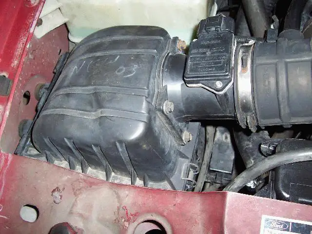

The issue I am having is that half throttle it bucks full throttle it pulls thinking it needs more air has cold air intake on it already didn't help none
All fuel injected Rangers came with Cold Air Intakes(CAI) from the factory, if this has been changed then you may have found your problem
This is a CAI: https://www.explorerforum.com/forums/attachments/oembox-jpg.59437/
This is a low flow and a warm air intake: https://www.knfilters.ca/media/images/l/57-2527.jpg
Tell tale............if you can HEAR the AIR FLOW going into the engine then its RESTRICTED
Many like that noise, that's fine, just know it means air is turbulent(the noise) so restricted
