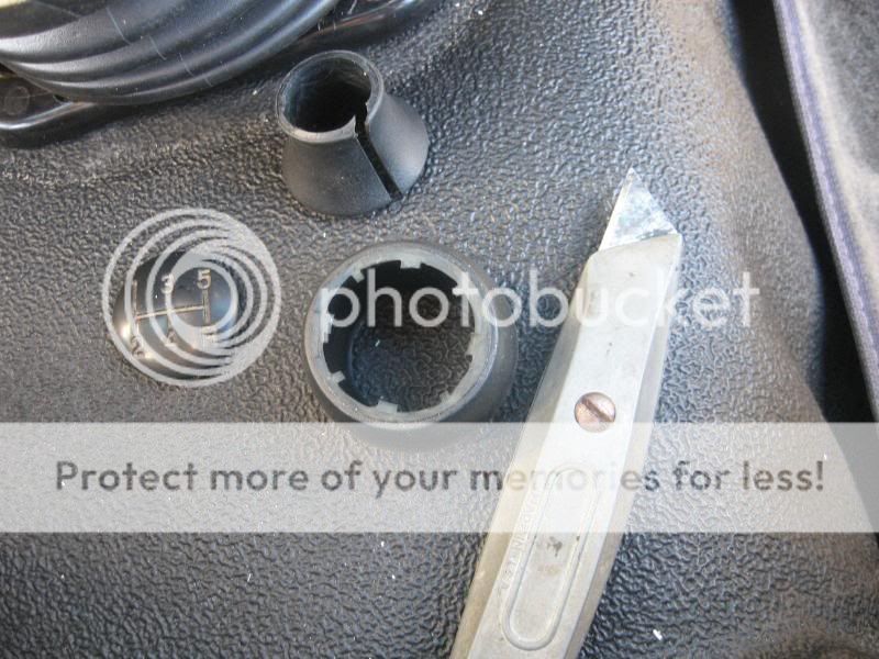

1)
First i took a razor and scored my way through the rubber skin on the bland stock shift knob.
2)

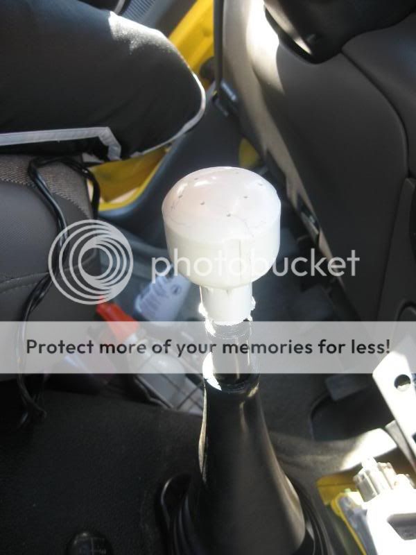

After tearing off the rubber skin you reveal the injection molded plastic skeleton of the stock knob. Mine was a little brittle so i was able to just flex it with some jaws and it began cracking apart, otherwise there multiple ways to 'chew' or cut the plastic off with various hand tools or to even split it down the side by drilling guide holes and screwing large self-tapping screws down into them. Whatever gets the job done.

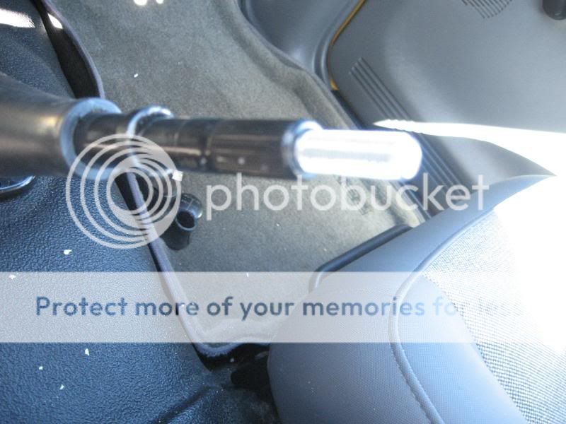

3)

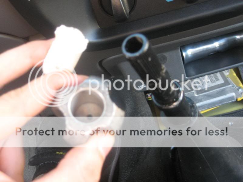

After breaking through the plastic, you reveal a cast metal core. It is only slip-fitted to the remaining plastic between the lever and itself so it should come off with ease. The remaining plastic over the lever is factory glued to the splines that run down the top of the gear shift lever, so your probably better off cutting down the shaft rather than 'chewing' it off piece by piece .
4)

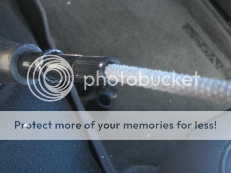

Clean off all plastic and glue leftover in the spline's grooves and inside the lever's cavity.

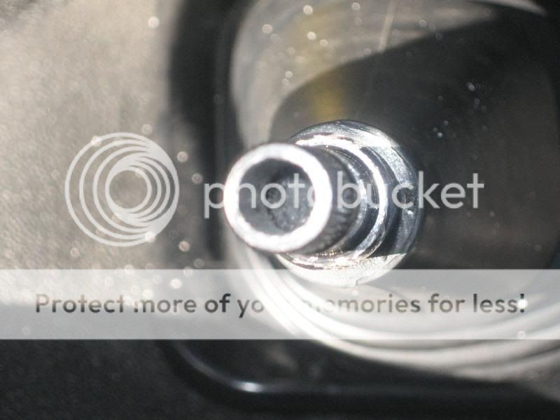

5)

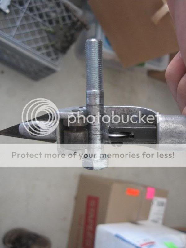

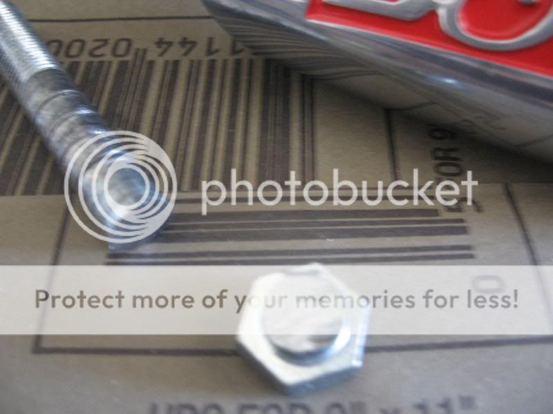

Next comes the threaded insert bolt thats needed to attach any threaded knob.
(I found that a 3/8-2.5" bolt was able to sit down inside the lever cavity perfectly and with just enough space leftover for a cold welding agent. The 2.5" length was perfect too because the way it sits inside the cavity aligns the threaded section of the bolt shaft right at the very top of the gear shift lever. In addition, i found most aftermarket threaded shift knobs come with a 3/8 step up/step down threaded insert for attaching the knob to the lever)
I used a pipe cutter to roughen up the non-threaded part of the bolt so the cold weld agent has something to grip to besides the smooth part of the bolt.
6)
Then i cut the head off the bolt
7)
With the bolt roughened up and prepped for glue, i needed to do the same with the other surface inside the lever cavity. So i took a rough rat tailed file and knared at the insides of the cavity (making sure to remove all visible paint).
8)
Double check the fit, making sure that any excess metal burs don't keep the bolt from smoothly sliding into the cavity. Also check to make sure that the threads start where you want them to because once you glue it place, you wont be able to make adjustments.

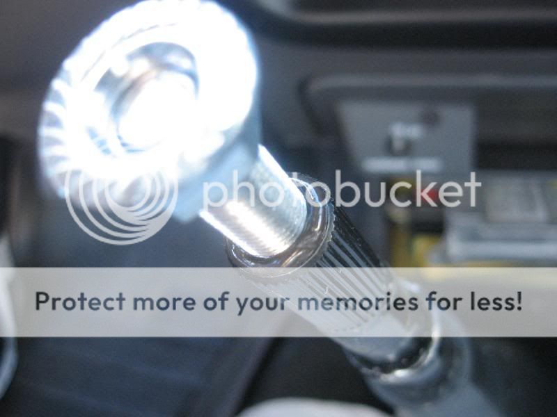

9)
I used JB Weld 'KWIK' because it sets in around 4 mins. This is important because as you coat both the cavity and the threaded bolt with the JBW and insert the bolt into the cavity you create a fierce air pocket between the two. This air pocket will naturally want to push back as you compress it in the cavity causing the bolt to eject itself back out of the cavity. This is solved by holding the bolt down for around 4 mins until the JBW sets.
(screwing on a jam nut or placing a block of wood at the top will help take the pressure off your palm while holding it there)

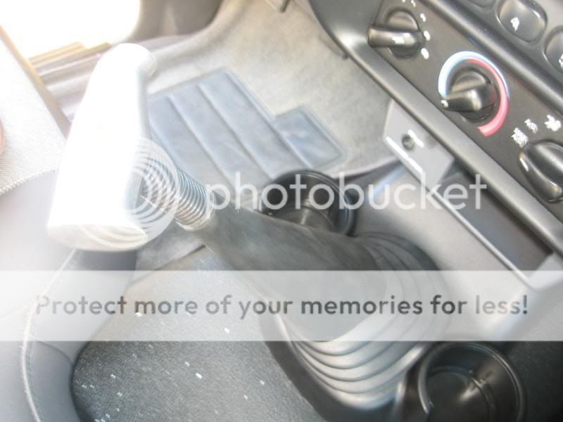

10)

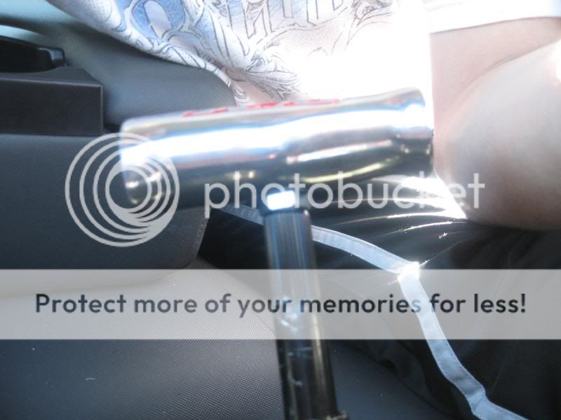

Once the JBW cures, go ahead and thread on your choice of knobs and secure it with Loctite (or your girlfriends nail polish if you cant afford it). Then lock the jam nut up against it for extra secureness.

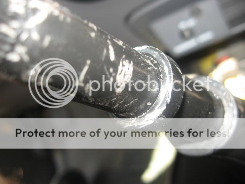

Now, if your like me you have probably scratched up the lever quite a bit:

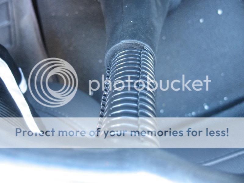

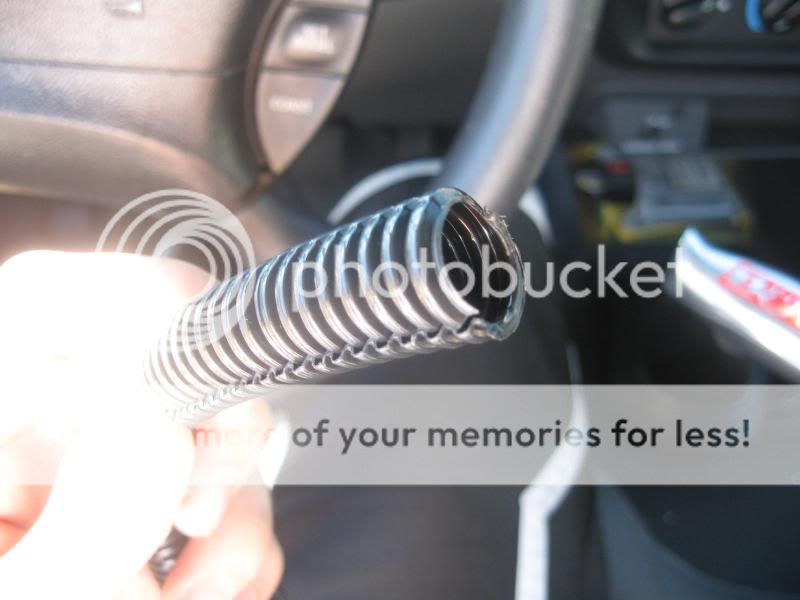

I found a cheep and clean looking way to cover up those leftover blemishes.
- 1/2" ID (13mm) split flex tubing -
Cut to size and slip over
12)
And your done
