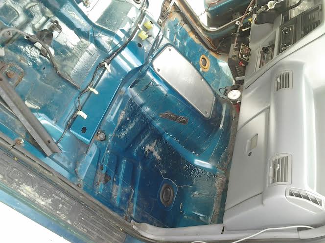

passenger front:

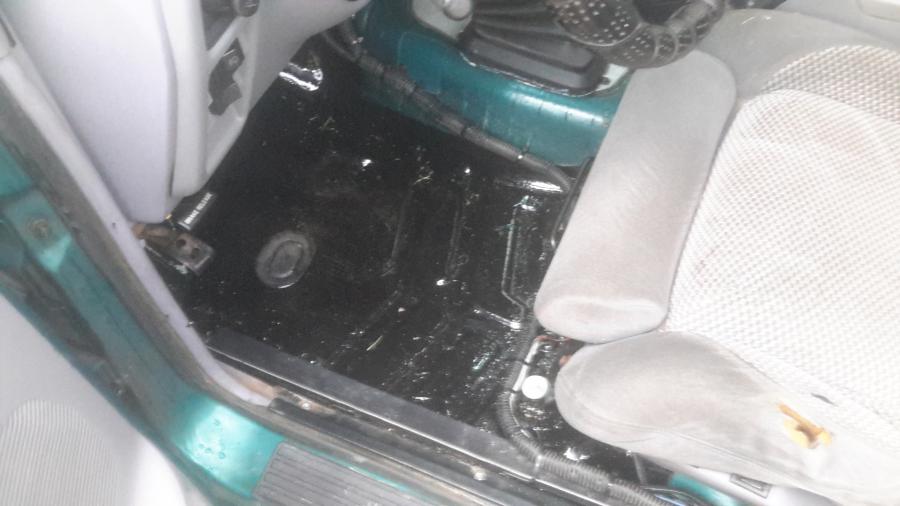

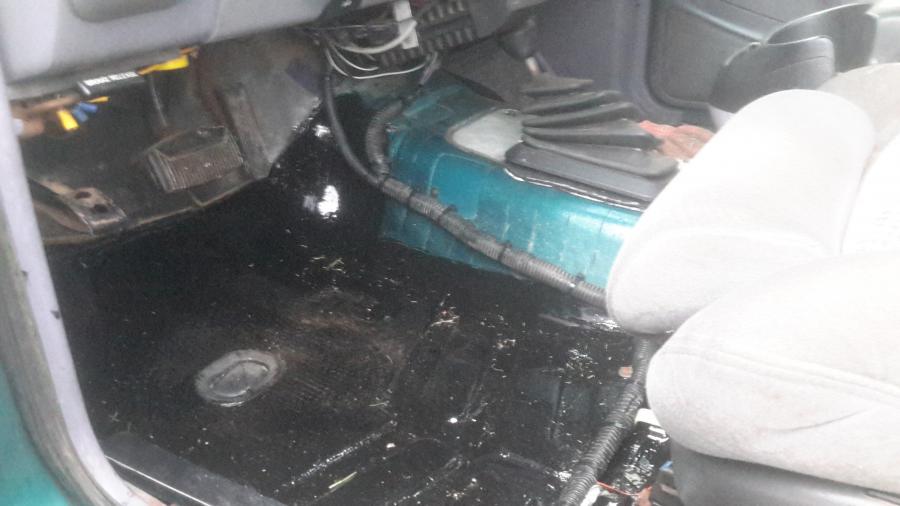

Here are the pictures:
I think it came out pretty good. Plus i buttoned up the wiring with new loom and also coated the front of the seat mounts.
