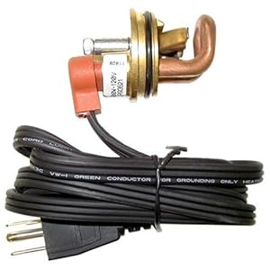

Ford part number is XL5Z-6A051-AA IIRC, not sure about the Motorcraft part number but any half decent ford counterman should be able to change it up, since I'm not at work I can't. I'll be getting one for my truck tomorrow so if I remember I'll post it up.
Just Picked up a Napa Branded Heater (P/N 11416). Going in this weekend. Gonna use this and their paragraph of directions to but that bad boy in.

They were thinking of a tank heater, which is a tubular thing that mounts outside the engine and circulates the coolant throughout the engine as it heats it.

Think again, the "Tank Heater" heats the water in the radiator tank, the radiator then cools it.
The "Block Heater" puts the heat in the block... where you want it.
The tank heater caught on because it doesn't require pulling a freeze plug, just splice it into the coolant hose. I've done both and there is a big difference.

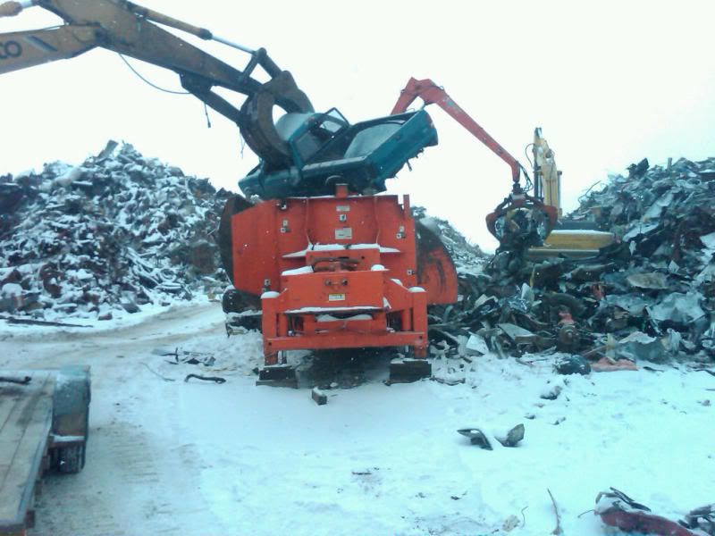

lol this is what happened to that truck after I got hit.
