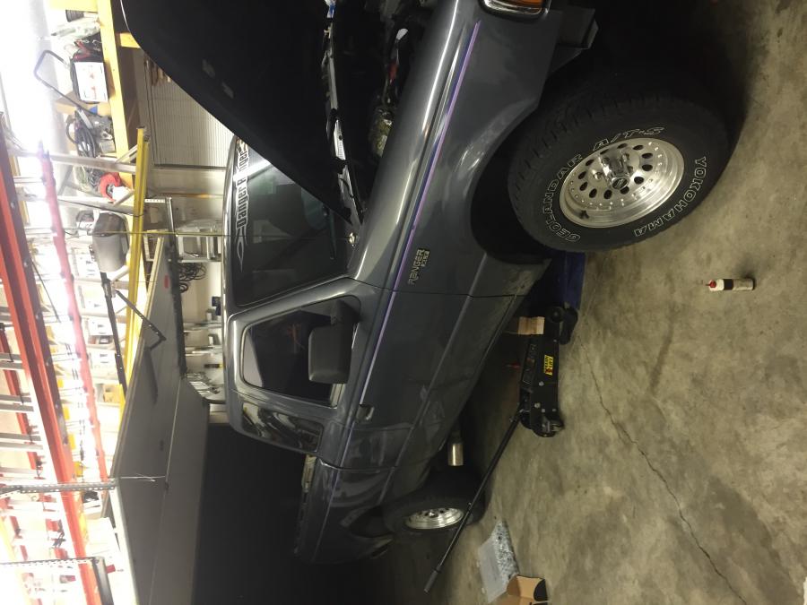

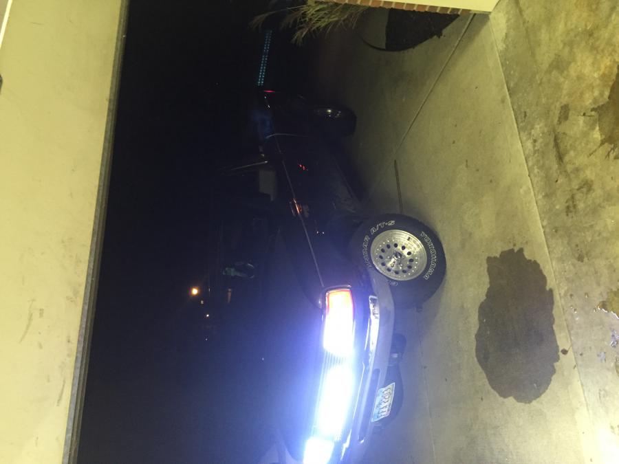

I did a 3 inch body lift and its cheap but labor intensive. now all I want to do is raise the front with coils about a 1.5 inches to level it out and next looking to get 31 10.50 15 tires i have 235 75 15 on it now. Little leary about it because a4ld transimssion arent the best.
