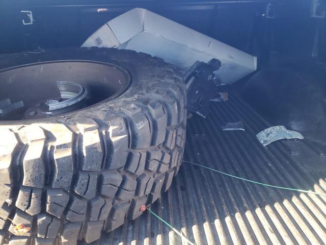

well....rusty is right about regular stuff. the raptor though generally has 4.10 gears...
in the case of this.....and yes i have been looking at this stuff in case i buy a newer ranger....you just buy a whole raptor front assembly and fit that to the ranger...
the new ranger stuff is pretty bad ass....i do think ford did a decent job on the stock setup and abused with light duty 33's will probably do ok........
unfortunately.... looking at the bronco raptor and overseas raptor....beating the hell out of these things off road with high traction large tires is failing fords stock chassis.
but i love having full width on my ranger....it stability is something else off road....so running a fat bastard raptor 150 setup on a modern ranger with burly mounts would be my preferred unless the new ranger system proves adequate.
of course to get half a raptor suspension and diff.....for 1500......your rolling the dice on this....
