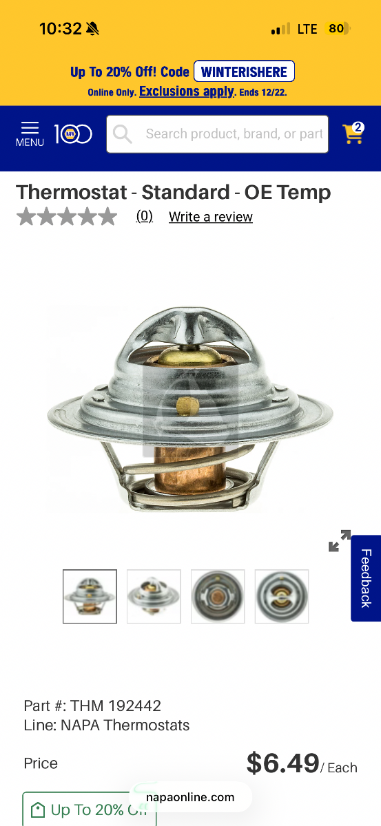

Hey all, gonna be replacing my thermostat as my truck isn’t getting warm, it will only sometimes barely reach n on the beginning of normal but usually Is floating around under that. Anyways the one I was looking at I believe I need a paper gasket or somthing like that but I thought the top circle needs a rubber o ring or somthing like that because in some thermostats there is one and some there isn’t

180 or 190 with the O-ring and a gasket as well. $10 or so. Auto Zone or Oreilly's. Not sure what's in your area.
Definitely order the Motorcraft. I had a half dozen various brands from multiple stores at one time. Let 'em set in boiling water and they never opened.
I also recommending Motorcraft. Ford no longer sells one for the 1995 351 in my Ranger so I bought one from Napa and replaced it 3 months later when it failed. Then replaced the next one with a stat from Carquest. They all look like Ford thermostats, they just don't work.
