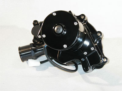

I should note. I built my 289 from scratch and one of my big concerns was I live in the northeast and drive my car in the winter. Sitting around wating for heat sucks. With a normal water pump, flex fan and thermostat and a huge 4 core radiator it would take 45 minutes before some heat came out. With an electric fan, and electric water pump run on a computer controller the water pump always comes on at "low" which is similar to a closed thermostat. The ECT sensor gives exact temps and sets the fan and water pump. So not only does my mustang warm up faster but it stays at the precise temp set by the computer. No guess work. That engine runs best at a ECT temp of 175 (this is not the temp a thermostat would see). If I ran a thermostat I would probably still need to run a 195... there is no guessing or balancing, sensor and computer does the work and keeps that engine perfect no matter if its idling in 20 degree weather or running down a drag strip on a 110 degree day. The computer knows the perfect temp and keeps it there. Mechanical crap just cant do that.
Yes, reads like a neat system but.............................
The size of the radiator doesn't matter, except for OVER heating
The engine takes XX minutes to get coolant to say 130deg, different for each engine, and the heater core is part of this system, so its at 130deg as well at the same time, so a bit of heat in the cab, have to wait 3 or 4 minutes more for the 180-190deg heat
The speed of the water pump wouldn't matter, except for OVER heating, coolant circulating slow or fast in a CLOSED system transfers heat equally
It may seem like if it circulates slower it would warm up faster BUT...........its a closed system so the cooler areas make the slower moving coolant a moot point because all the coolant needs to warm up
Radiator only comes into play when and IF thermostat opens, on some engines radiator is not even used in the winter time
With a closed thermostat the engine does not have to heat the volume of coolant in the radiator before you get heat in the cab. That can stay cold until the rest of the coolant is warm.

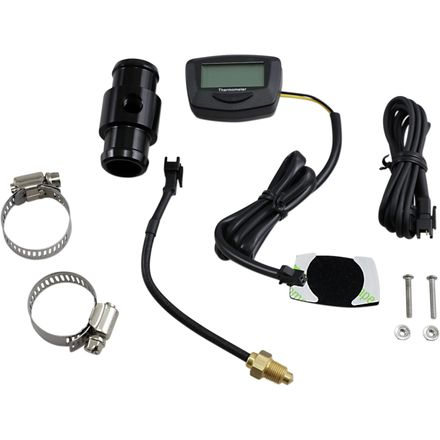

I have been running one of these to monitor my temps and put actual numbers to the factory temp gauge.
My factory temp hovers right around the middle. Once warm, the digital temp shows between 185 and 198. The sensor is plumbed into heat hose coming from waterpump. I am running motorcraft 195 thermostat.
Seems tip top, not messing w/ it for now...until I get bored enough to attempt the efan swap again.
Ford temp gauges usually have 205-210deg as the center line, so needle should run just under 1/2 after full warm up
But there no close calibration of these needle gauges, lol
I figured either the sensor is off, or its due to location (the waterpump to heater line)
I am gonna splice in another pickup at the upper radiator hose. I also have a nice auto meter gauge I may swap in.
Well upper rad hose temp will be low until engine warms up and thermostat starts to open
Heater hose was the better choice, it warms up with engine
Lower rad hose might be a better choice, if you are keeping the heater hose temp gauge as well
It would show you the cooling capacity of the radiator and fan in different driving conditions
I can do the lower hose as well, and probably will, having read that.
Yes I will keep and eventually use both, one for the temp gauge, the other for the efan switch, which will probably go in the heater hose. Temp gauge in lower hose.... Right?
