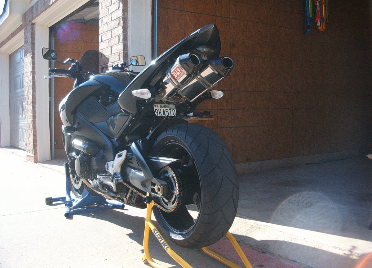

You have no idea how I run my Vehicles. What's the point of owning a much modified Lightning if you're not going to use it? What's the point in the modified exhaust, MAC intake and chip on the computer on my Ranger if I'm not going to thrash it like a rented mule? What's the point in the custom exhaust, WeaponR intake and 93 octane tune on my Mustang if I'm not going to beat it like a red-headed step-child? I may be 58 years old, but I still like to drive rather aggressively. Maybe too much so. I don't have a Suzuki B-King for no reason. And YES, I know how to ride it! LMAO!
