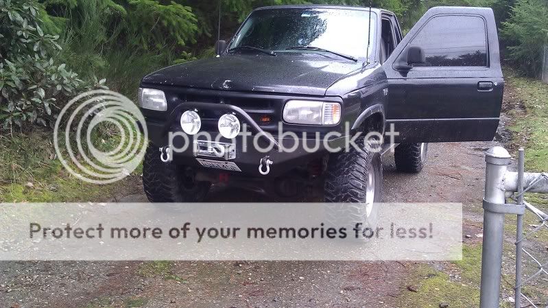

the winch bumper build
Yeah I don't think 94's have any airbags. My 94 Limited Explorer with all the bells and whistles doesn't have air bags:icon_thumby:
mine is basic, manual everything, but thats how i wanted it. so there def wouldnt be airbags
Looks great good work. Is that a miller 211 your using? I have a 211 with the aluminum spool gun and I love that thing.
it does not have airbags.
That's good! I wasn't sure due to the year. It still changed the energy management system (crumple zones) but it isn't as big a deal without airbags. Anytime you see convulusions like that in a rail and the diamond shaped holes it is a designed crumple zone. Per Ford "any" damage in this area requires replacement. They sell a replacement "section" that replaces that section of both rails abouth 12" beyond the crumple zones, I believe it sections in around the 2 front perches for the core support. The crumple zones are designed to crumple or crush in a controlled way to absobe collision energy and direct it away from the passenger compartment.
This is a sick bumper and well organized thread. You put a lot of time into this build and it definetely shows.
nope its a 140, but it gets the job done and has served me well so i cant complain. just have to remember the 20%duty cycle. got it 4 years ago when i was just starting/teaching myself to weld. :icon_welder:

That bumper is very nice. Nice welds as well man! Got any specs on the metal thickness and dimensions?
its practicaly all 1/4 inch, thick and heavy but i wanted it to be beefy and handle abuse. as for dimensions i would have to go out and measure i never wrote it down and have made a few others sence
