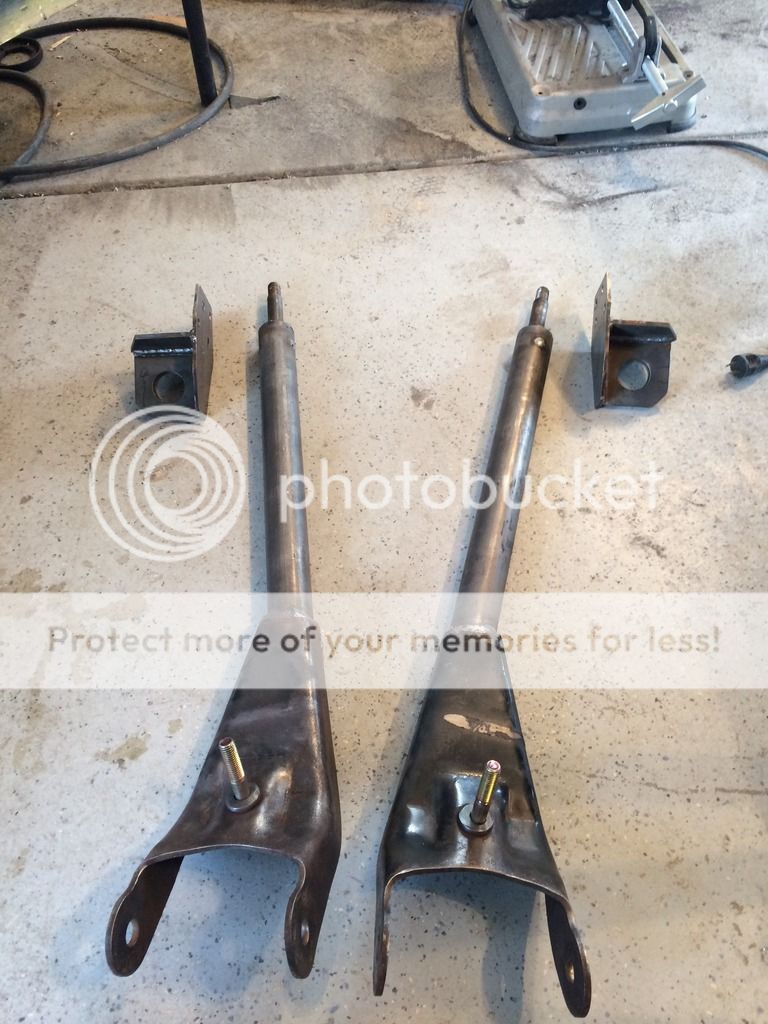

Day 1
First we took the old arms off and just to make it easy and use the same locations.

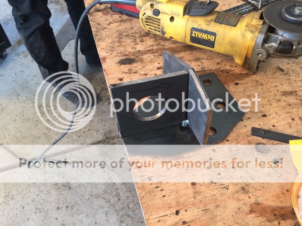

Then mocked up some brackets using cardboard and got to cutting. This whole process took us all of day 1 and here was the end result.

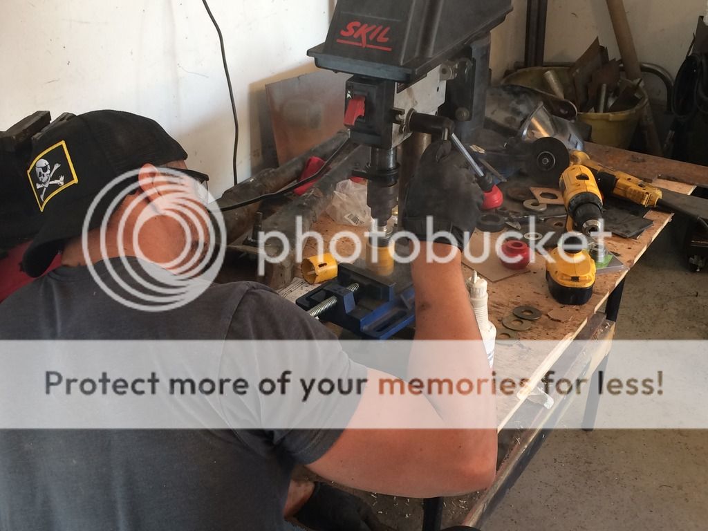

To get the angles we needed, we just put the axle at stock height and followed the angle of the drive line. If i remember right it was like 6 degrees. To cut the hole for the arm we used a 1 5/8" hole saw from lowes(cause home depot didnt have it). Something we also did was used a small portion of galvanized plumbing pipe(dont remember the size) to make a washer or spacer type thing on the back of the bracket so that there was no space in the bushing.
Here is Dante doing his thing on the drill press

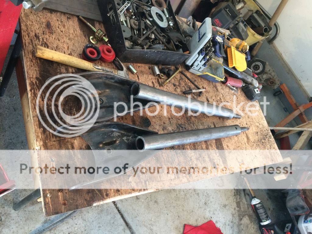

Day 2
Day 2 was alot faster because we already had our angles and design laid out so it was a piece of cake to throw another bracket together and build the actual arms.
So first thing we did was cut and build another bracket.

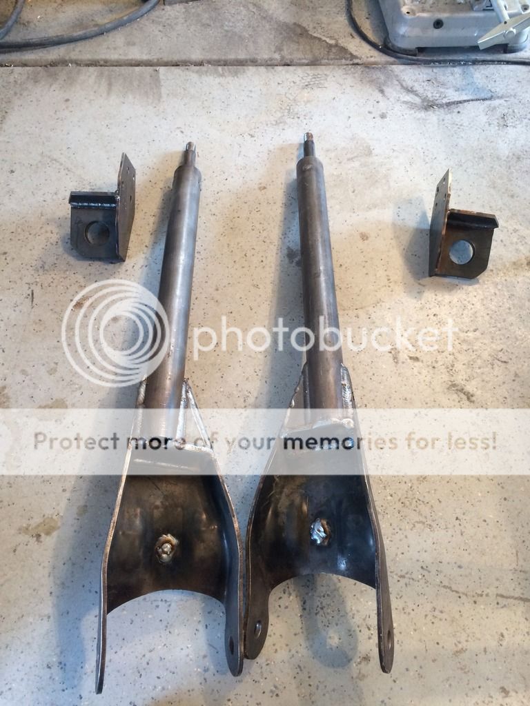

Then came the arms themselves. First i measured and cut the rod end off. Then i cut the arms right where the the tubing fit nice and tight. From there we installed the cut up radius arms to the axle and measured how much tubing we would need.
Once we got that length the tubing was cut it was tacked into place and everything was fully welded up. BlackBII did all the welding.
Here is the end results. Sorry i didnt take more pics of the entire process.

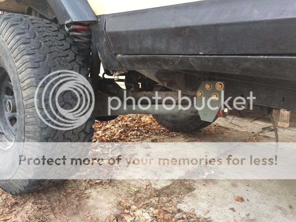

Here is what they look like primed and installed:
They area gonna be painted black when i get my powersteering all fixed up and the front third member re sealed.
The drive home i can say was 100 times better than the drive down. I had no more rocking, without realizing it i would be at 70 mph and no problems at all. I have not been able to tell a major difference flex wise from the hiems to bushing. But if i was to recommended this upgrade to anyone i would say bushing for the win.
