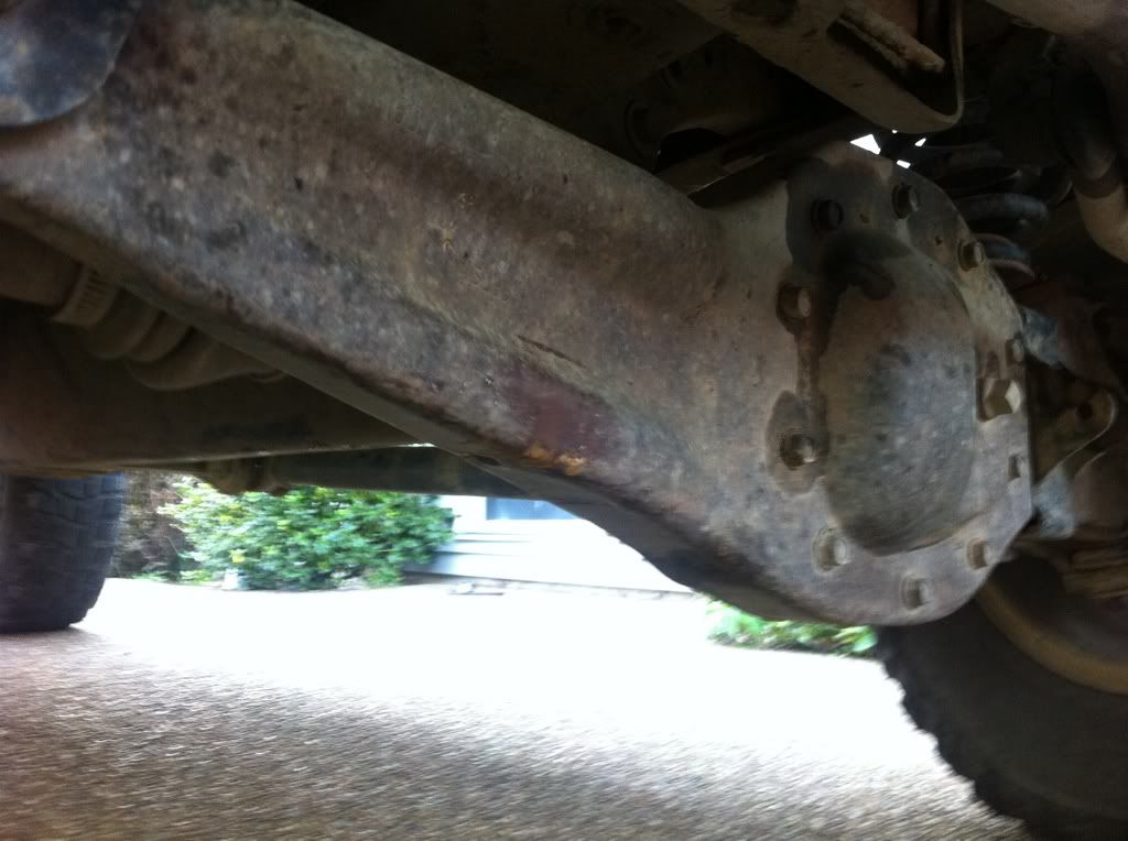

also bend my driver beam on a rock.

So did the drivers side beam bend in the middle changing your angles on the pass side shaft causing it to rub like that?
Yup, I guess I'll pull it and bend it back and truss it or find another beam to truss
