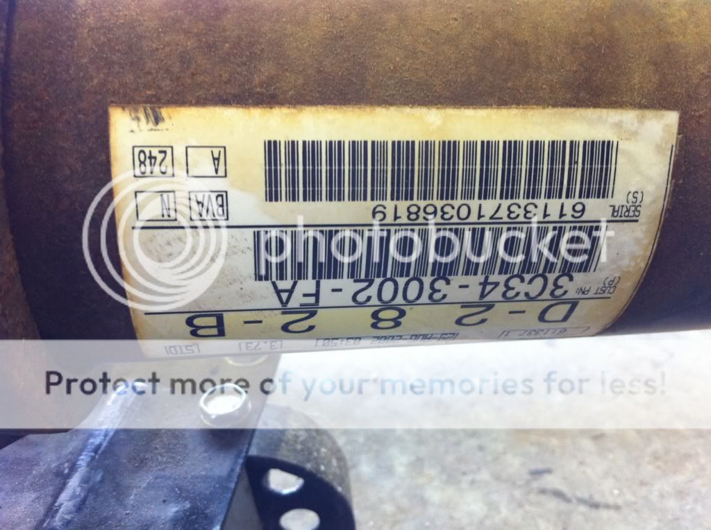

Jon, I'd pull the cover and verify on the ring gear that it is a 60, I don't recall 60's ever coming in the new F250's....
SVT
It's a 60, d50 has 1 1/8 pinion d-60 has 1 5/16. D60 also has the 248 number onthe sticker on the back side of the passenger tube.

and the proof its a 60....
the slo-vo build thread...
the 248 in the left hand upper corner

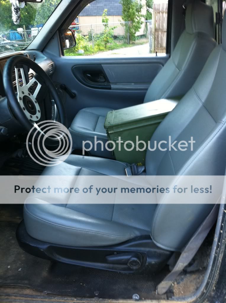

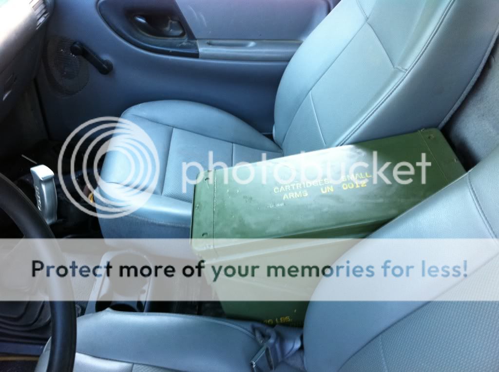

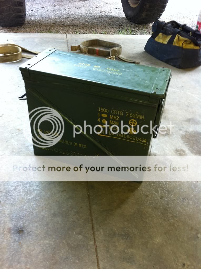

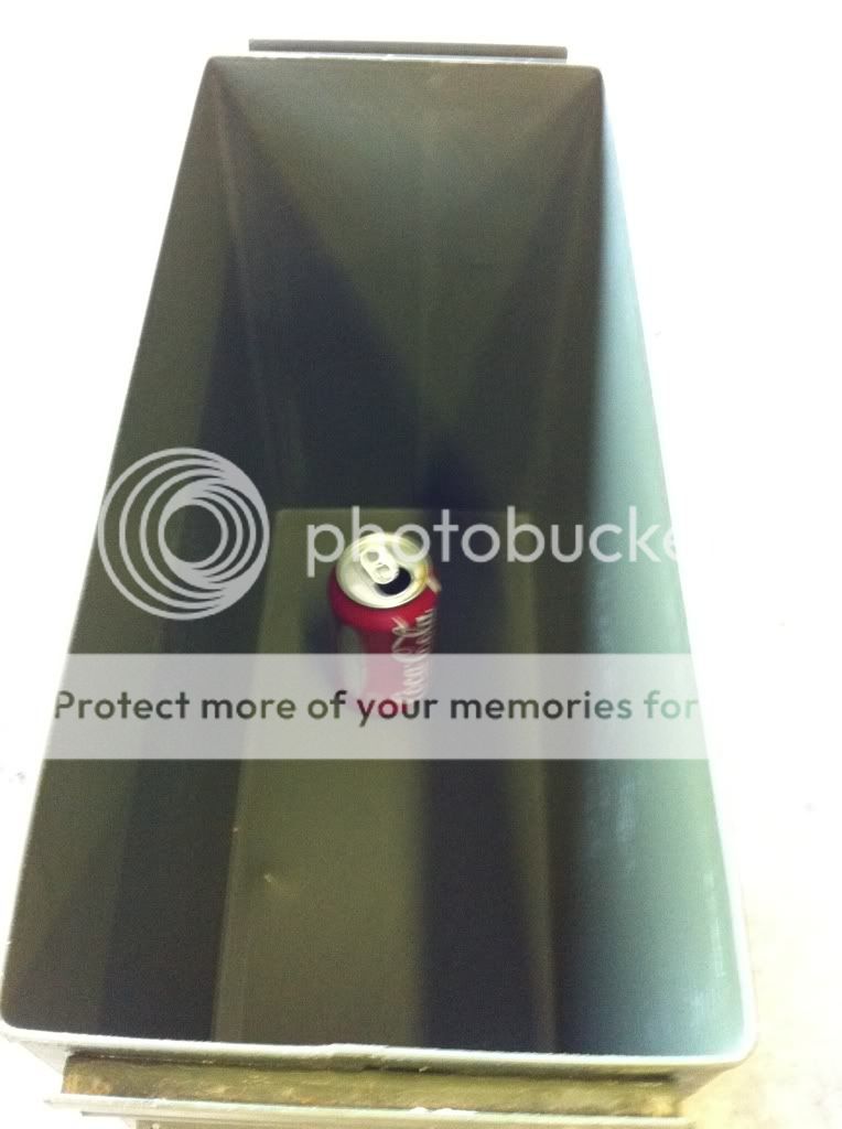

on my way home from work to pick up my tools to head to the JY i stopped at the army surplus store and grabbed a center console/ ammo can. he sold the ones i was looking at so ended up having to grab a HUGE one but it actually worked out perfect.
thats a regular size coke can in there lol..

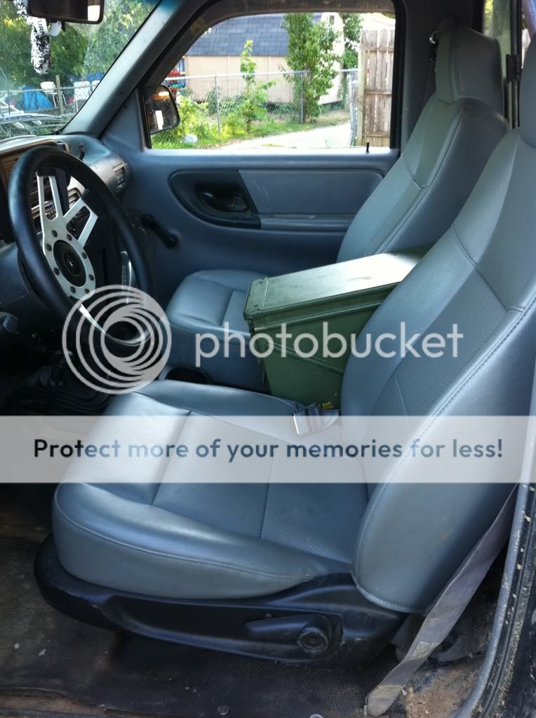

if it gets too hot im going to cut the top and set a cushion down into it because i dont want it any higher and the 2010 cupholder that came with the seats is temporary until i come up with something better
edit: that first picture is crazy looking, just took it sitting in the garage floor :dunno:
WHOA!! Don't cut the top of the seats!!!
Top of the seats? Going to cut the lid of the ammo can to set a pad down into it
