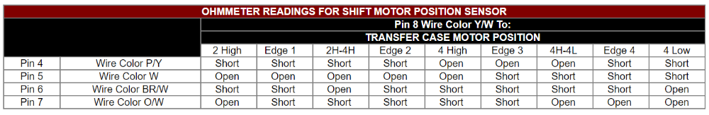

The shift motor has a contact wheel that turns when motor turns, this is how the "Control" knows what position transfer case is in at all times, at key on it see what contacts are open and closed so it "knows"
And that how the Green light worked, when contacts were correct for Neutral the Green light came on, same as 4high or 4low lights on dash
63309
If you wanted you could high jack motor wires to disable "Controller" from moving the motor, and allowing you to move it
I think the "controller" sends out 5v or 12v on the Yellow/white wire, pin 8
Then it watches which of the other 4 wires is sending back that voltage(closed contact) or not sending it back(Open contact)
Looks like you could use Pin 7 Orange/white wire
Add LED to that wire, so it would be OFF in 2WD but be on in 4H, then it you manually move shift motor counter clockwise, when LED goes off, STOP, you would be in Neutral
If you get lost just return control to the system and turn key on, it would move back to 4High or 2WD which ever position the dash switch was in

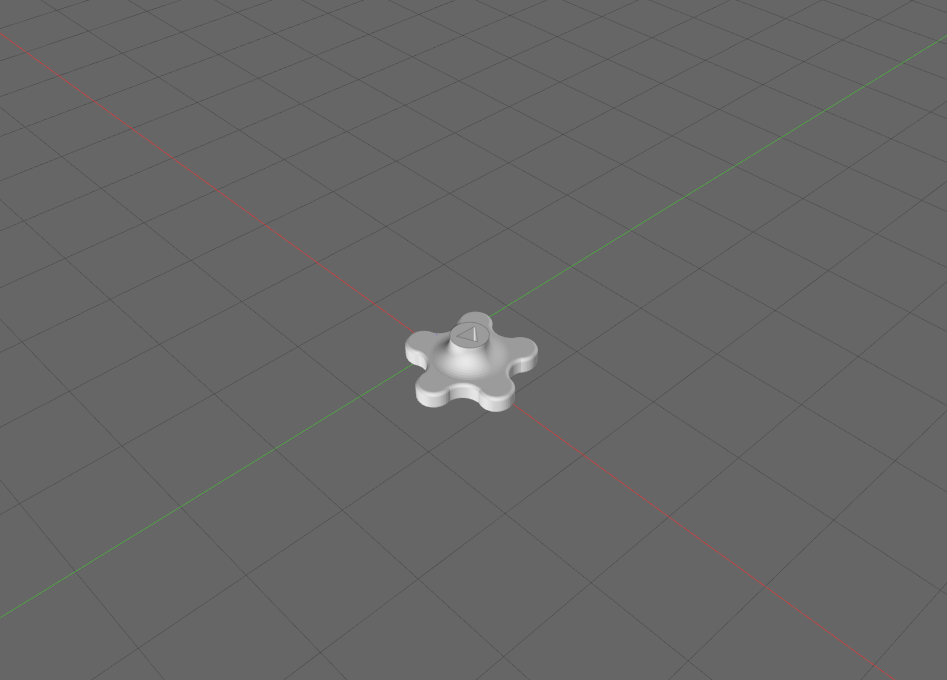

Hey guys, so I have actually created a 3d model and I’m going to share the .stl file for anyone that has a 3D printer, or a buddy with one. It’s my own spin on the knob in the title of this forum. Since it’s unavailable to buy a shiftster, I made one and it has helped me keep 4wd until I can get the funds to do something different with my drivetrain. I will post it in a couple of hours.
Hope this helps somebody!
As promised, Here is the ever-evasive shiftster that many will steer you away from. However, In a time of need, this will get you out of a pinch.
It's been a long time since I have printed this, so I don't remember my settings. Print as you see fit, but I would recommend at least 20% infill.
Hope this helps!
