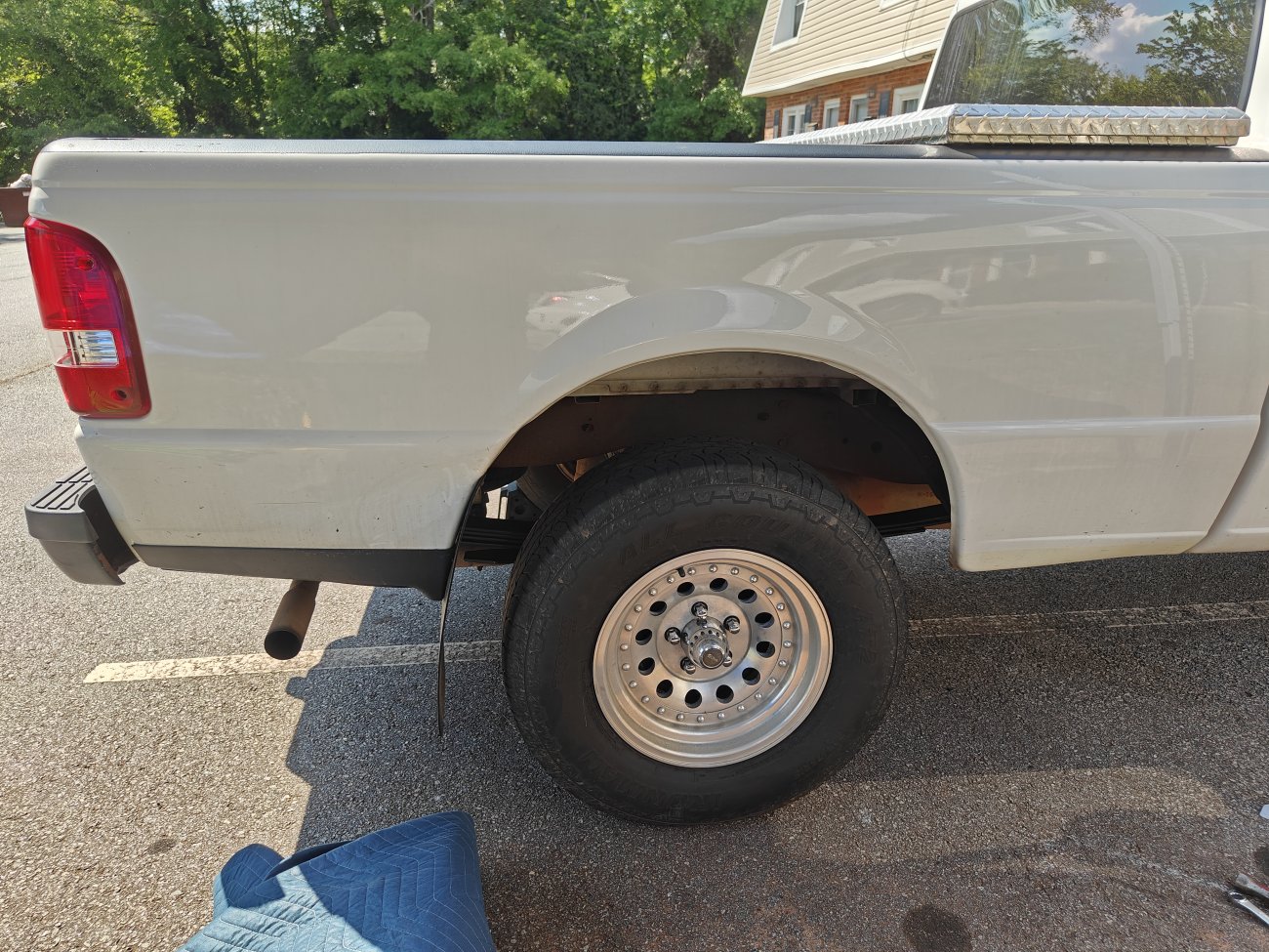

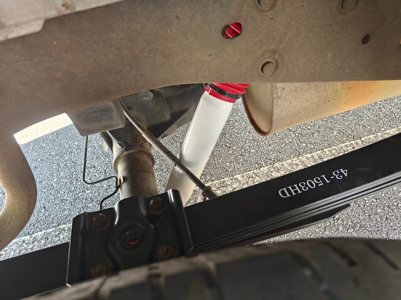

If the other side is the same just take the front leaf spring bolt out first then you can rotate the shackle forward to get the bolt out... It looks like someone before you changed the shackle brackets, they were riveted from the factory.
There are a  bunch of marks under the back end. This is weird. It's like the whole truck has already been worked on...
Holy crap that rear suspension was baaaaaaaaad.

Ironically, the truck now rides as it should, which is much harder than I expected. It rode like an old Cadillac when I bought it. Now, it rides like an HD Ranger.
Yeah, the stiff springs change things... I think my '97 has the light duty springs in it which I don't mind too much since it rides decent unloaded then like a caddy when I do something dumb...
I kinda like it. I'm going to use it to tow stuff eventually, so having a solid suspension makes sense for me. When I first bought it, I loaded it with about 12 bags of miscellaneous gardening materials and the back end groaned and sagged. Tonight I got in the truck bed to put some laundry in the box, and I didn't make a dent in its height. I'm about 220#.

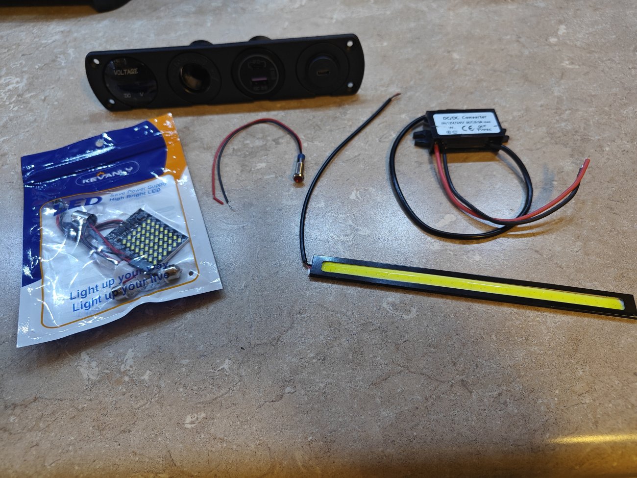

Chinese Santa came when I was at work.

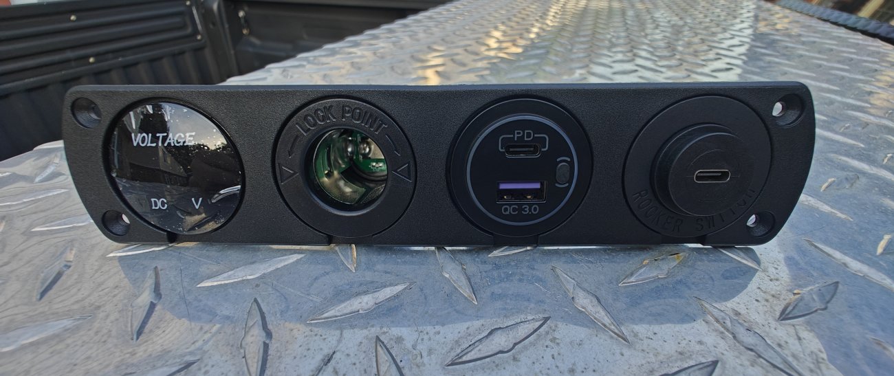

This panel was the most important part. 👇
As you've already seen, it comes with a USB charger that does Type C PD  or 3.2v Type A, a locking 12v socket, and a power gauge. It also has a rocker switch that was popped out of its housing to seat the USB-C passthrough. That passthrough is to connect a phone through a DAC (powered by the buck power supply above) to the Fusion radio I bought. More to come in that thread.

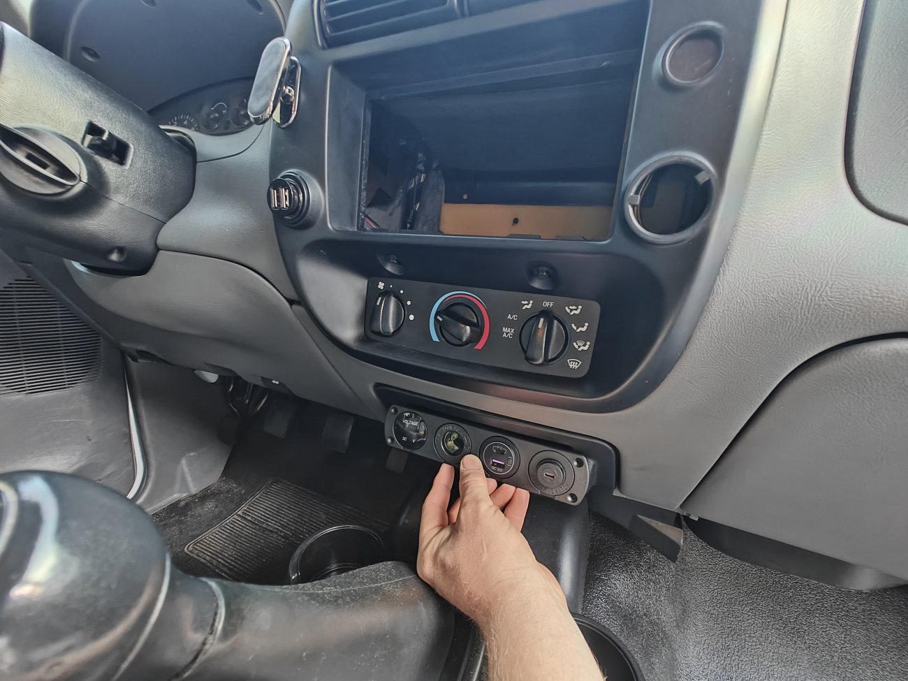

Here's a quick fitment check 👆 and it is as close as you can get without some minor trimming. It's not exactly an OEM look, but close enough for me.

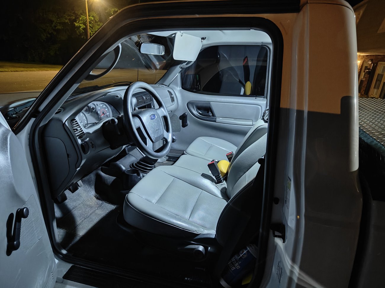

And the Lord said, "let there be light," so some smartass in SC took that to heart and installed an LED panel inside the cab of his Ranger.

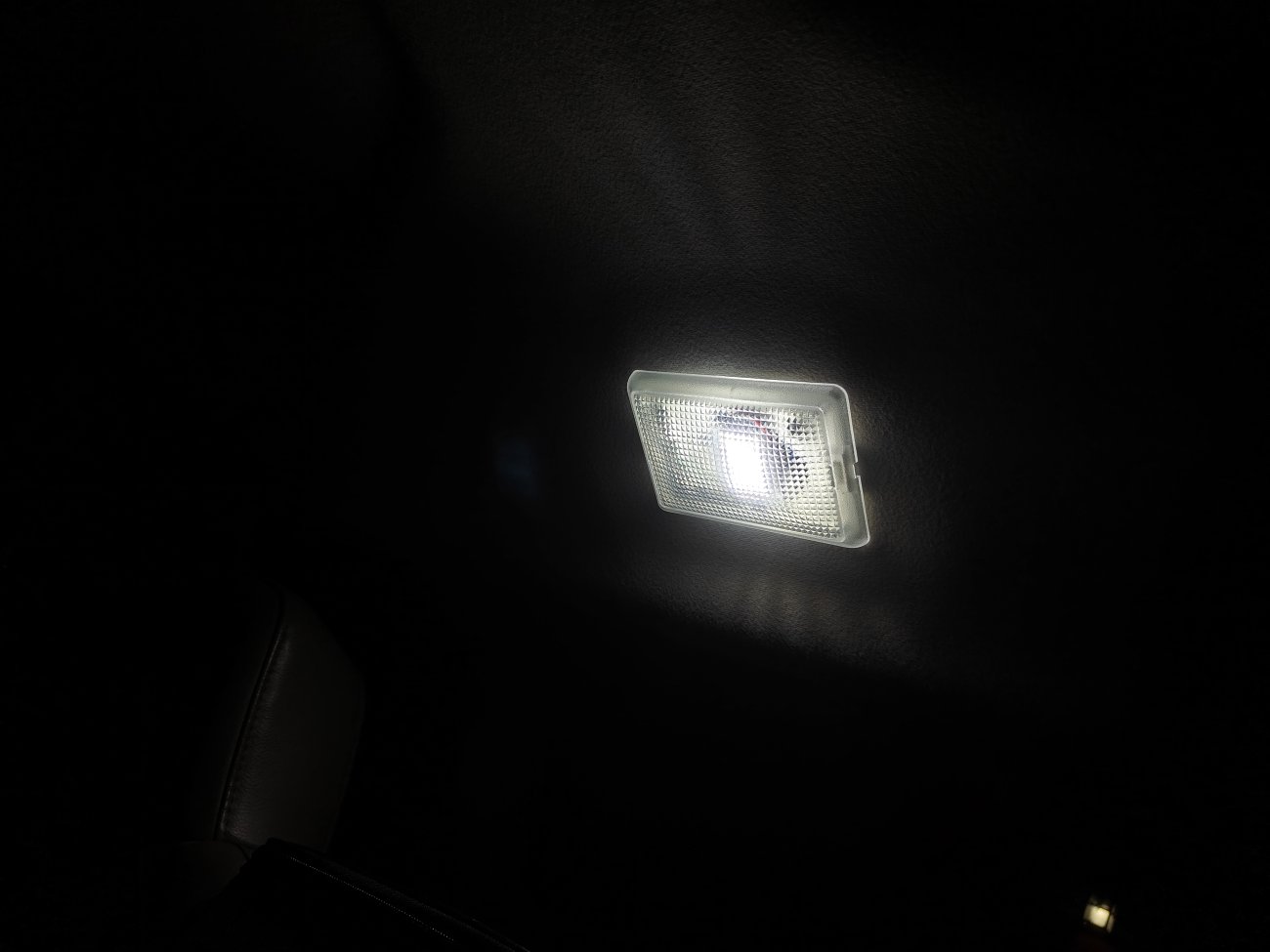

That looks like it works significantly better than mine. I Really need to replace it at some point.
This one is dirt cheap & works well. You just need to know which terminal is positive.
