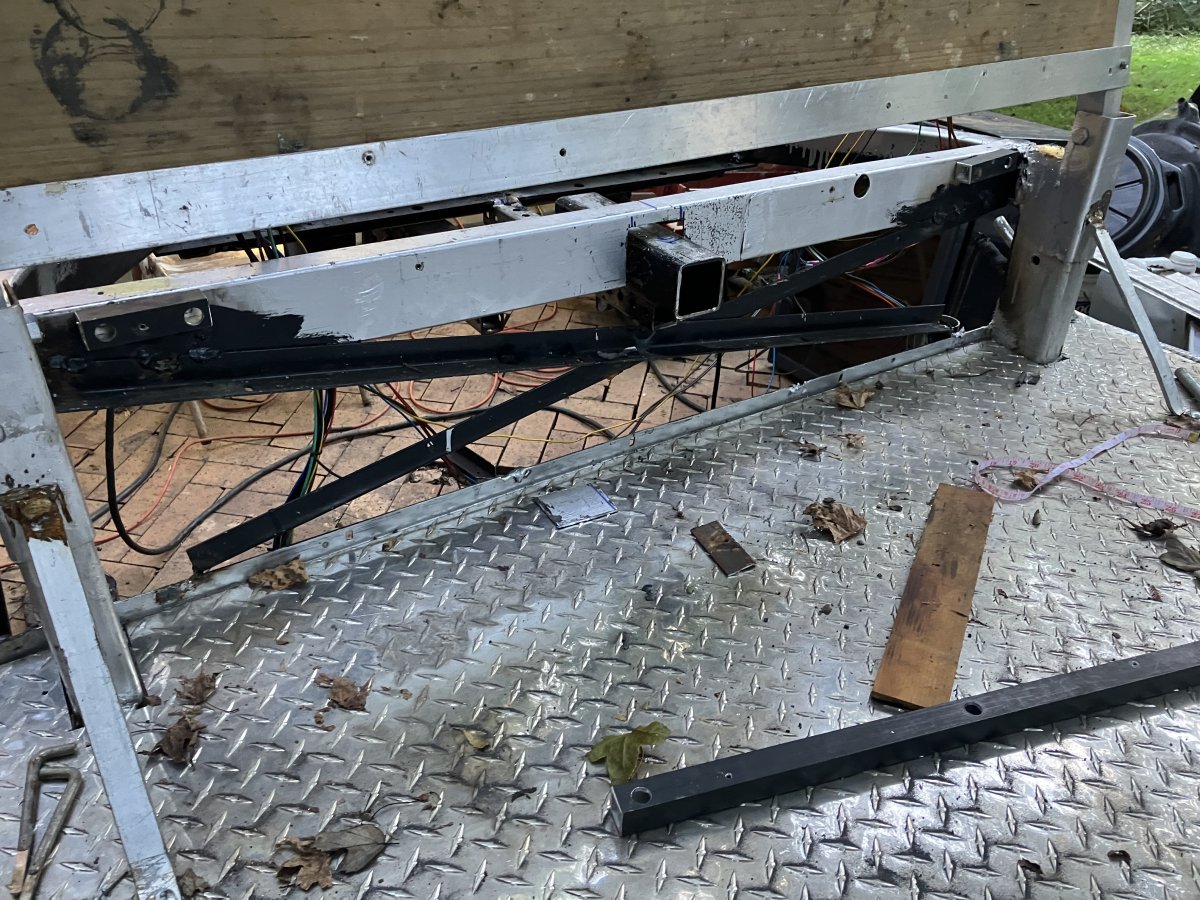

Some work on the RR trailer today. Since the 40th I already fixed the wiring under the upper deck and improved the upper deck support, and straightened the fender I bent at the 40th. Nothing big, but I’ve been doing a lot of figuring. I scratch my head a little bit for what was I thinking” when I finished that trailer less than 24 hours from when I showed up at the Nationals and drove a couple thousand miles on the maiden voyage. It’s a miracle I only had a couple of bearings go bad.
I discovered a slow leaking tire, drivers side of the forward axle, but haven’t done anything about it yet. I think I just need to deflate it, use some steel wool to clean up where the tire sits against the rim, and re-inflate it, hopefully without having to break the bead. I might take a little paint brush and brush a little silicone seal in that spot where the bead rests.
I figured out what I want to do with the tongue/pin in the front, but I wasn’t looking forward to tearing it apart and redoing it. Today, I cut the whole assembly off the bottom of the upper deck. It was half welded and half bolted, and it actually came down much easier than I thought it would (actually falling on my knee when I got the last weld cut, ouch!). Then I cut the pieces apart since I’m going to reuse everything. I also cut a 1/2” x 6” bar/plate from the scrap pile about 35 inches long w/30° beveled ends that I’m going to weld in the middle of the old A-frame neck of the trailer to hold the rear of the pin assembly. Ran out of daylight and it was time to feed Lincoln.
Perhaps a blessing in disguise. My welding skills were very rusty, and that pin assembly was one of the first things I did when I started building the trailer. When I cut it apart today, I didn’t really see anything that would concern me from a safety standpoint, but they were crappy welds. I know that the quality of my welds when I was finishing up the trailer were light-years from the welds I did on that critical pin assembly. So in a way, I’m happy I’m redoing it, and I’ll do a much better job on the welds. That way, when my upside down and backwards, coupler fails, the whole thing will sail into the woods in one piece.

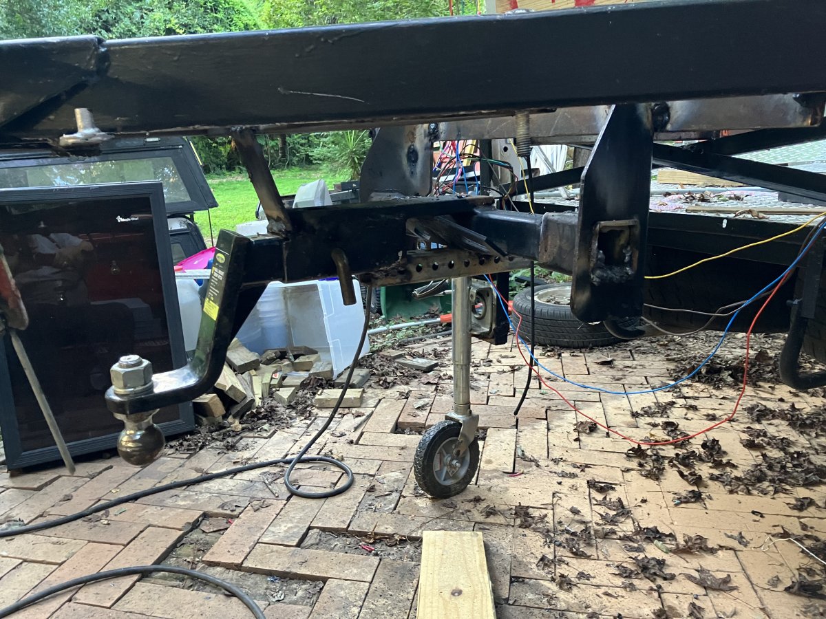

I spent the day redoing the pin assembly on the RR trailer. When I first did it, I half assed the engineering, but mostly I eye balled it, which is why I ended up dinging the fenders up. This time I three-quarter assed the engineering, but I made up a lot of templates and such to make sure the moving parts all stayed within certain radii.
From the center of the coupler, it’s 24 inches to the inside of the fenders on either side. I had that correct, but when I made the assembly, some of my brackets were hanging too low and violated that radius. So a primary design item was keeping everything that hangs down under the upper deck within a 22 inch circle for 2 inches clear all around
When I had it all put together the first time, and I set it on level ground, the front end of the trailer was about an inch and a half or 2 inches lower than the rear end of the trailer. It should have been the opposite, so when you load the trailer, it would sit level. Also, by raising up part of the trailer, it also improves clearance over the fenders.
The third item was simply that the transition from the upper deck to the lower deck was too far back, and the upper deck was too far back from the cab/toolbox of the truck. So in addition to keeping it all in the 22 inch radius, I also wanted to raise the upper deck about 3 inches, and move the pin back about a foot, which had the effect of moving the trailer about a foot forward over the truck. From the new pin location on the trailer to either corner of the upper deck is now 34 inches, and the distance from the coupler to the back of the toolbox is about 40 inches, which gives me 6 inches clear when turning. At least that’s the way I measured it.

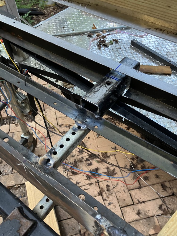

The other thing I mentioned, is from being rusty (me and my scrap metal), and having not welded much in about 15 or 20 years, when I took it apart, I realized some of my welds were worse than I thought.

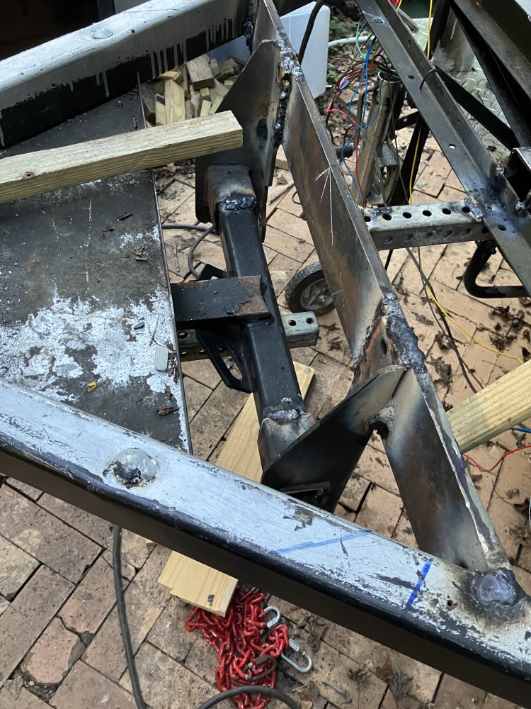

Soooo, yesterday I fabricated most of the pieces, and today I started putting it all together. I also added another feature. I put a receiver tube under the upper deck that extends through the step wall over the lower deck. It’s with the concept that if there was a trailer sitting on top of the trailer, I could drop it on a ball in that receiver, and only have to tie down the rear end. Don’t ask me why, it’s another vision and another project, but I added that receiver tube while I was doing all this work under the upper deck.
I did get it all together, but a lot of my welds were just to get it in place, and I have to go over all of them. I also need to add some stabilizing braces to the side, and to the rear, but my brain had shut down so that will happen when I go over the welds, to make sure they’re all in the proper radii.
it may look like this assembly is low, but remember that the fenders rise up about 8 inches above the coupler, so I’m hoping it will all look OK.

I realized one goof when I reviewed it all today when I was draining Lincoln. Originally, where the hitch slides in the receiver was directly underneath and welded to the A-frame of the trailer, taking all the weight, and the other supports just stabilized it to keep it from wiggling.
In my new rendition, the rear of the receiver mount is taking all the weight, and I don’t think I have enough vertical weight support/stabilization over the front of the receiver tube. I’ll be fixing that when I clean up the welds.
I also don’t think I ever mentioned that one thing that was intentional was to do this all with a hitch that had a 6 inch offset. That way when I get it all together, if I want to move the trailer up or down a few inches, I can simply swap out the receiver hitch to a different offset. I bet you I have a half dozen of them scattered around the garage floor….

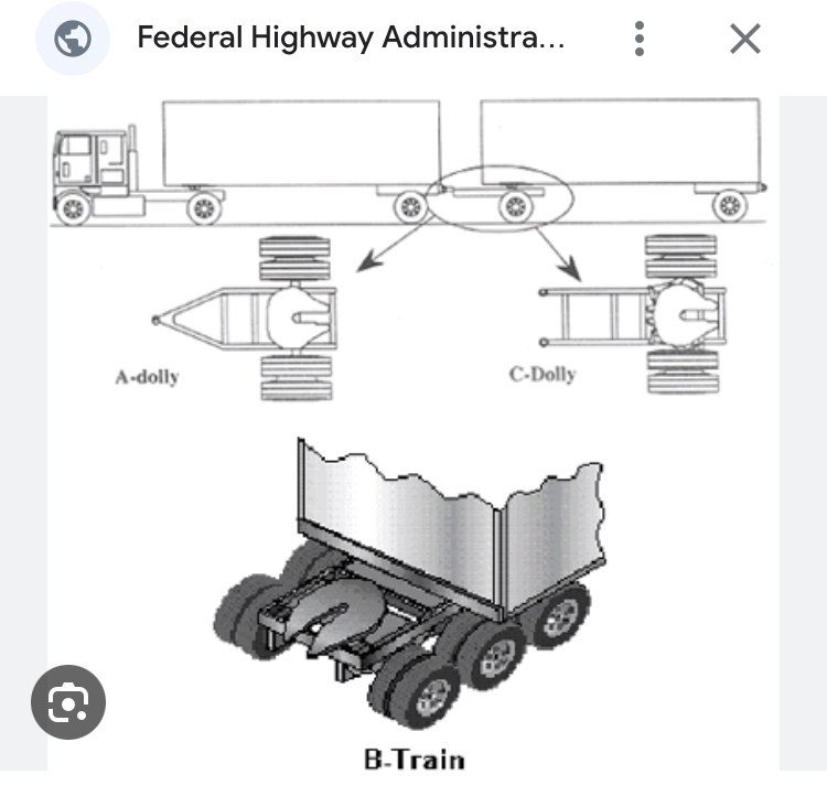

I was surfing the net for some ideas and parts, and I ran up on this:
Back when I was trying to explain what I was trying. to do, I was thinking it was closest to the “B train,“ but it may actually be closer to the “C train.“ Actually a hybrid, I guess.
I may be misunderstanding your intent. Are you trying to do something similar to the trailer that you did with the truck as far as a floating trailing axle?
No, but back when I was explaining what I was going to try to do I couldn’t find the picture. So when I stumbled up on this, I figured I’d post it.
My carriage assembly actually attaches to the truck in four points (but the carriage assembly does not support the truck frame). It pulls behind like a b-train, but then I’ve defeated it by using a ball socket instead of a a pin and wheel.
The B-train and C-train add tip over stability to the trailer in the sense that you would have to tip over the whole truck to tip the trailer. With the ball coupler, my trailer can tilt a while before it will actually start a torsion/twist pull on the truck.
Thanks for the visual and explanation again, I kinda had an idea of what you were talking about and now seeing that, I think I understand it better now
