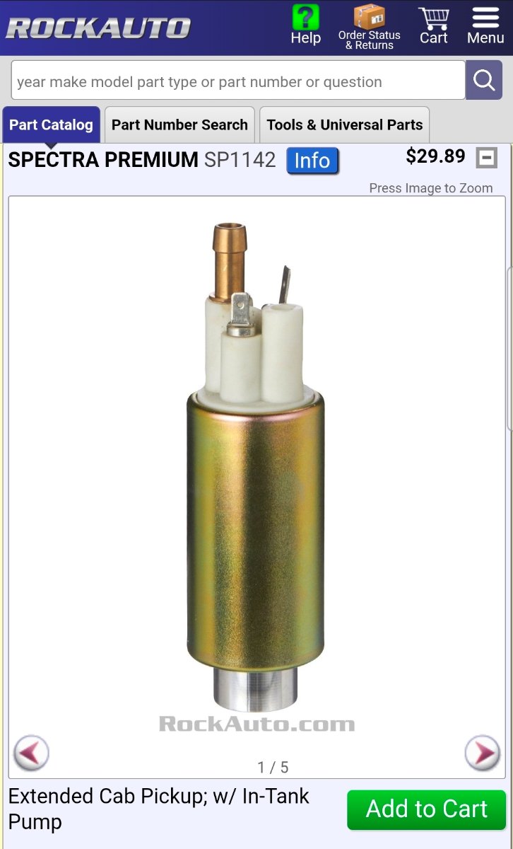

Could it be possible that I have a new faulty fuel pump?. I had purchased the fuel pump on Rock Auto. I didn't get the cheaper pump, but I got a midrange fuel pump. I'm not sure if the original ECU was replaced, so that's what im thinking could be the issue. However I do have a backup ECU I purchased on Rock Auto few years back, just in case I needed to replace it. Any ideas what to check. Thanks
1993 Ranger XLT SC 4.0
Question: Can new fuel pumps crap out and or run sporadically? I never came across this before, that's why I'm asking.
This is the pump I purchased.
