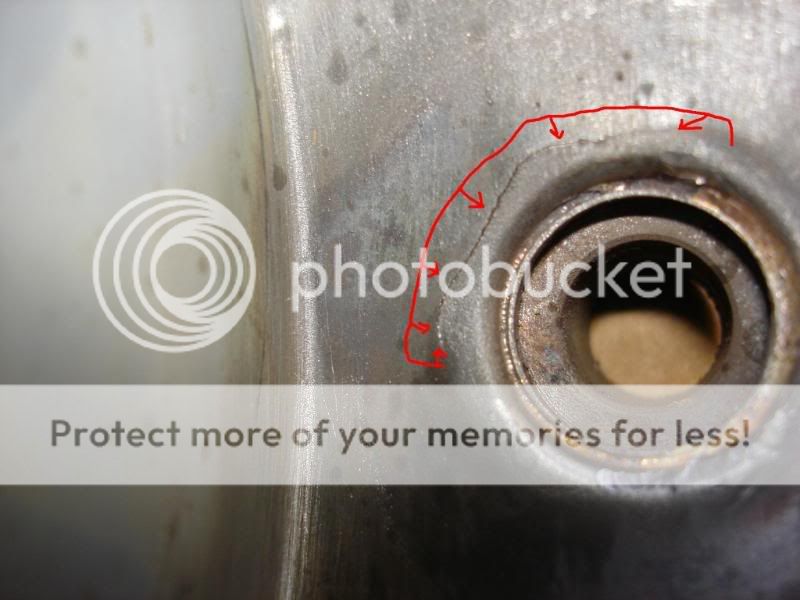

Well after looking at it closer during the daylight I finally figured out what my steering problem hauting me for months was........ I had cracked the can on the neck of the pump at the inlet. Hind sight is 20/20 right? Yep it is.
It didnt take me long to realize my huge mistake. Looking back I see how stupid I was, but sometimes you just cant think of everything. The problem was that I had the pump ofcourse mounted to the motor, the resevoir was mounted to the fenderwall/core support, with a short stiff big hose running to the neck of the pump the high torque of the motor was just working the neck of the pump back and forth until it cracked. The big problem was it would not show a crack or leak fluid until I hit High RPMs/torque then it would open just enough to suck air but not really leak any fluid, because of the sucking of the pump.

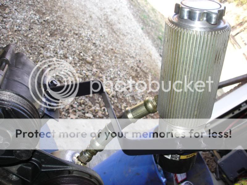

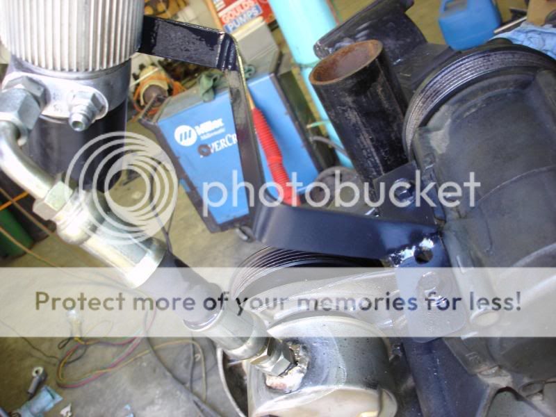

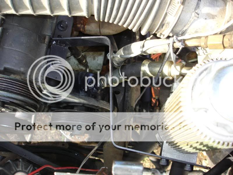

I figured out real quick that I needed to do something different so I decided to make a bracket for the resevoir so that it could torque with the motor and the pump.

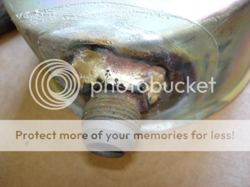

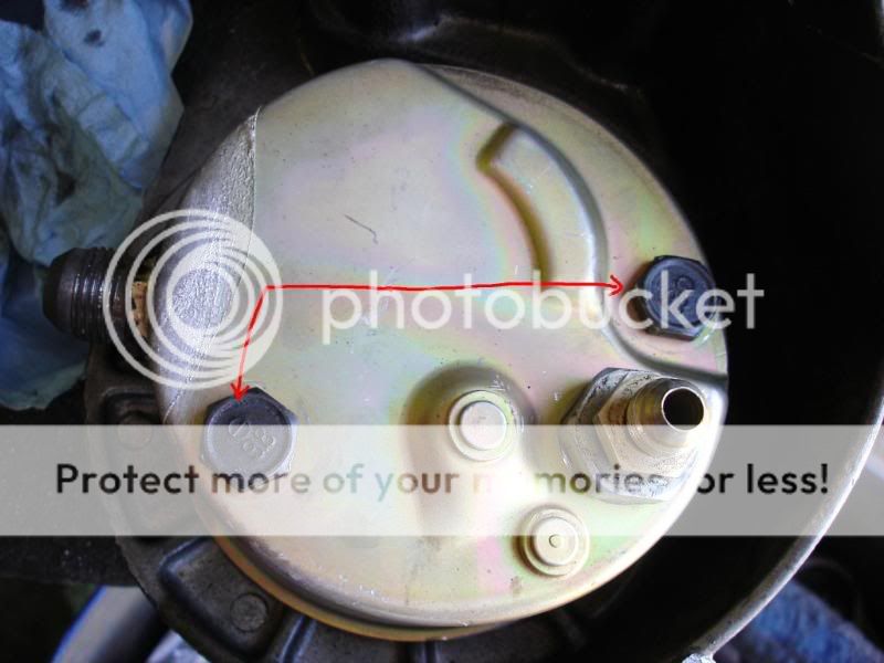

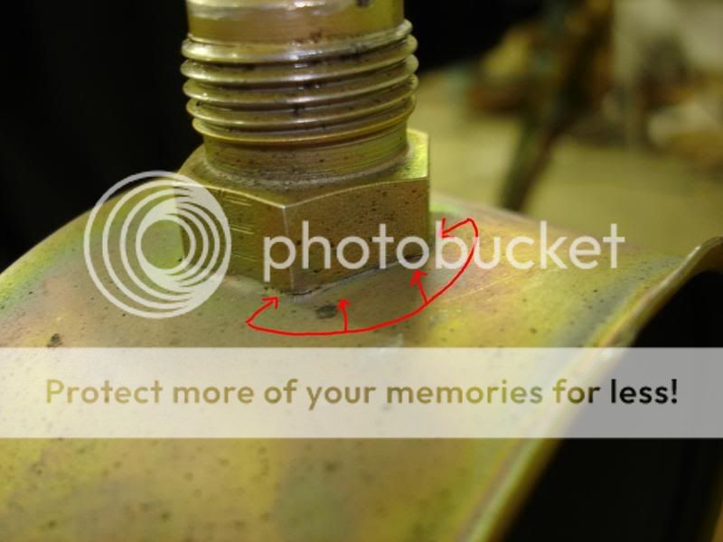

Here is the hair line crack.....................
A veiw from the inside...............

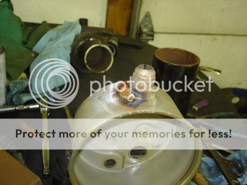

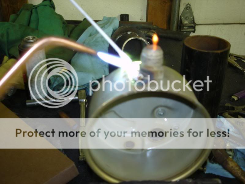

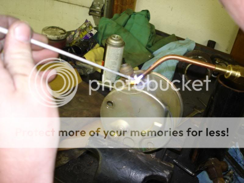

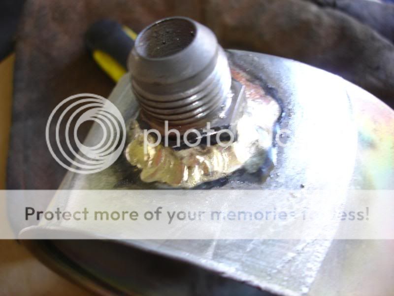

Here was my solution........ Braze the neck back together and make it stronger.....
First I had to remove the can......

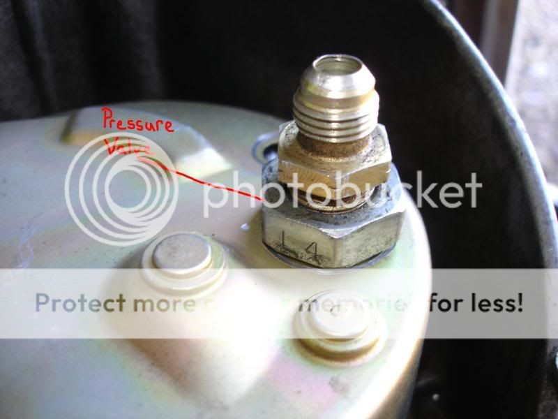

First take out the pressure valve........
Next the two can bolts......

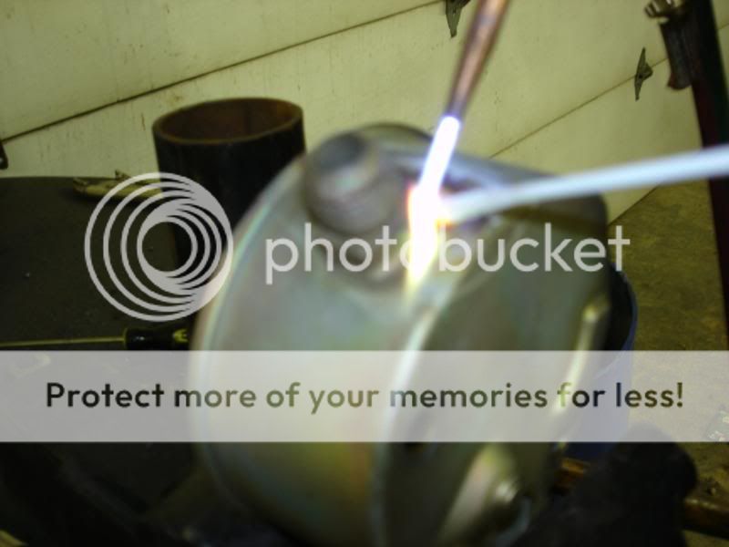

Then start the brazing process........

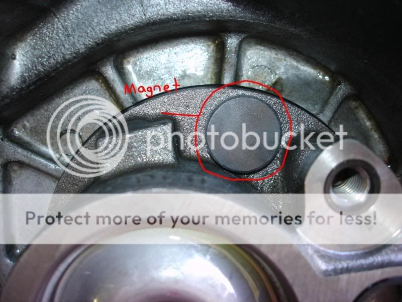

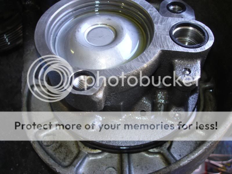

Next I inspected the pump and made sure the shaving collecting magnet didnt have any shavings or debree....

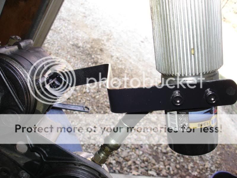

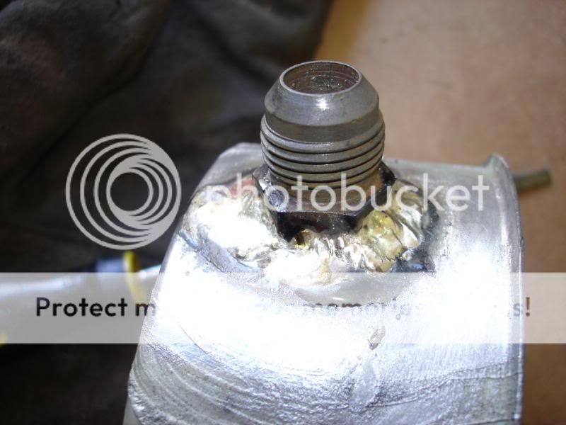

Then I reinstalled the can in reverse order and now it is on to the problem of making it flex with the motor instead of fighting against it...
I made a new bracket coming off of the air conditioner pump......
And finally good as new :thumby:
