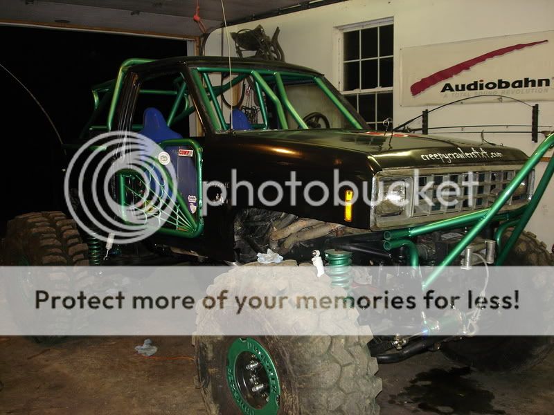

The Punisher

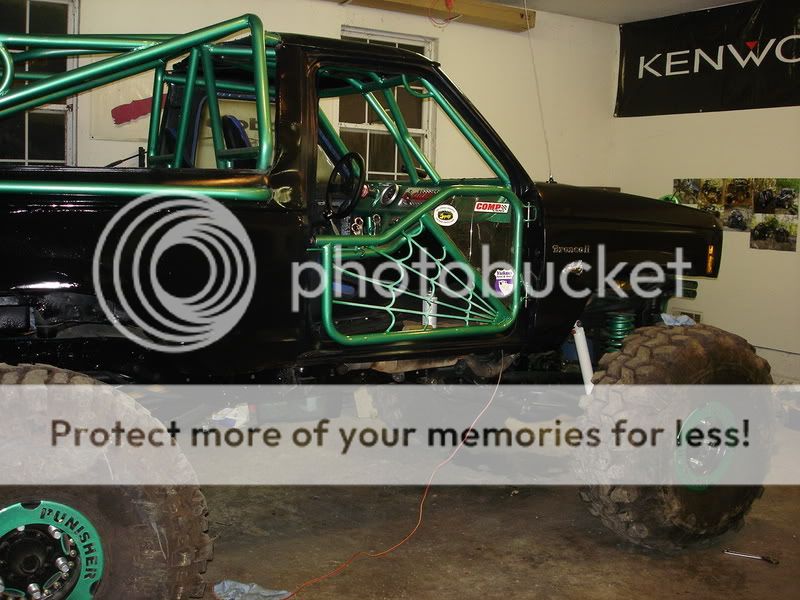

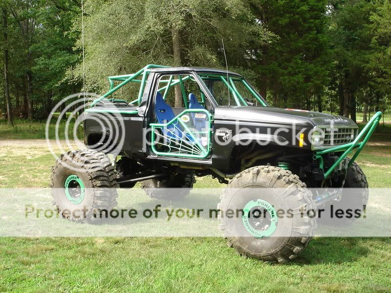

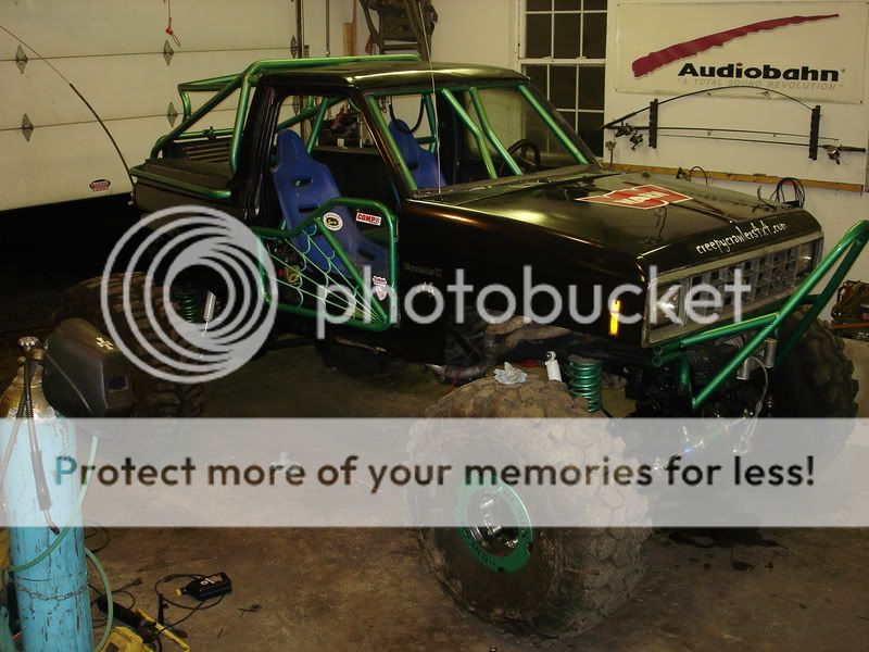

Got her all painted up ready for the date with destiny :D
Building a Rockwell......finally

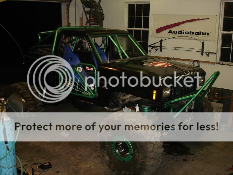

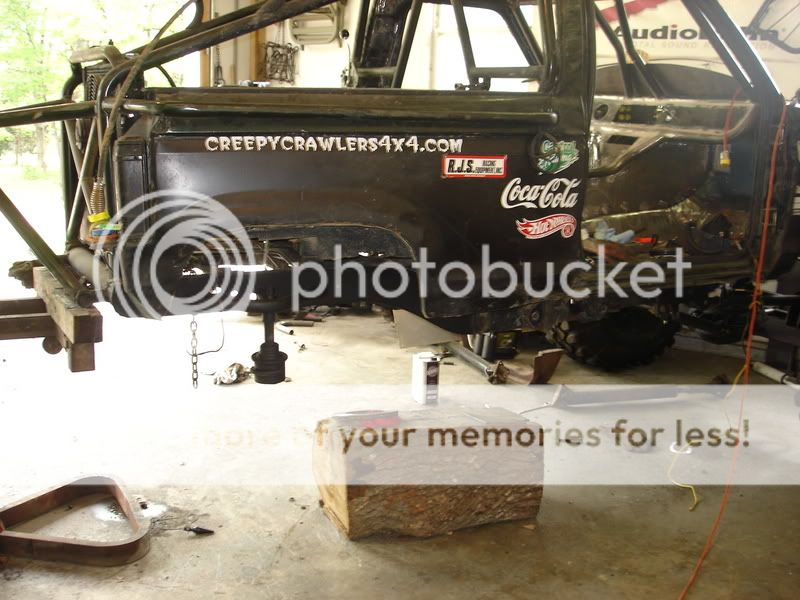

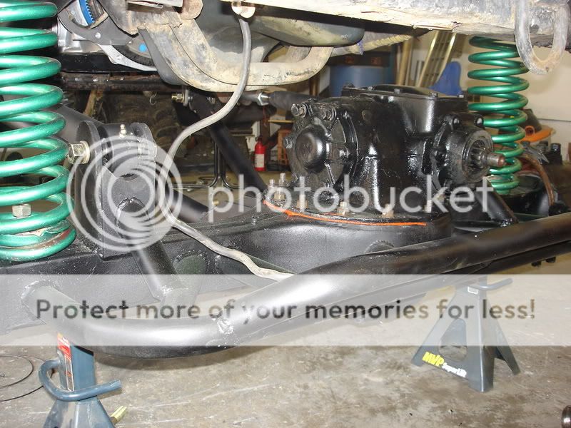

got it under the front coils, now the install of the components.

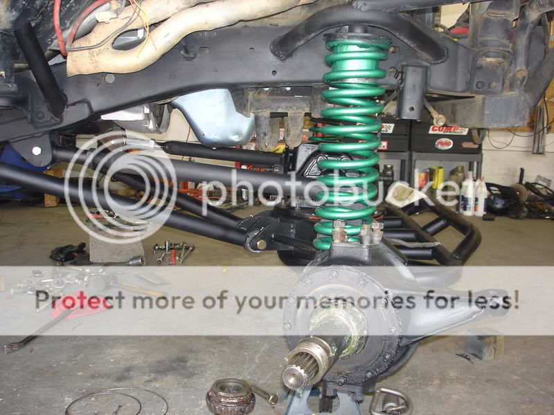

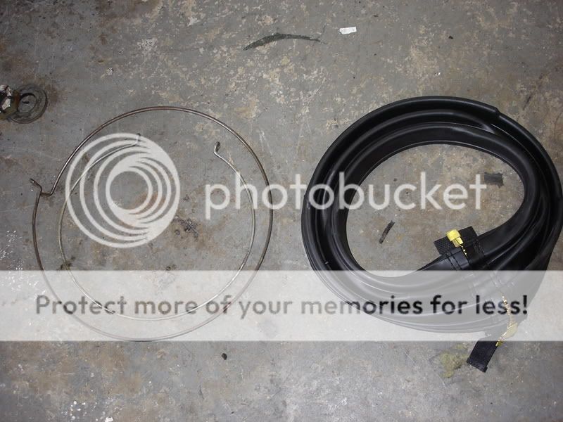

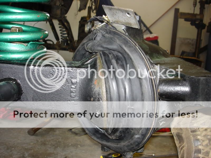

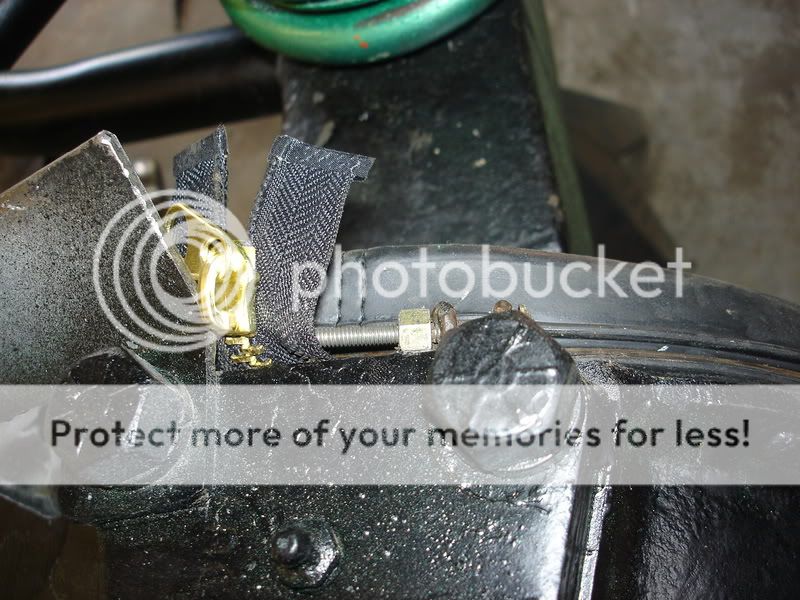

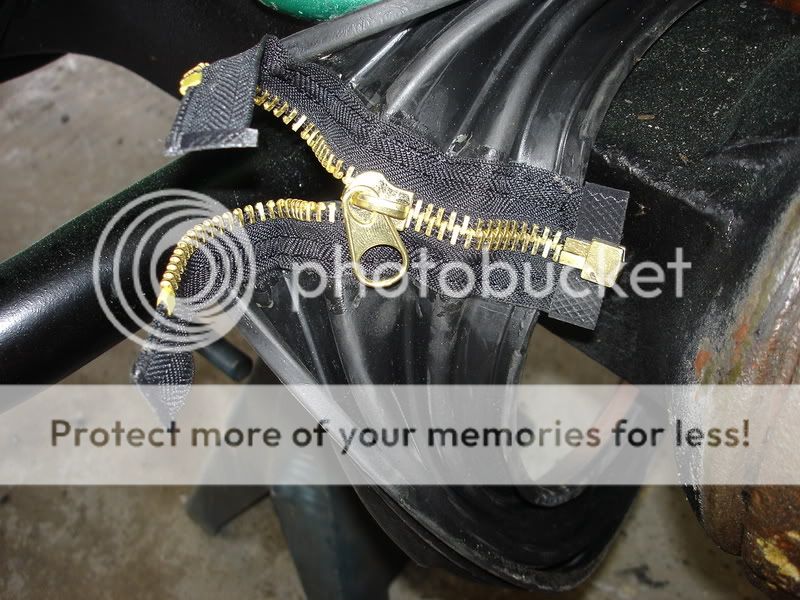

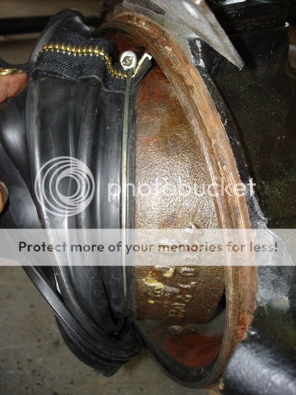

First the new boots:
Unzip the old ones and undo the clamps, then zip the new ones on and reinstall the clamps, it is harder then it looks, but at the same time not to bad.

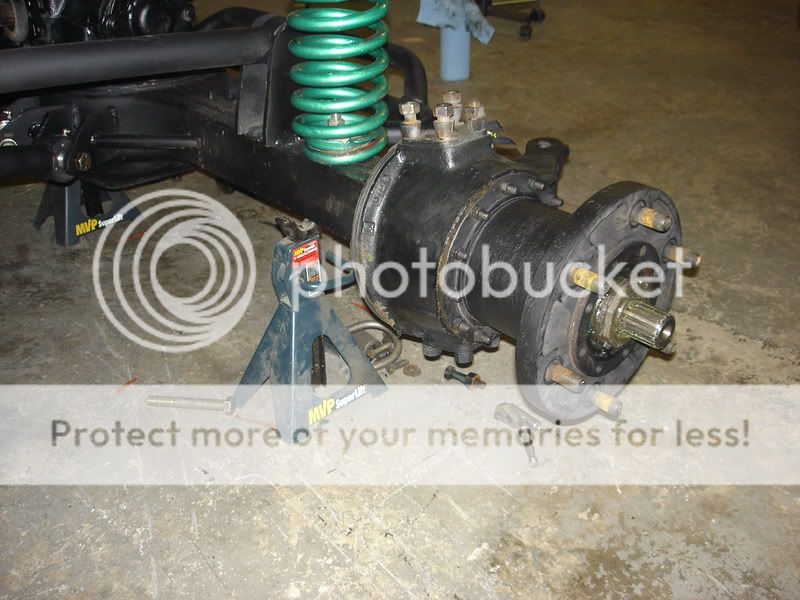

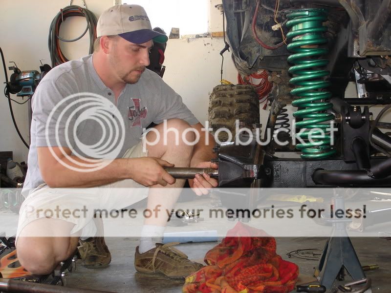

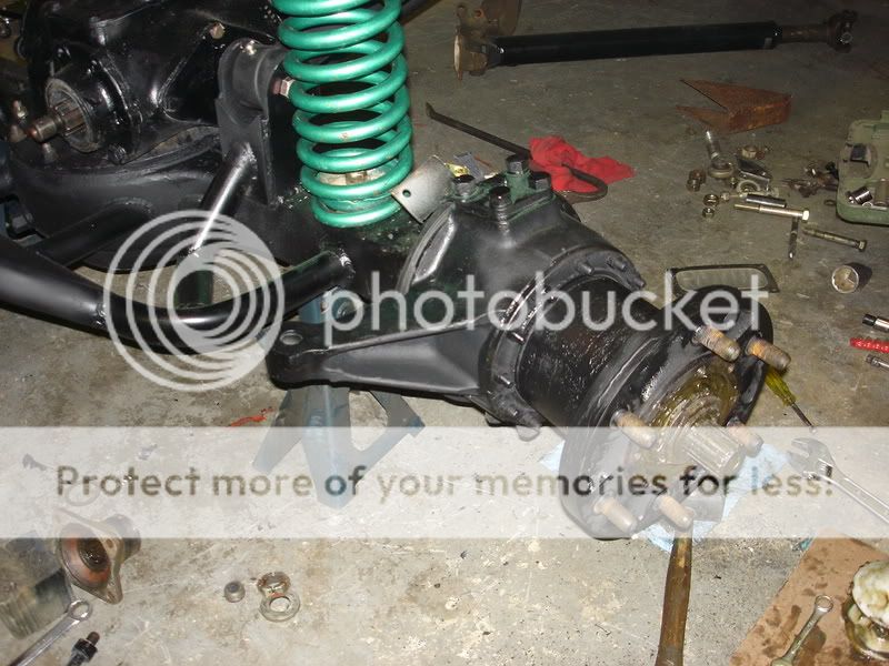

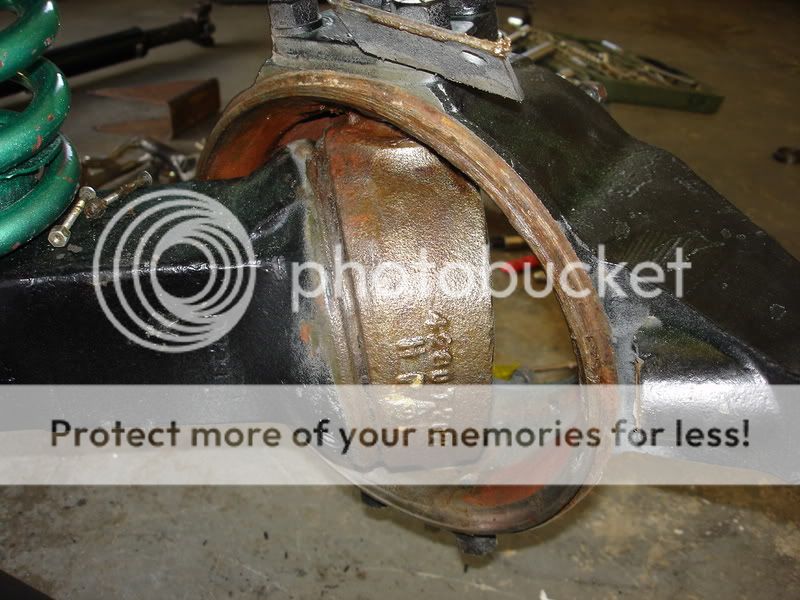

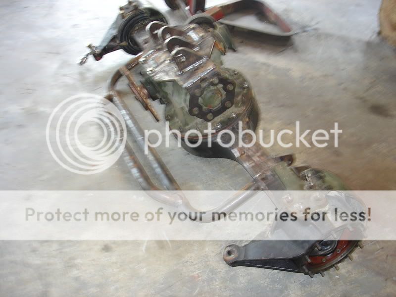

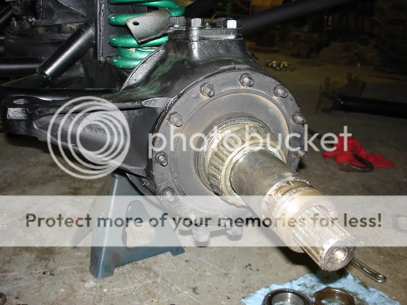

Next installing the axles, it is pretty much like any straight axle dana axle from here out.
Bolt on the spindles

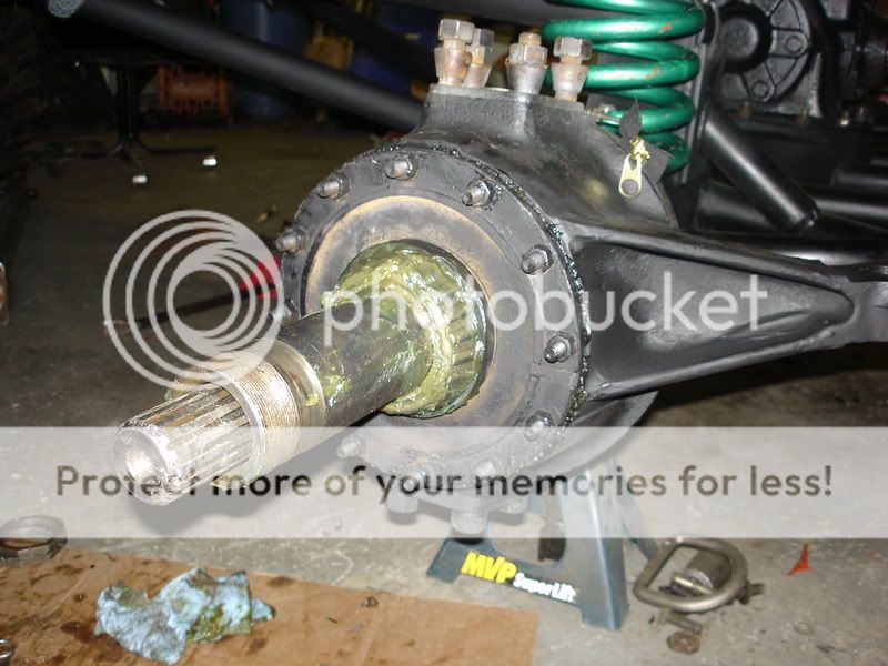

As you can see it has the standard looking spindle with the two big bub bearings.

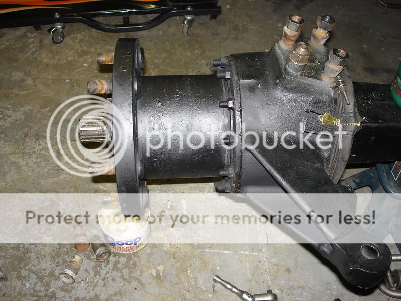

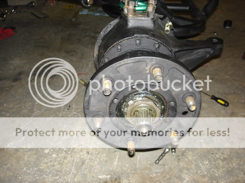

Next the hub goes on, I won't do the drive flanges yet but they go on where the lockout normally would.

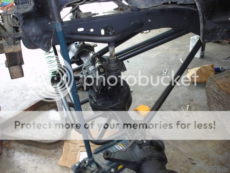

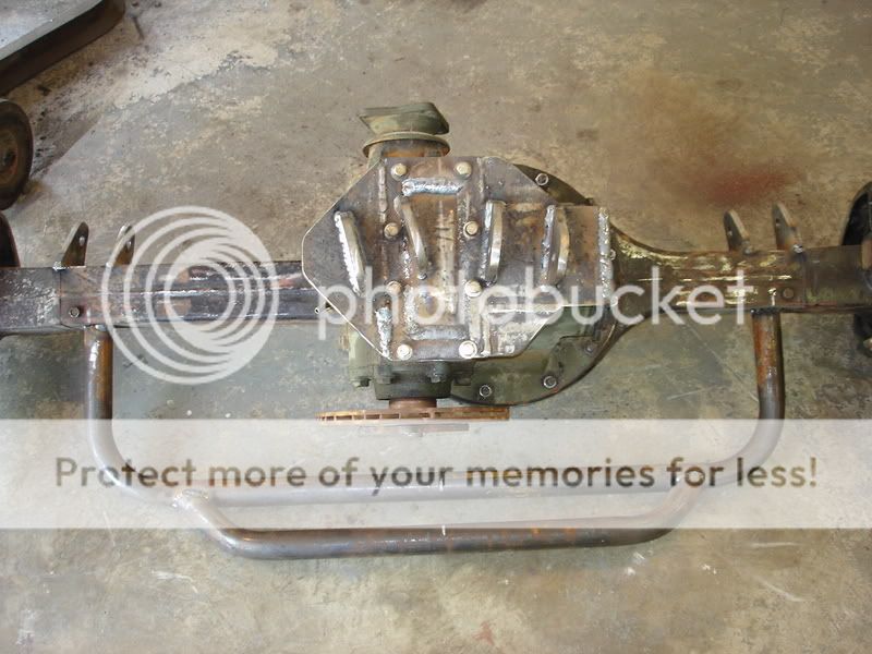

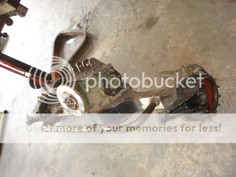

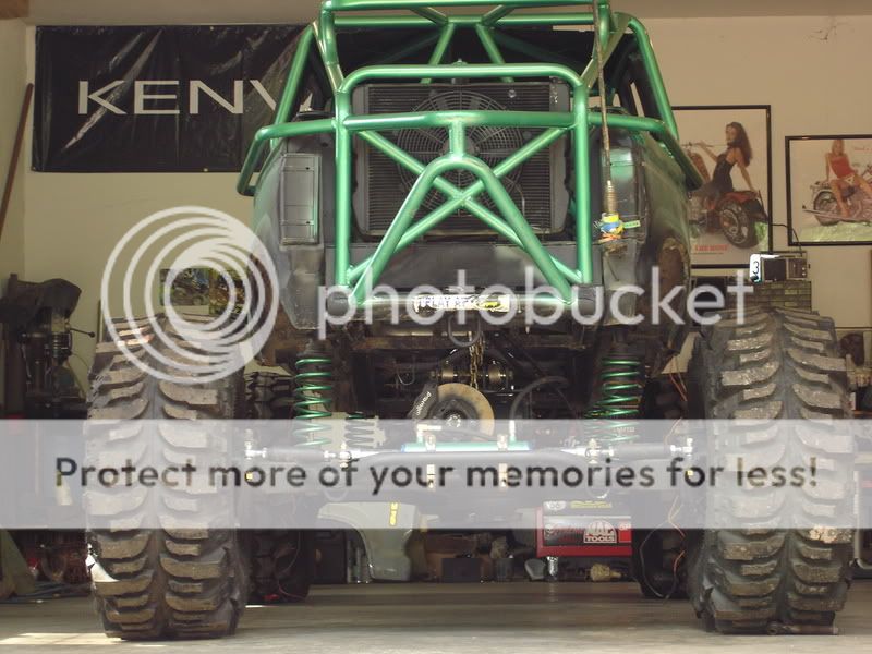

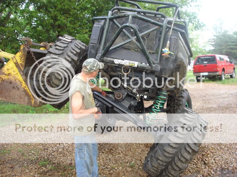

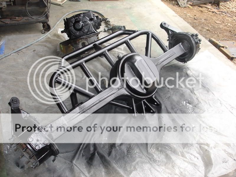

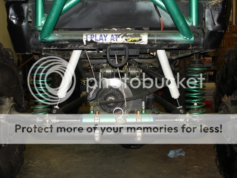

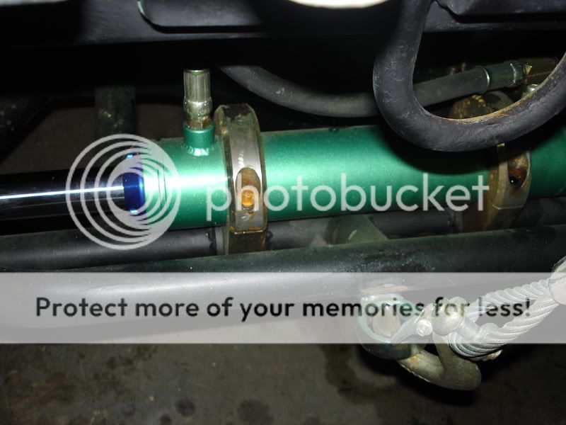

Ok got some done here is the rearend out of the rig and getting it ready for cylinder and mounting

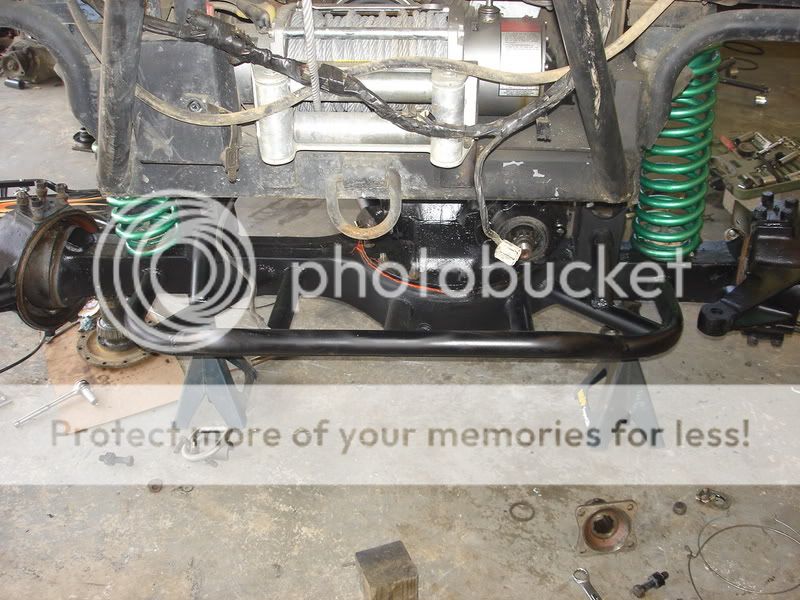

Got it under there.
And Closer.......

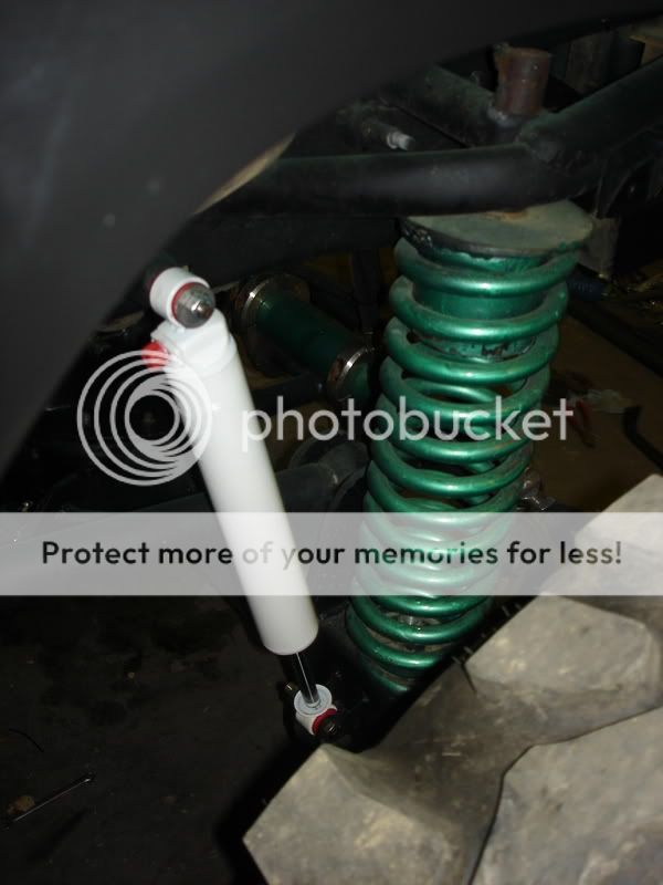

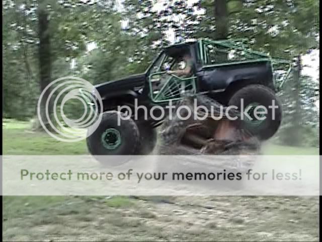

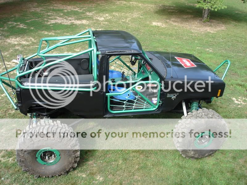

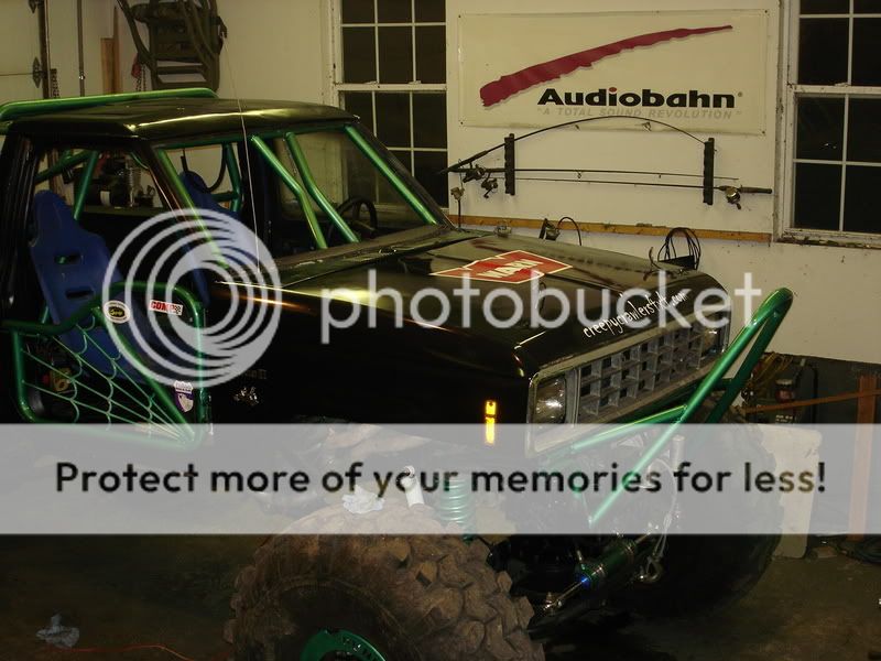

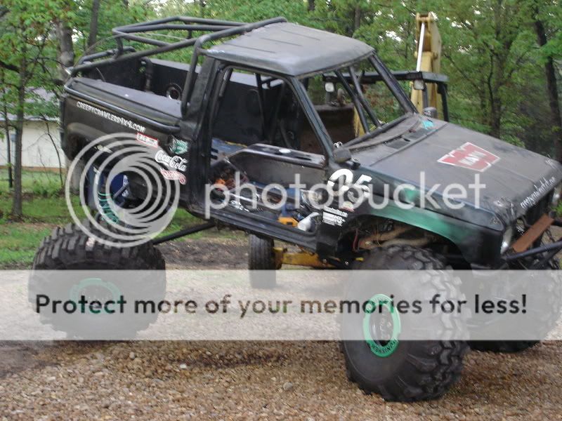

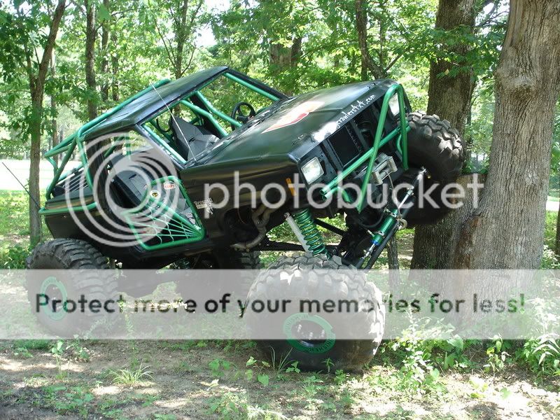

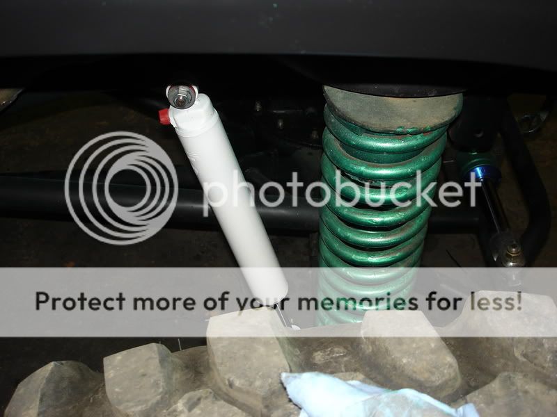

Got the shocks on, took it for a drive and slung a little paint. I do have a few issues to address nothing real serious but enough to keep from being done at the moment anyways here are some pics.
Here is my "hook" for the winch sinch down :D
Painted

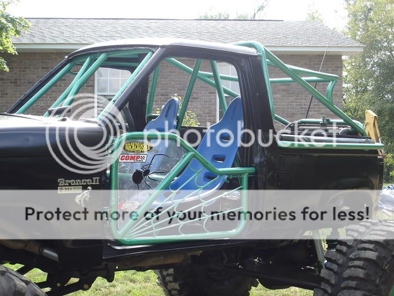

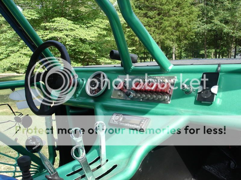

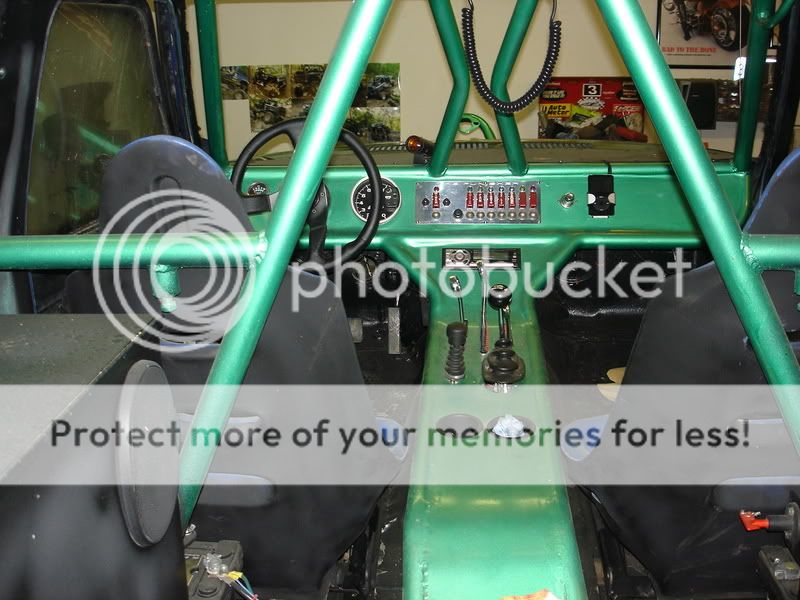

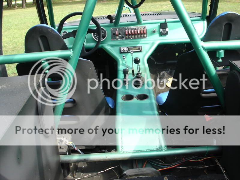

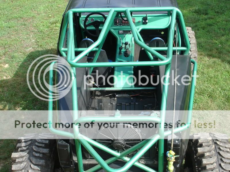

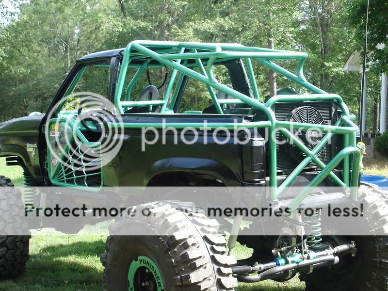

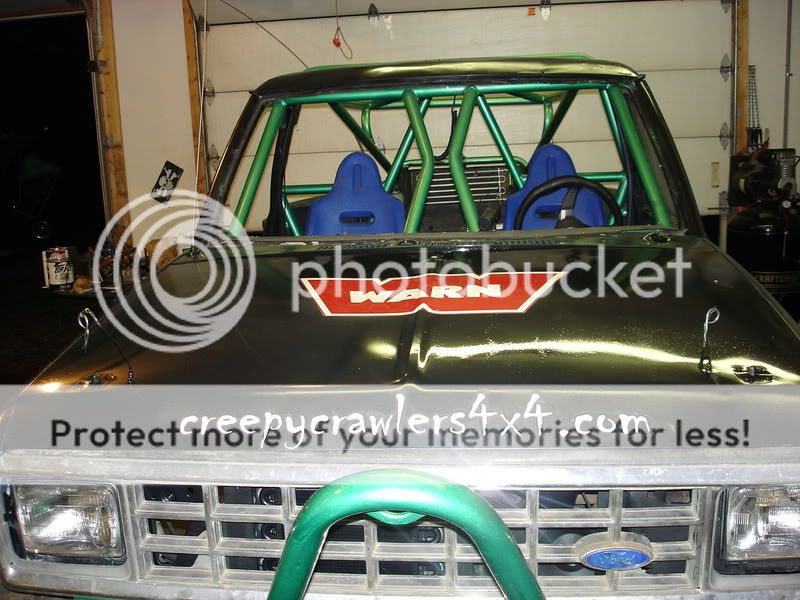

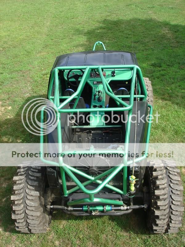

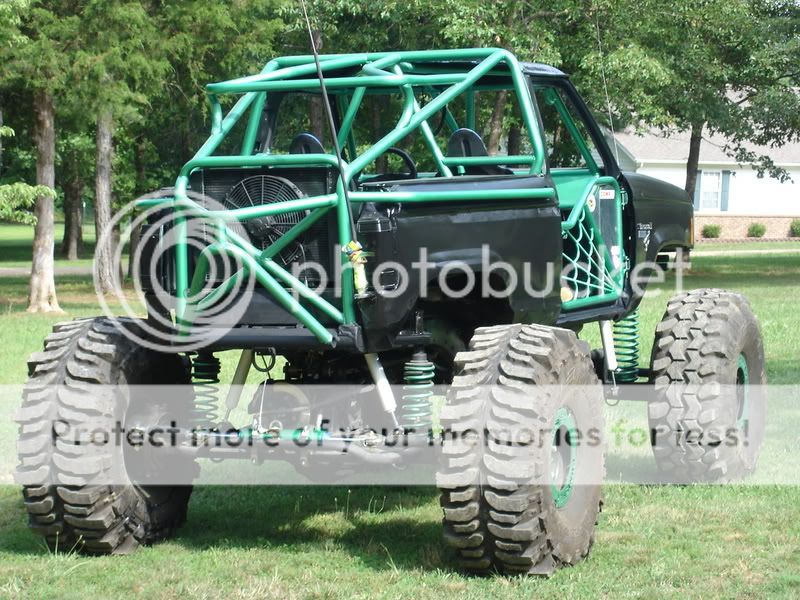

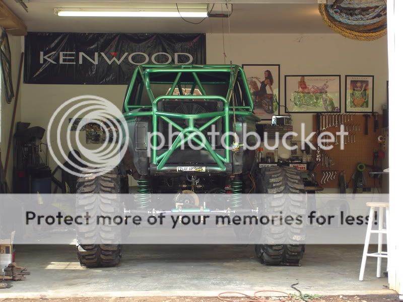

A shot from the back of the finished interior.

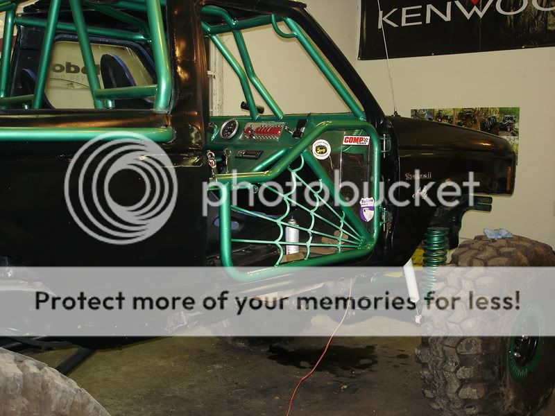

Here are somemore pics for you guys.

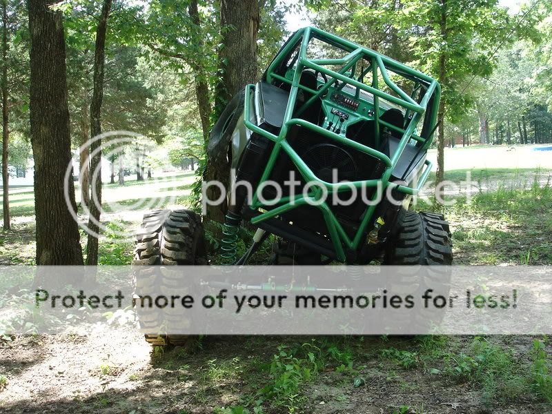

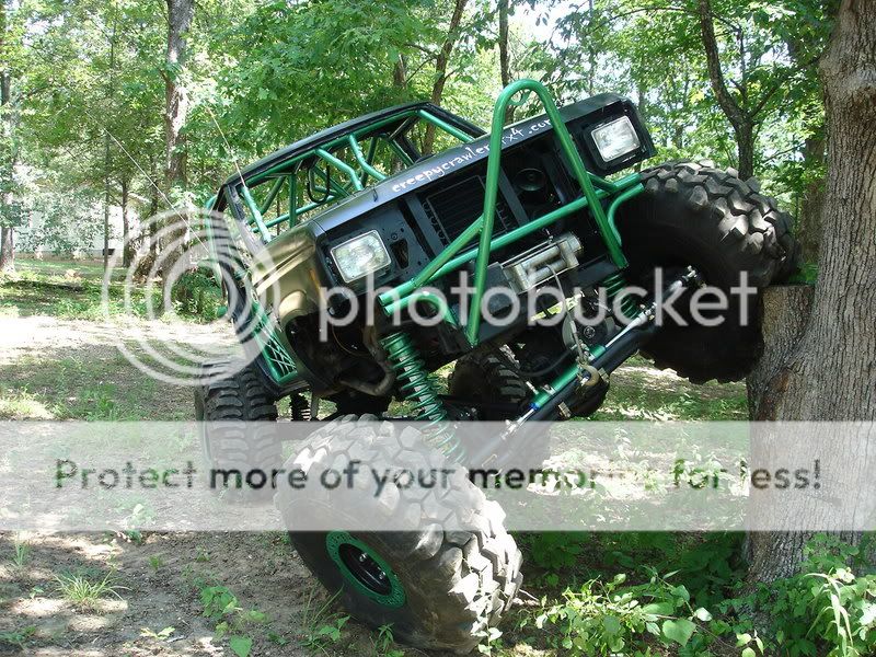

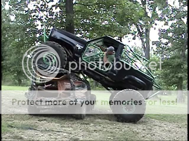

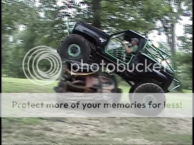

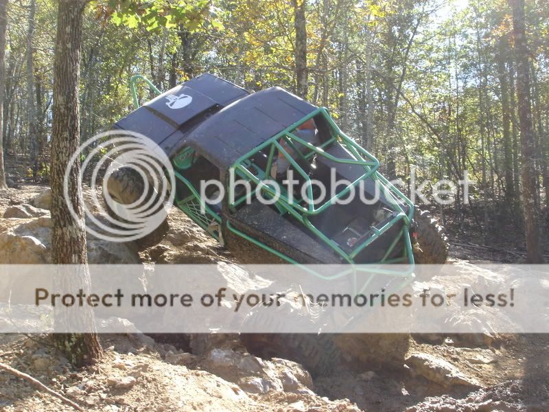

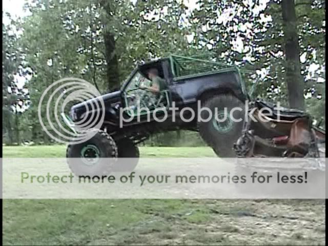

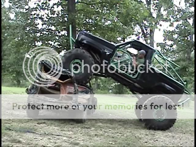

Did a little flex testing today.
