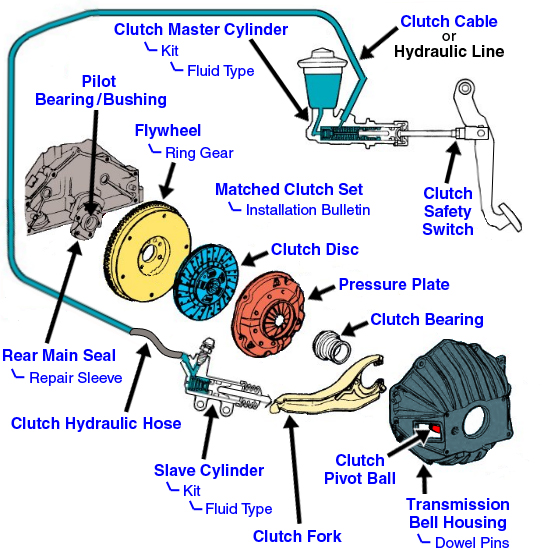

Well, transmission's out. Pictures will come in a couple days. Clutch appears to be installed right, but the sleeve between the fork and spring seem to be missing. But I don't really know what I'm looking at, either.

Okay, much research later I found this image. If the ranger's layout is similar to this, the goofs forgot to put a throwout bearing in it! :icon_twisted:
1.image

There's the trans. Something's missing, isn't it...

There is a pilot bearing in it, and there's a new-looking one I found in the floor board.
Just thew the trans in tonight, the throw-out engages as it should! Put the bellhousing and cross-member bolts in hand-tight, and drained the t-case and prepped it for install. That's all I had time for. Work has me traveling for the next week or so, but it's closer than it's ever been to driving up the street!
