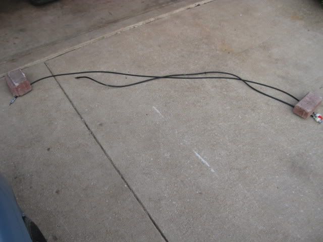

Aerostar Speedometer Cable Swap
Not much to say here, with the additional length of the doubler, the stock cable wouldn’t reach anymore. So it was suggested to use a cable from a 90’s Aerostar .​
Side by side, the Aerostar cable is about 15" longer than the Extra Cab speedometer cable:

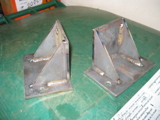

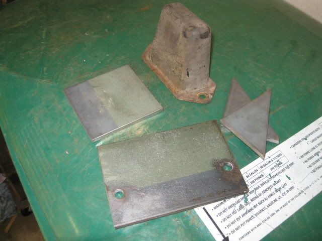

Rear Bump Stops
The rear bumps are using the same style of bump stop that I have in the front. These came from the rear of Isuzu Rodeo/Honda Passport’s.​
I lopped off some ¼" Plate:
The Lone Ranger – Kage’s ’94 X-Cab Leaf SAS and Bed Bob

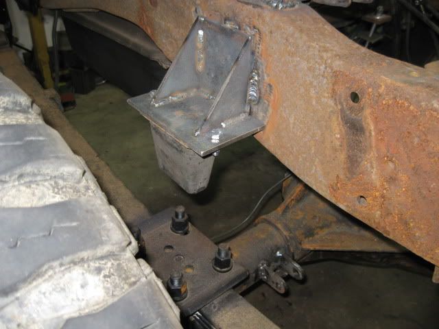

Burned it together:
And tacked it in place (Need to flex it out before burning them in all the way). As they sit, they’re about 5.5" above the spring plate:

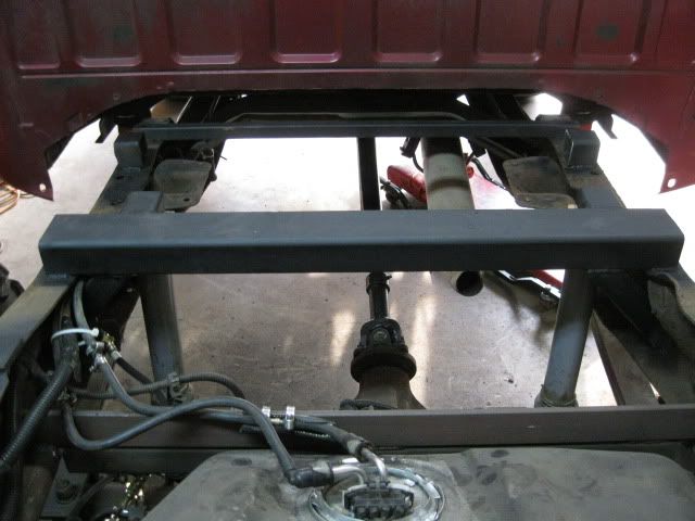

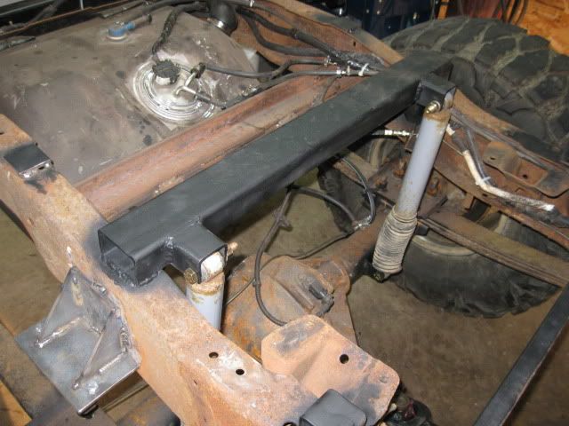

Rear Shocks
The axle shock mounts came as a part of Ruff Stuff’s "Simple Dana 60/70" swap kit. I made the upper mounts using the same 2" tube I had in the front:

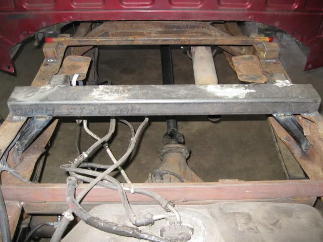

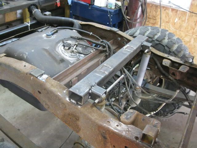

On the frame side, I used a piece of 2"x3"x1/4" wall tube to go across the frame rails. Here it is tacked on checking the mounting locations:
Burned home with some gussets:
Shocks installed:
Holy overkill on the shock mounts. That'll work though. Did you flex the rear to make sure your shocks have enough travel in that orientation?
Going by Tape measure, they should have enough travel. The truck is going to make the commute to work tomorrow or Friday so I'll get to flex it out and check everything over at that point.
Part of the reason for going as beefy as I did is that I'm lacking cross bracing in the rear. So this will help stiffen things up. The gusset also ties in behind where the bumpstops live, so that should help keep the frame from twisting in that spot when I hit the bumps.
