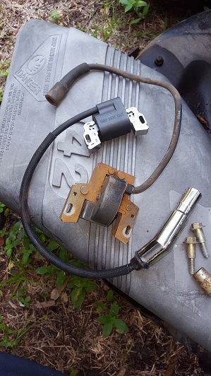

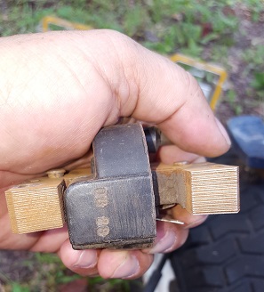

I tried cross referenceing the numbers too. nothing. So i pulled the old one for a side by side comparison and they are very different. The bolt holes where dead on point tho.
28027
28030

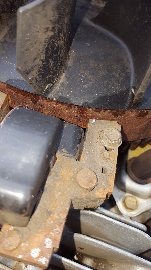

the old one was very rusty and so was the contact surface on the flywheel.
28028
28029
so after a wire wheel treatment for that and some emery paper on the magneto. I replaced the old one, set the gap and....
nothing.
dead battery.
So, after a quick charge.
BAM. ?
Started right up and runs smoother than ever and I mowed the whole yard. Now to see the return policy on unused and possibly wrong parts. IF it is the right part i might just keep it for future use, but I'm cheap and can clean rust for free.?

Well after several attempts at trying to figure out if I received the correct part or not I guess I'll just keep the Magneto and hope it works, if I ever need it. Called the company that I ordered it from and they gave me B&S's #, the girl on the phone knew NOTHING, and offered to send me a PDF of their parts list. Hell yeah, send me that. Got a PDF of a power washer that I do not own. LOL SMH FML??? After talking with the people at EReplacements.com(?) I think I have the right part, just a newer version. She gave me a list of part#'s that are replaced with the one they sent me, the problem is, I don't have a part # for the original Magneto. B&S, again, had no idea about anything. So, I have 45 days from purchase date to let them know if I want to return it and get refunded, minus shipping. For me that is more trouble than its worth, so Ill just keep the Magneto on the shelf, until I finally need it, right next to the solenoid that is still in the package.
