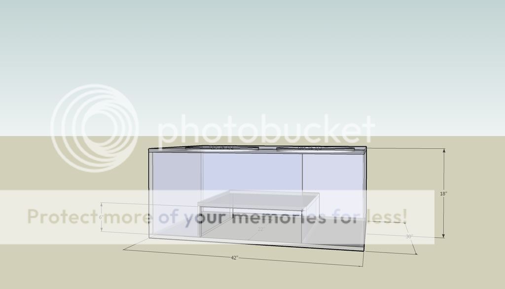

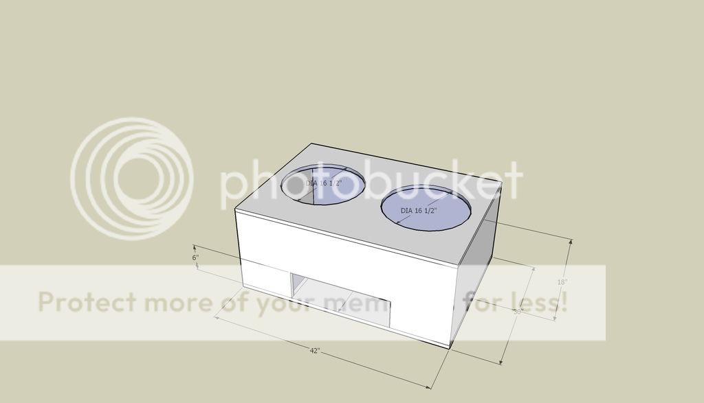

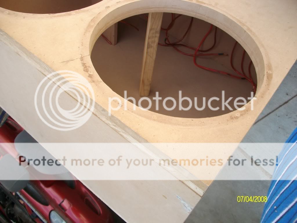

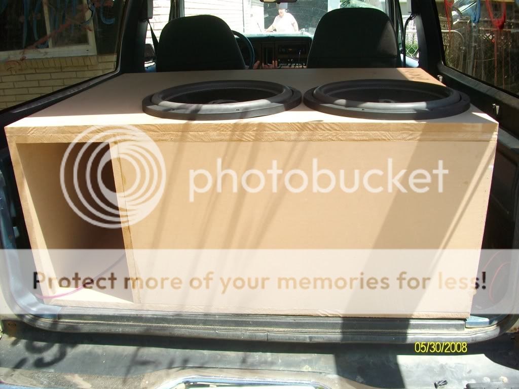

Lost pics but it started out with a transmission line enclosure tuned to 38hz.

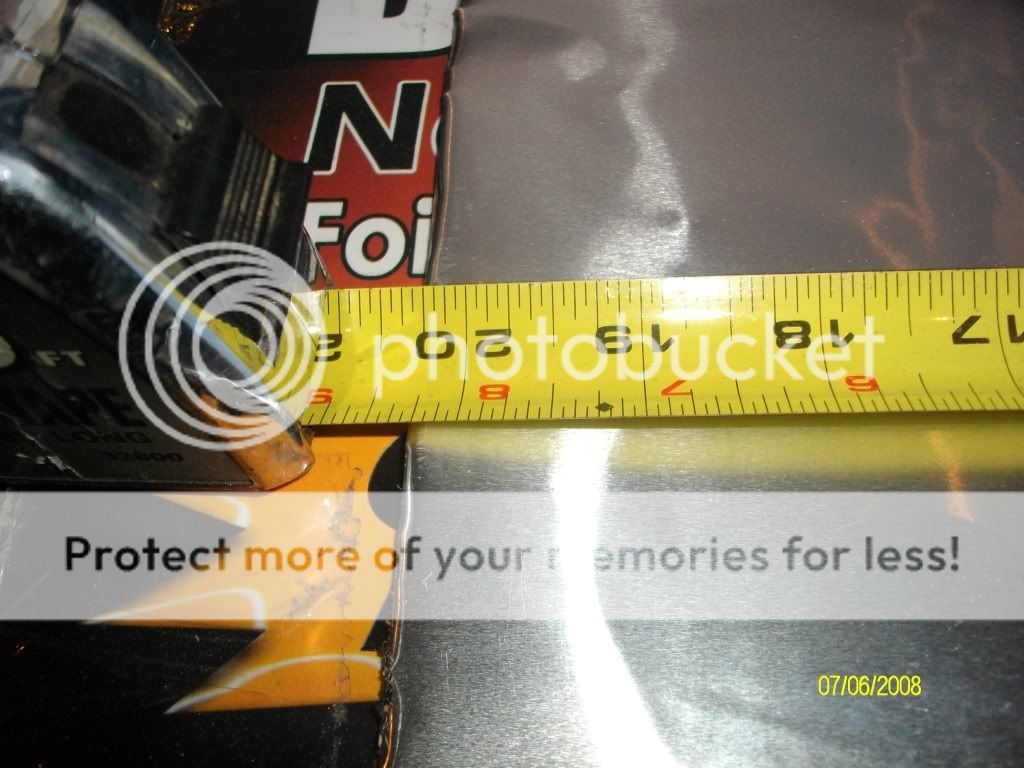

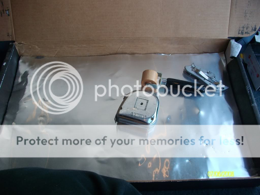

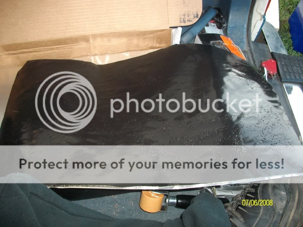

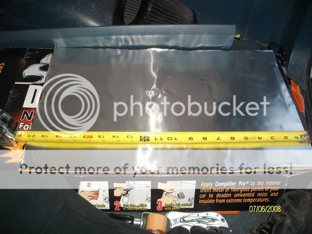

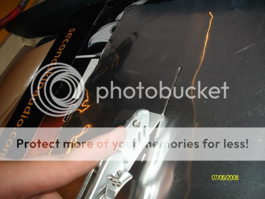

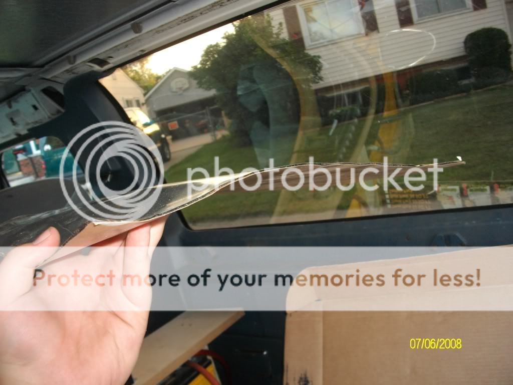

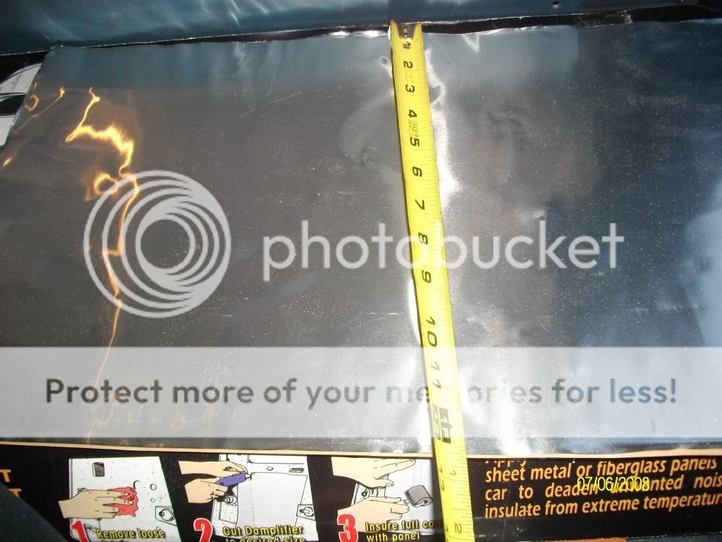

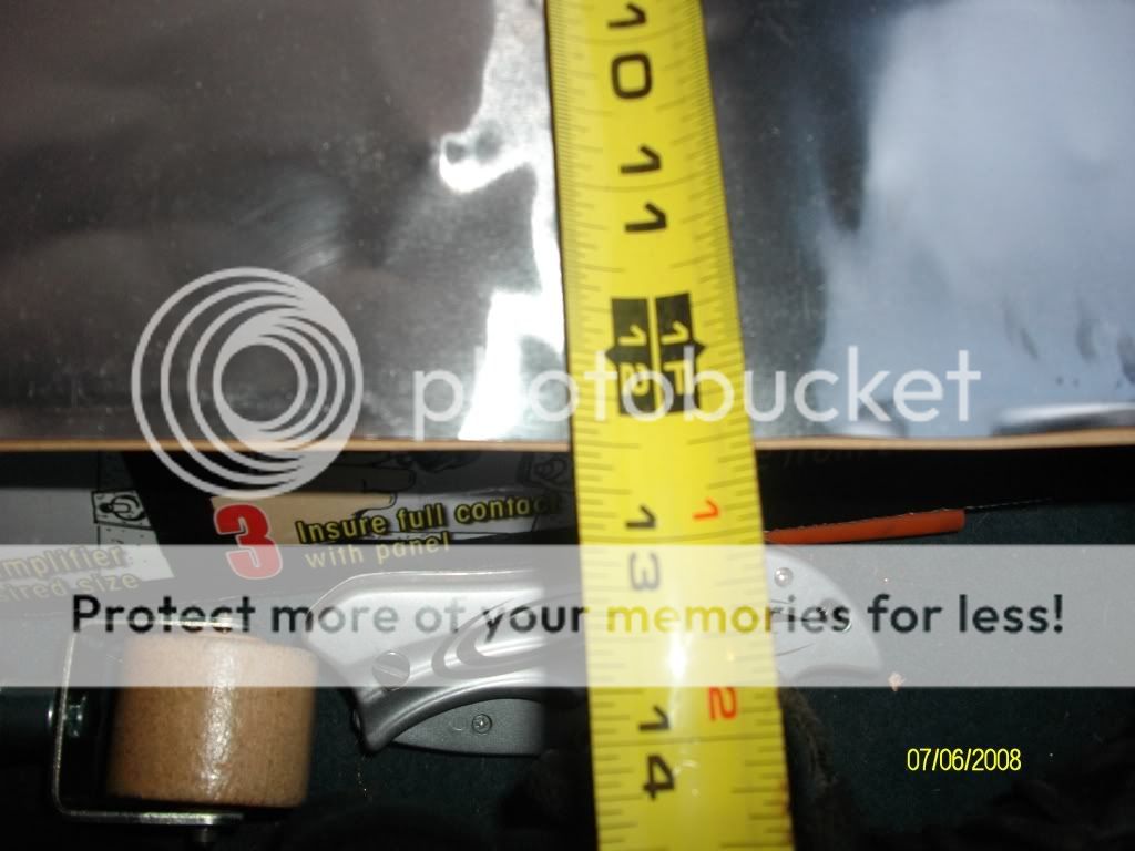

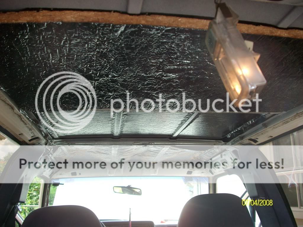

Won an awesome promotion by Second Skin audio and won 13 sq/ft of Damplifier Pro.
Stuff is amazing and eliminated my horrible rattle I had from my roof.
I highly recommend this product.

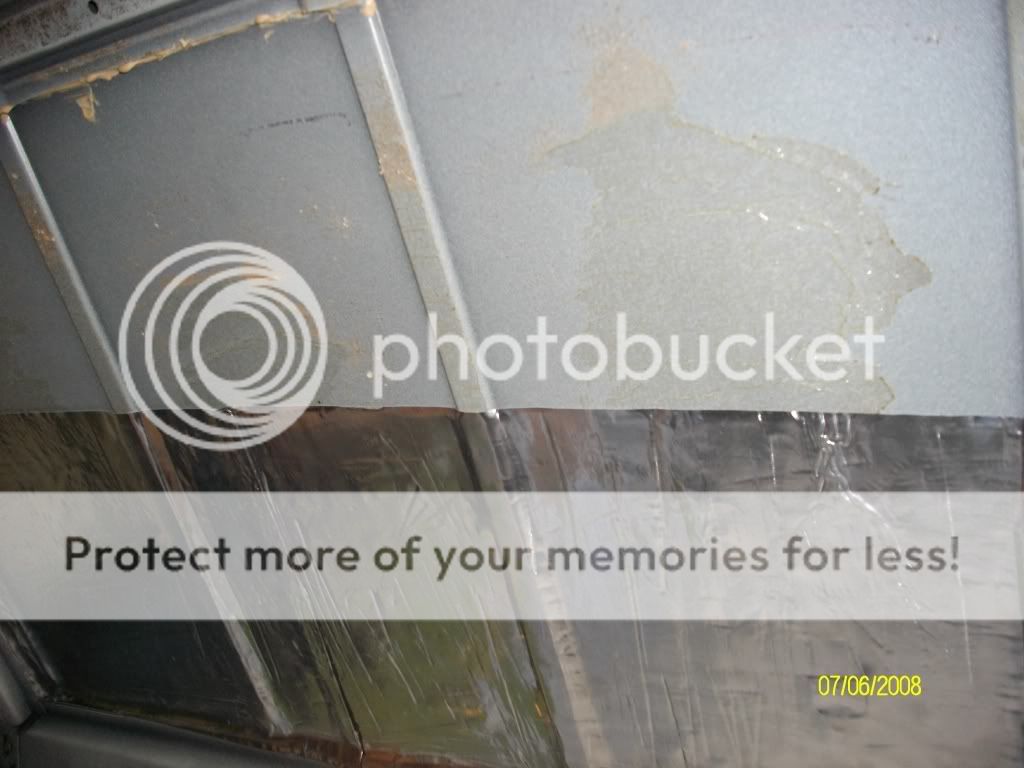

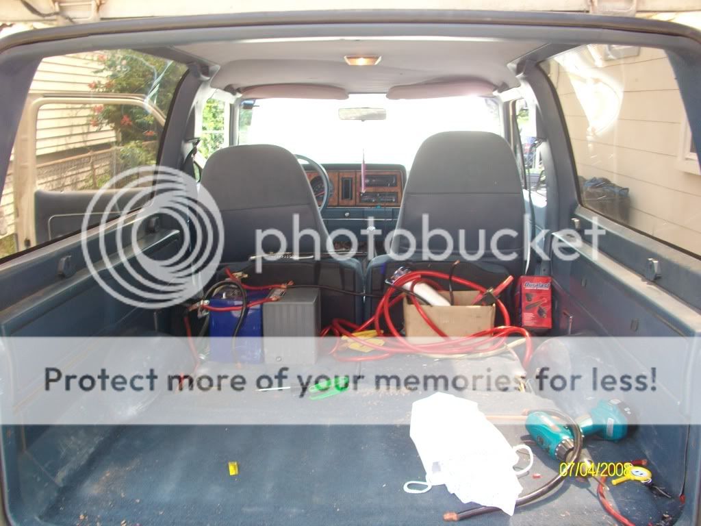

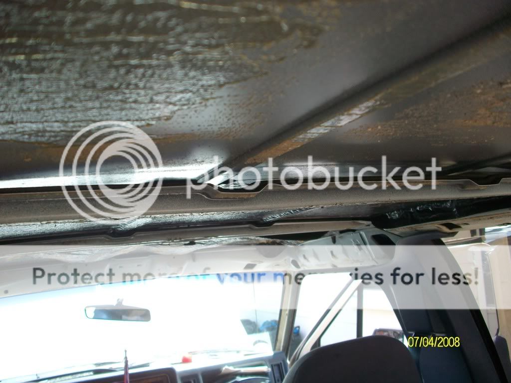

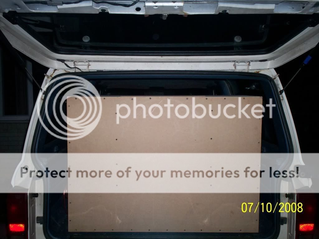

Box gone.
Headliner Gone.

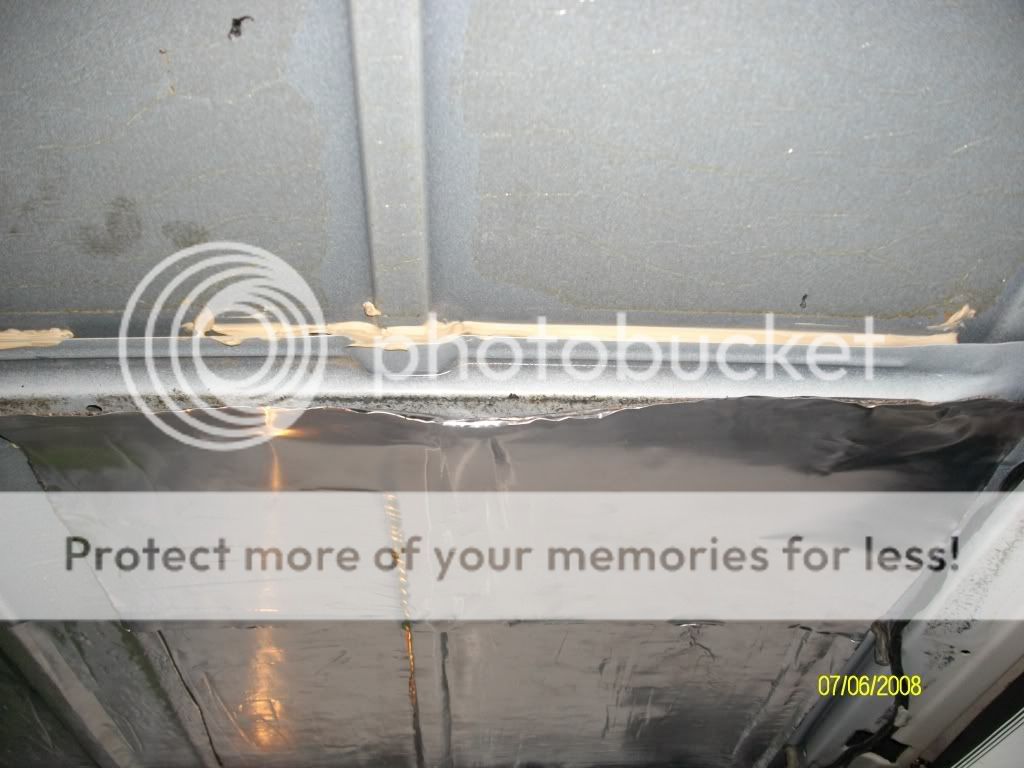

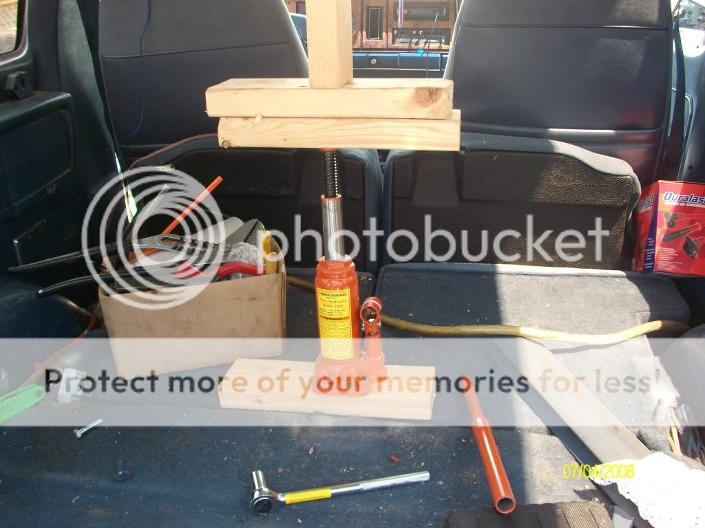

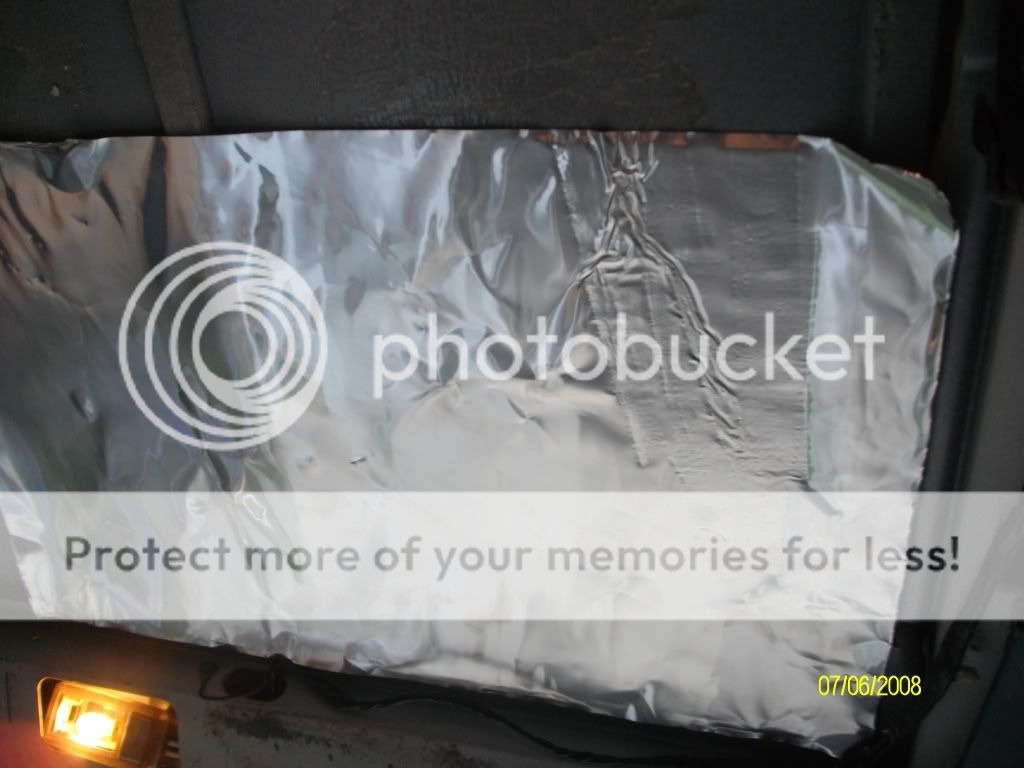

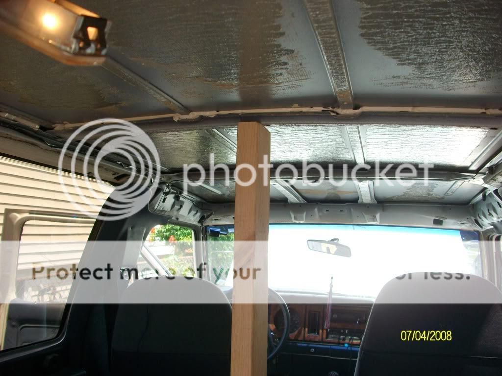

Peeled the insulation and what's this, oh the roof brace separated from the roof.
Nothing a little of this won't fix.

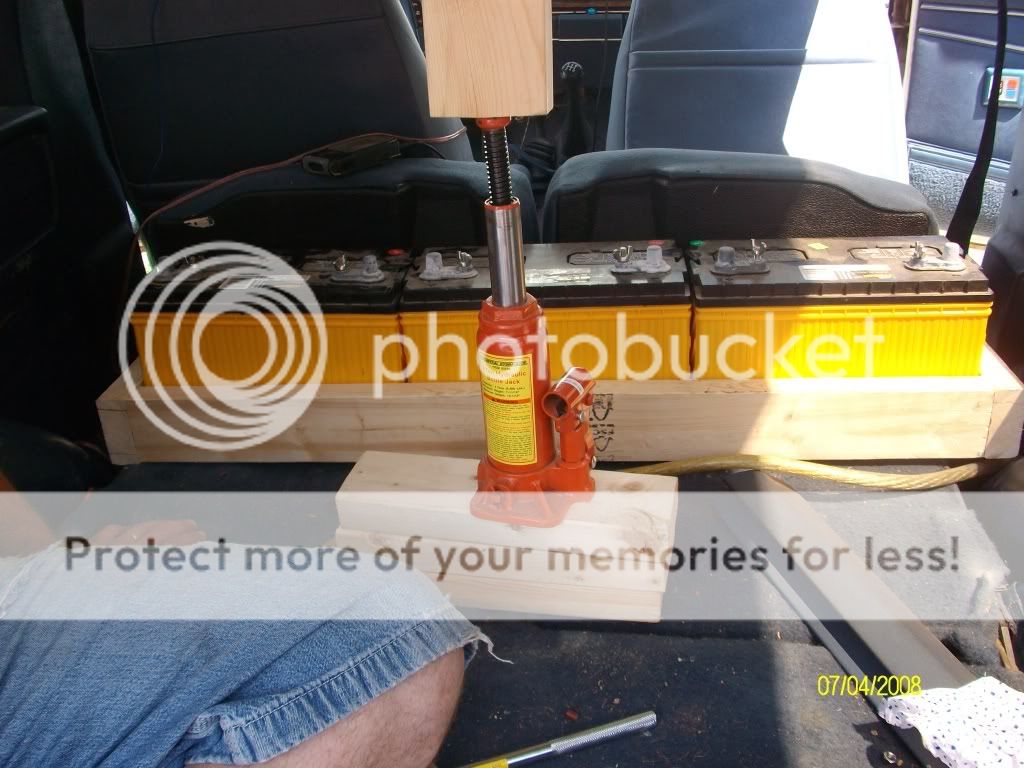

The spreaders we had were too big, time to improvise.

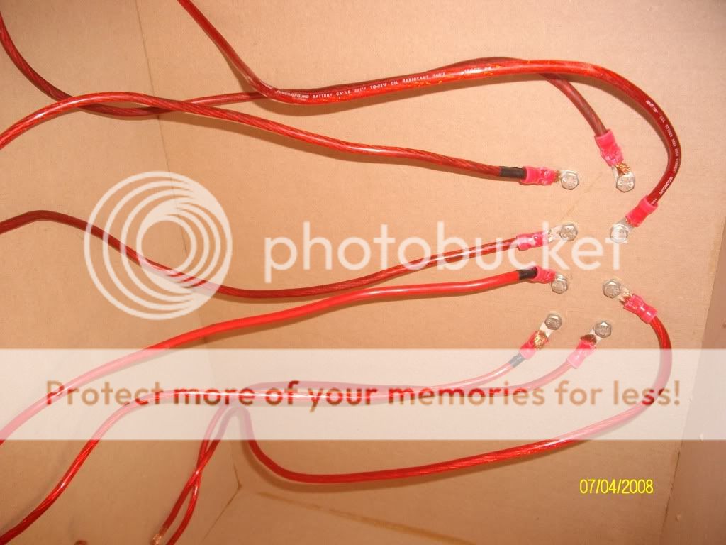

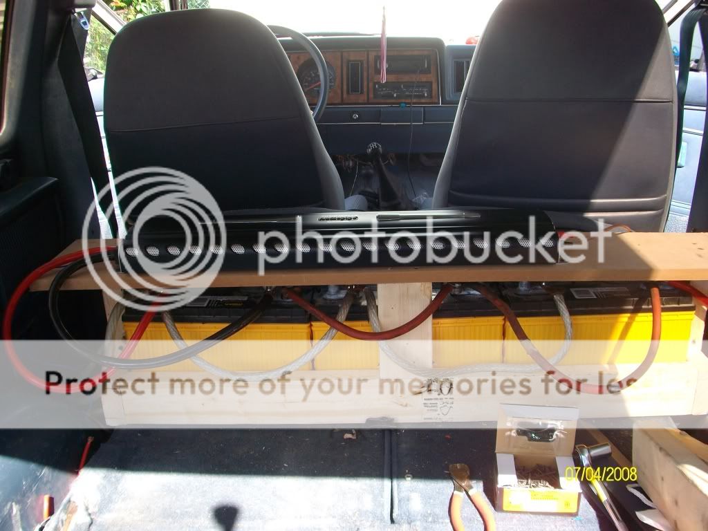

Internal wiring Done.
Piece of 1x1 for baffle bracing.

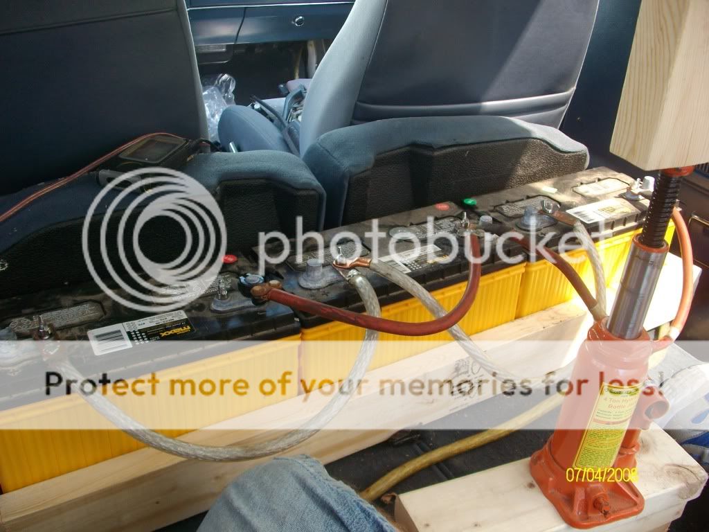

Battery Rack with 3 Wal-Mart specials.
Doubles as an amp rack.

You know you really shouldn't have those 3 batteries inside the truck right? They do off gas, and the vapors are harmful and explosive.
