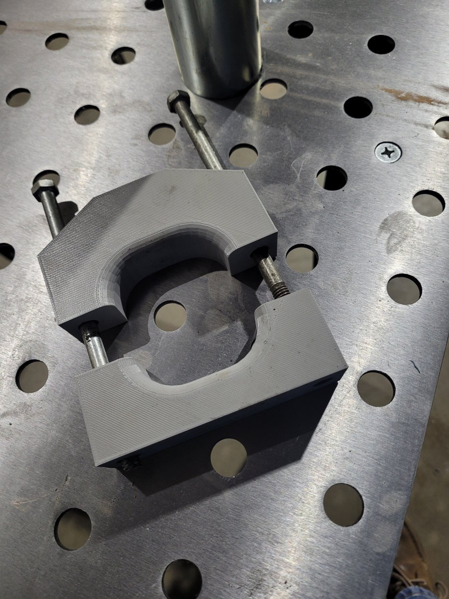

I'm going to need to make some sort of header for this sucker and I already told you I have flanges.
Why Ford chose oval ports is beyond me. It makes it difficult to make headers. So what's a guy to do? You bust out the 3d printer and make a die that's what.
I drew this up in AutoCAD and printed it with 100% infill. It took 19 hours to print. Haha.

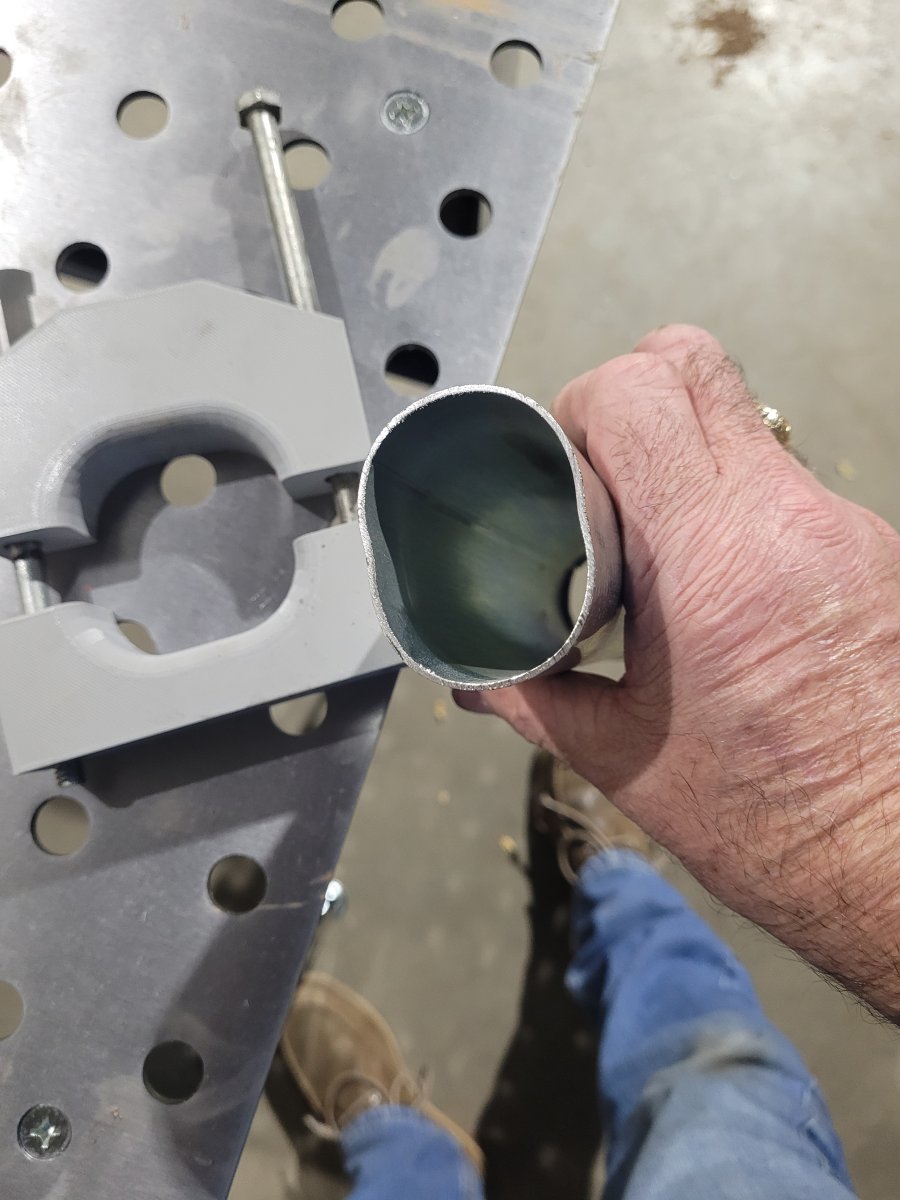

I took a piece of 2" pipe, poked it in the hydraulic press and squished it into an oval. A darn good oval I might add. The die didn't even flinch.

using a 1mm nozzle will speed up that print time a lot

Not owning a 3d printer, I would make that from MDF or if I can find some, high density fiberboard.

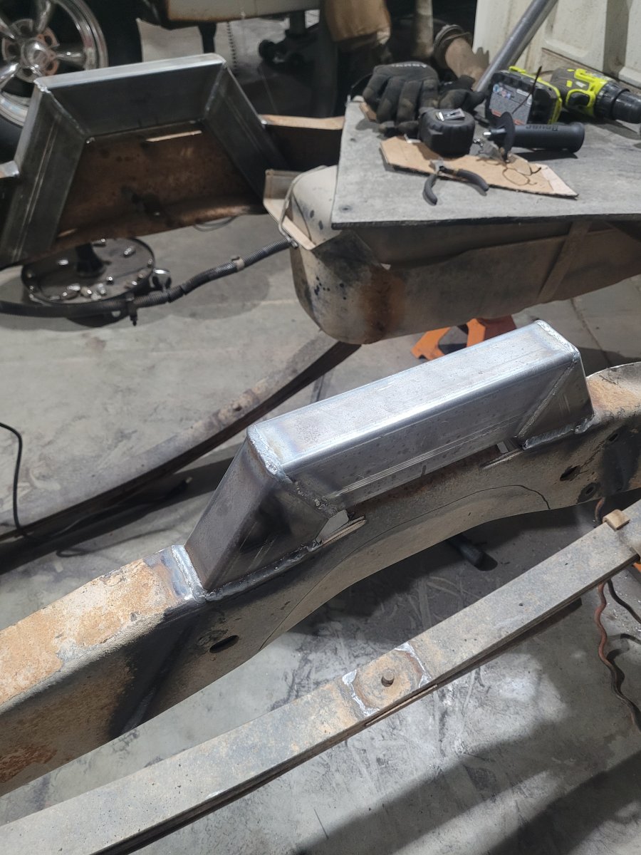

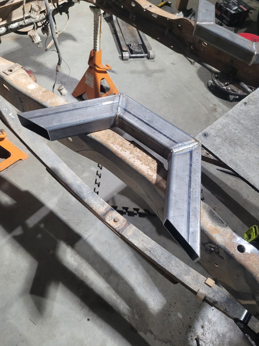

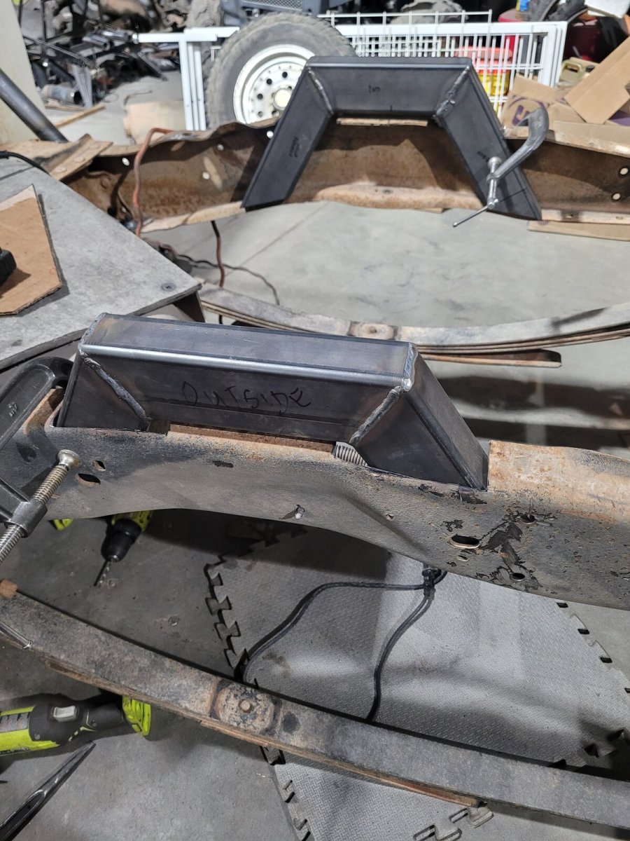

Since I am waiting on parts, I decided to go ahead and build the notches.

At least the notches turned out nice. These will bridge the weirdo depressed area in the frame.
