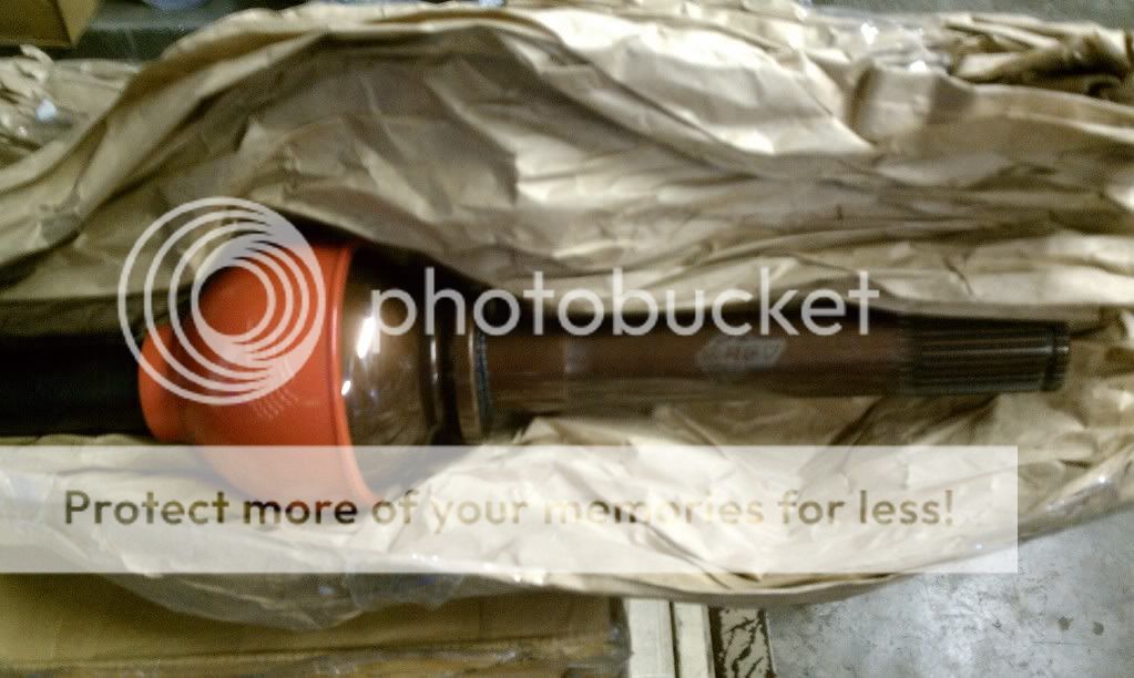

RCV axleshafts

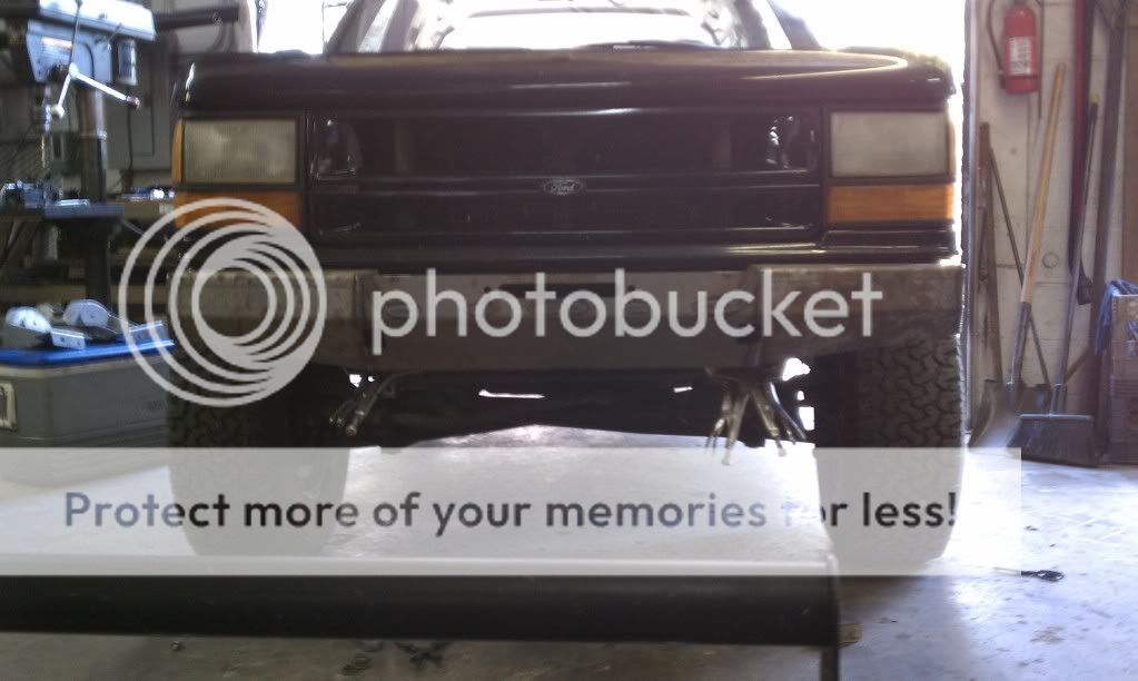

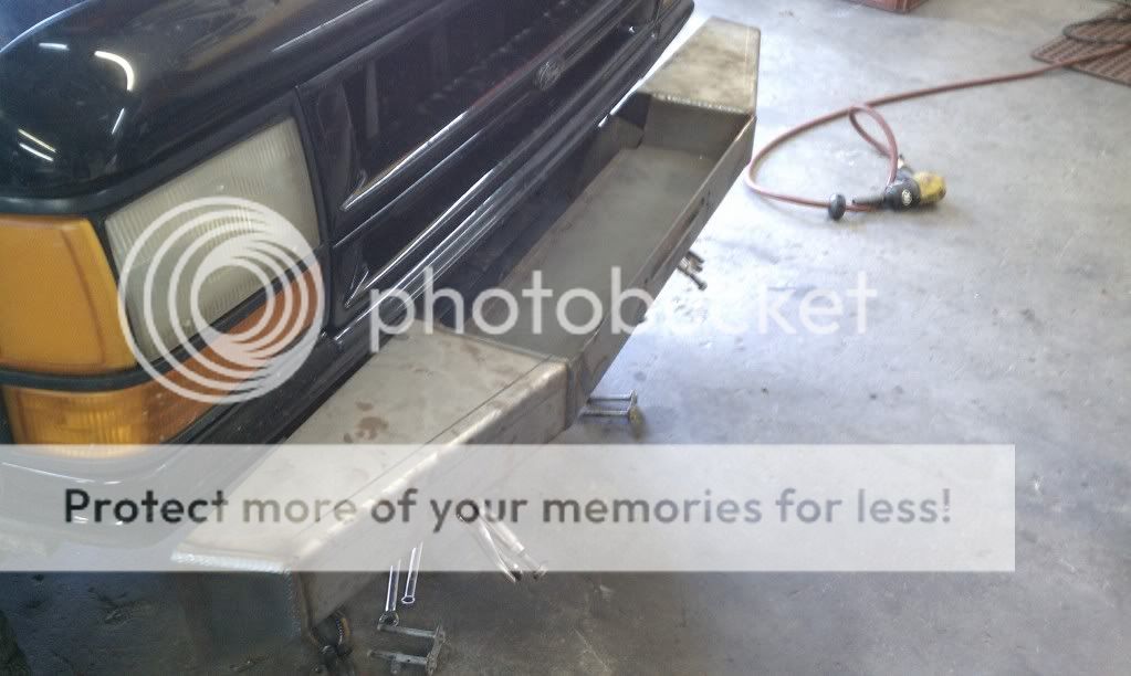

Progress pics. for today. I had some free time so I drug out the old winch bumper I had tacked together. Done some tweaking on it and made some frame mounts. Will have it finished up tomorrow.
Had to borrow a Ex to test fit cuz I was in my Jeep.
ThatGuy in that Explorer
Nice recess for the winch to sit low.
Overall, a good fit. Clean lines and low profile. All 3/16 or 1/4 plate. Sandwich, double shear type frame mounts.
